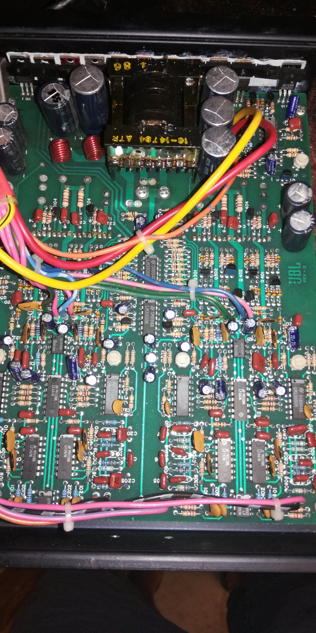

DC Voltage at inputs:
Front module:
pins 1 to 7: 0.03v
pins 10 to 16: 0.76v
Rear module:
pins 1 to 7: 0.7v
pins 10 to 16: 0.78v

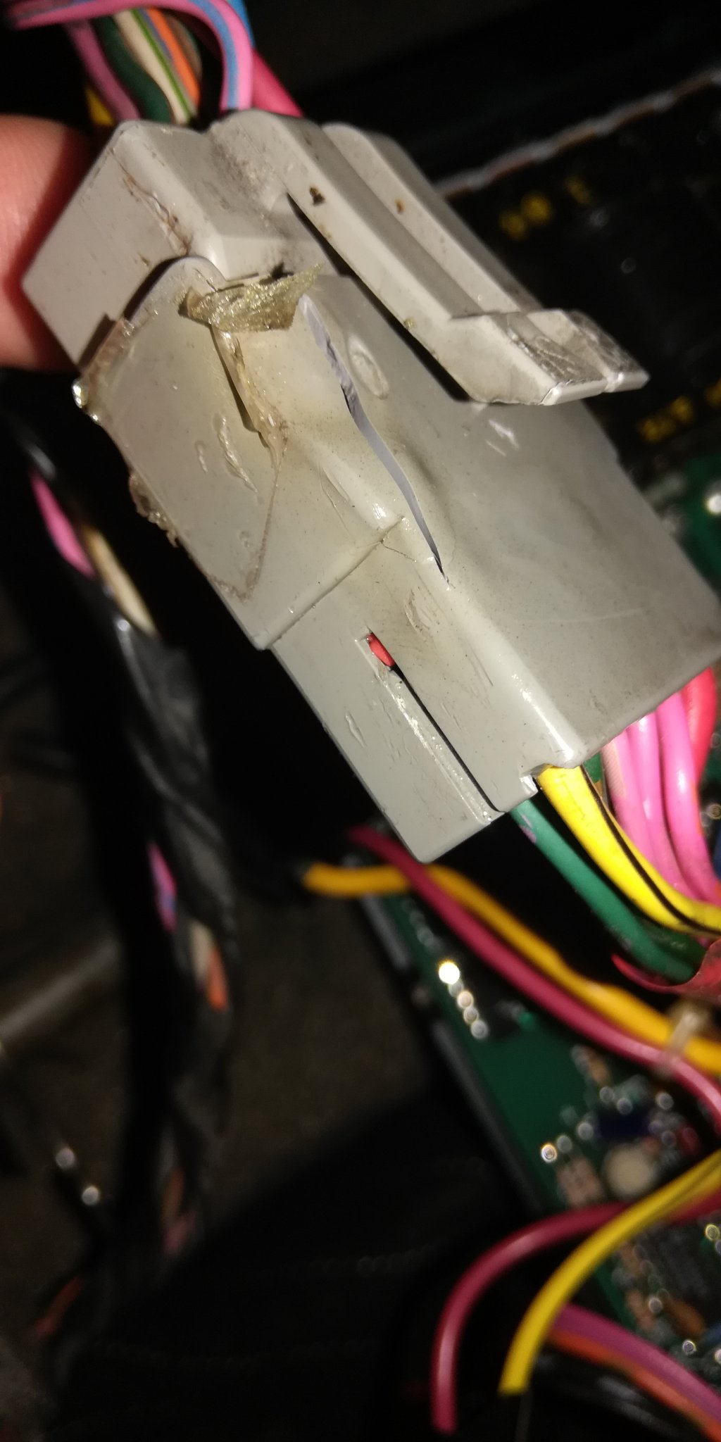

Idle current: My cheap multi-meter has very thin leads so I don't dare try it. The Yellow/black wire in the photo is the power input and it is very hot all the time at the connector and is the reason the connector has partly melted.
I cannot be sure both modules are heating up as the cooling fins run across both of them. It could just be the front module.

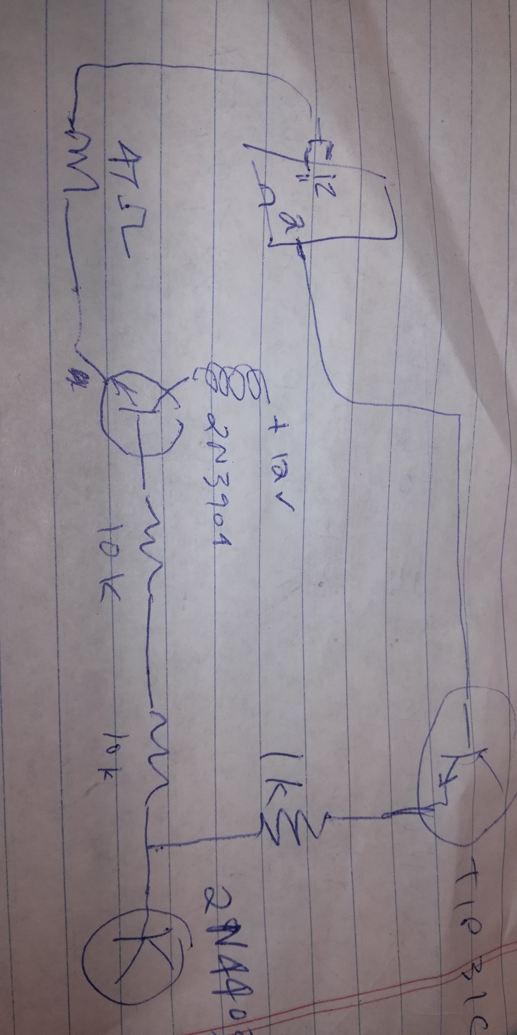

No solder bridges. I just checked using the ohm meter pin to pin just in case my eyes missed something.
Pin 1: 2.4K resistor which connects to ground.
Pin 2: Connects to pin 15 and the collector of a TIP 31C NPN power transistor, (In the diagram above I mistakenly had it connected to the base)
