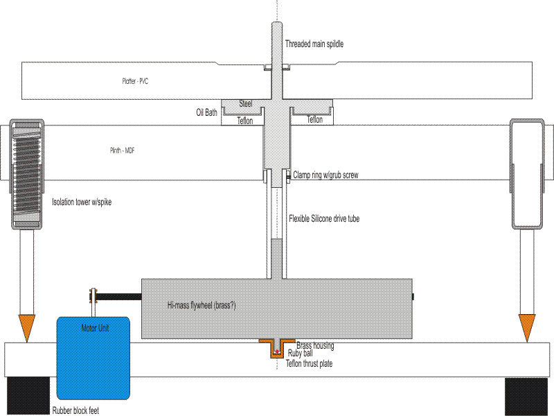

Hi all.
I just finished reading almost all of the monster DIY turntable thread, which seems to have ground to a halt last September. Some really great ideas: air bearings, magnetic bearings, floating the platter on oil... great stuff.
Each approach has its problems: Air bearings need top-flite precision and a compressor (or pressurized air source), magnetic bearings need suitable magnets and have all kinds of magnetic field issues, floating on oil could be messy and the difficulty of keeping the platter centered while applying a driving force remains to be solved.
I have been thinking about this problem tho - what we need is an approach that is 1) simple 2) plays LPs well and 3) is buildable.
Also, on looking at the various designs currently in use, it appears that we have become collectively fixated on the idea tha we have to apply the rotational force directly to the platter. Most of the inherent limitations in turntables comes from this basic design feature.
Whenever I have to solve a problem, I tend to look around to see if humans have already solved it. Looking back, it did not appear that any device simmilar to a hifi turntable had been needed or used in human history - until I noticed the Potter's Wheel.
This device uses a very coarse motive force (the potter's feet) and translates it into a very fine rotational machine, capable of amazing precision - and, it is very simple.
This approach has some really attractive features:
1) the rotational force is applied to a flywheel which can be decoupled from the platter in all sorts of ways while maintaining precise speed control
2) any vibrations derived from drive mechanism (motor) can be isolated from the LP/platter interface.
3) the mass of the platter can be configured to best suit the dynamics of playing LPs, not rotating them.
I have attached a first kick at the idea of designing a TT on the principals of a potter's wheel. I'm sure many of you could come up with a better interpretation.
I will look forward to comments on this idea - hope it rings a bell with some of you like it has with me.

Too many links in the (drive) chain and alot of bearings IMO.
The subplatter could be driven directly somehow thus loseing the rubber belt from the motor.
The silicone tube....again a possible source of speed variations in the main platter due to stylus drag?
I think there could be mileage in the idea. Heavy subplatter for speed stability driving a light main platter for low energy storage/dispersion.
Paul.
Paul.
Yep, thats the essence of the idea.
There are only two bearings in the design as it is. The one supporting the flywheel and the one supporting the platter. However, you may have a point. The concentric bearing for the platter is the least developed part of the concept at this point. Im hoping that some of thr mrchanical wizards out there will come in and help figure it out
Any and all suggestions welcome...
Lets see what develops
Jess

JesseG said:Hi all.
How can one maintain precise speed control with decoupling? Paul is right, the flexure of the tube you suggest will inherently allow speed fluctuations.

I would have to assume that the belt is not a stiff connection between the flywheel and the platter, same problem as the flexible tube.

Hi Jesse and others,
Looks a bit as the Transrotor magnetic drive. In stead of the silicone tube spring they use a magnetic spring as coupler. But such an extra mass and spring introduce an extra mass-spring system with an extra resonance to cope with.
All those mass-spring things are exited by the varying drag of the groove modulation. IMHO a heavy platter which is simply loosely belt driven by a steady running motor still appears to me as the most optimum compromise.
The air coupled flywheel looks very interesting. But I don’t think this will give the platter a very high effective mass. It is simply de mass of the platter (-> moment of inertia) driven by the torque as a result of the drag of the coupling air between platter and flywheel.

For the first design mentioned in this topic I would like to point at the risk of torsion resonance. Kind of overshoot- effect: the response after a sudden increase in stylus drag.
Can be compaired to the main drawback of a bass- reflex speaker.

Very ineresting comments from all.
Thanks for this, Anders. Shows me that soemone else has seen enough merit in the idea to build one.
Yes, I can see the possibility of getting some effect from that. I expect that some experimentation could identify a suitable drive coupling material.
I just really want to find a way to get away from applying the rotational force directly to the platter, thus avoiding all of the latteral force complications that derive from that one engineering compromise.

Okay,
How about a motor that revolves at 33.3 RPM attached directly to the flexible drive shaft-tube thing. No lateral load and no coupled flywheel transient issues.
I suppose one could mock this up with a DIY platter hovering over a direct drive table with a piece of tubing wedged over the spindle and attached to the underside of the DIY platter.
Or, how about a belt riding around the motor and two idler pulleys forming an equalateral triangle around the platter. No lateral load on the platter, and it has been done before. Just don't use three motors.
Max
Now that is a good idea! Easy to build and test as you say using an existing DD table - which we all know are good for nothing else
I'm going to build this. I'll let you all know how it turns out.
