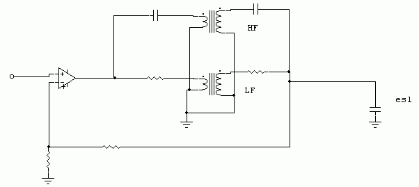

Hi ec8010 cat,
Actually, I have been experimenting with this idea a while ago, I wound a 1:6 transformer and built an amp around it using two IR mosfets, the whole thing running from a 500V rail (= 2000Vpp prim, 12000Vpp sec).
It was designed for a bandwidth of 100-20000hz. It works, but it doesn't help at al solving the common esl-transformer problems so I don't see the advantages over a normal off-the-shell amp driving a 1:100. So why go through the troubles of a 500V amp..
Additional problem I ran into is that you'll need to drive the transformer from a very low source impedance to maintain high freq response. This kind of output stage proved not very good at that, although I managed to solve it to satisfaction using lots of local feedback.
As an alternative I've been thinking about using two seperate transformers, splitting up the spectrum. One for 20-500, the other for 500-20000hz for instance.
Since I am not aiming for seperate bass/treble panels I want to add the outputs of the two transfo's and probably use some feedback to smoothen out the phase / amplitude errors created in the splitting/adding process. Basic idea as in picture. Problem is to maintain stability in the feedback loop.
Fully agree on that, and don't forget the additional isolation (read: safety) the transformer provides and which is very welcome is such designs.EC8010 said:The big advantage of the low step-up ratio output transformer approach is that it avoids the problem of complementary devices and allows you to have true push-pull with identical devices (whether they be valves, MOSFETs, or whatever). The second advantage of using an output transformer is that it allows you to swing to twice rail voltage, and that increases your efficiency.

I am talking about a large wire-stator esl with electrical segmentation.
In fact the dual transformer idea is nothing new, acoustat has done it. They called it a magne-kinetic interface 😀
Read this interesting article about it:
http://www.izzy-wizzy.com/audio/acoustat.pdf
