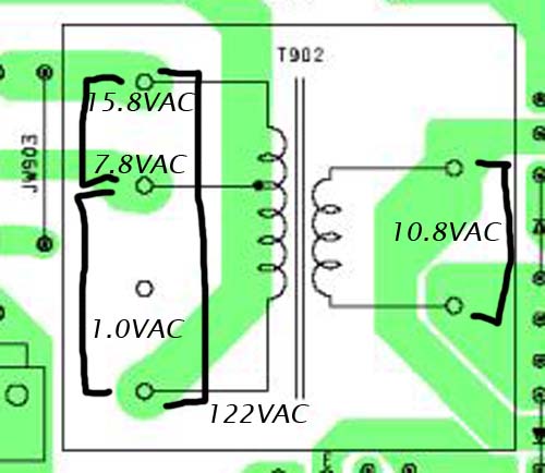

Ok.... so I have a Sony receiver. That's the problem right?😀 STR-DE595. Anyway, I purchased it in order to repair and resell, but the problem seems more complicated than anticipated. It won't turn on at all... no protector mode, etc. The power supply fuse isn't blown, all transistors seem good, transformer is putting out voltages that seem correct (when I manually turn on the AC supply relay). So, I plug it in, and press the power button... nothing. I've tried looking at a bunch of different things, and nothing apparent seems wrong. I'm considering removing all of the relays and testing them individually, but my impression is that relays typically don't go bad. Anyway, any help on what could be the problem or what else I should check would be really helpful. Thanks.

OK... I found a service manual and have done some testing. Capacitors I've tested so far have been good. But I tested the standby transformer and here's what I found:
2 pole side: 11ohms between poles
3 pole side:
between 1,3: 900ohm
between 1,2: open
between 2,3: open
Take a look at the diagram. Pole 1 is the bottom, 2 is middle, 3 is top. Thanks.

Okay,
The standby transformer is not the problem. I'm still betting on the AC detect circuit. Look for a diode feeding a small value cap on the order of 1uF. Measure the AC voltage on the diode, then the DC voltage on the other side. Try measuring the AC voltage across this cap as well. A high AC reading = bad cap.

I tested all of the specified components without power using capacitance meter, ohmmeter and diode test. I'll try testing them with power if these results don't show anything. Anyway, everything seemed OK except for Q901. Between two poles the foward voltage was about .045V causing my meter to produce continuous tone. This was between the middle point and bottom of Q901 if you look on the original pcb layout I posted. Not quite sure if that means it's bad, but my understanding is that it shouldn't do that. I'll keep looking if that's not it.
Ok... I removed the transistor, and it's still giving a very low forward voltage and making my multimeter beep on diode check. I ordered a replacement and should know on Monday if this fixes the problem. I shall report back.
Hi rkc7,
That means that Q901 had a collector - base short (or high leakage). This would tend to make it impossible to turn the relay off. The unit should therefore remain on all all times. If the outside pins on Q901 where shorted, then the unit would not turn on.

You're right... turns out I mixed up the pin position. The short is actually between the top pin and middle, not the bottom. It's the pin marked with "E" on the pcb layout, which I'm guessing stands for emitter. That seems to solve the mystery. But, my next question is would anything else likely be bad as well? I know that with other blown transistors that there's often other things that went wrong as well. I'll check over the board to try to find anything else, but I'm hoping that it was just a bad transistor.
