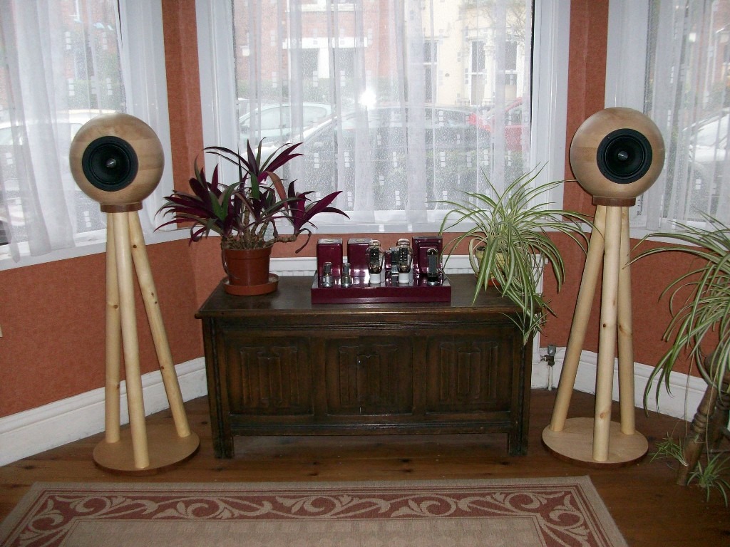

I've still got mine and fwiw I don't think standing waves will be a problem, they certainly aren't in mine.

These are Ikea bowls, about 280mm diameter, 9.2 ltrs.
Mine are about 12 years old but I beleive ikea still make them.
