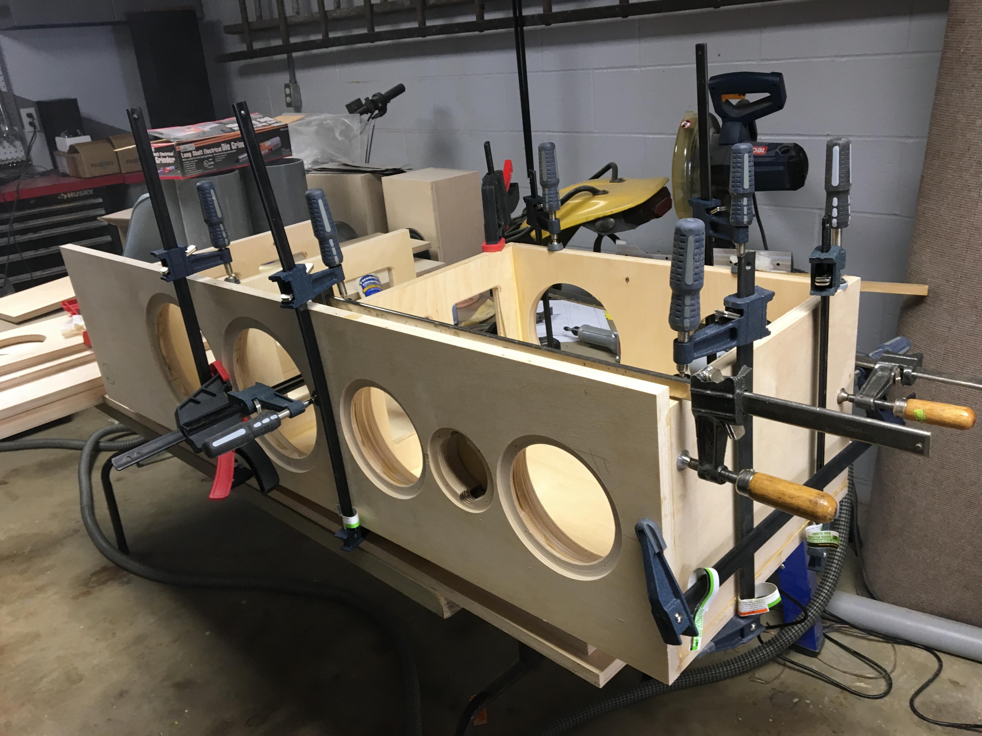

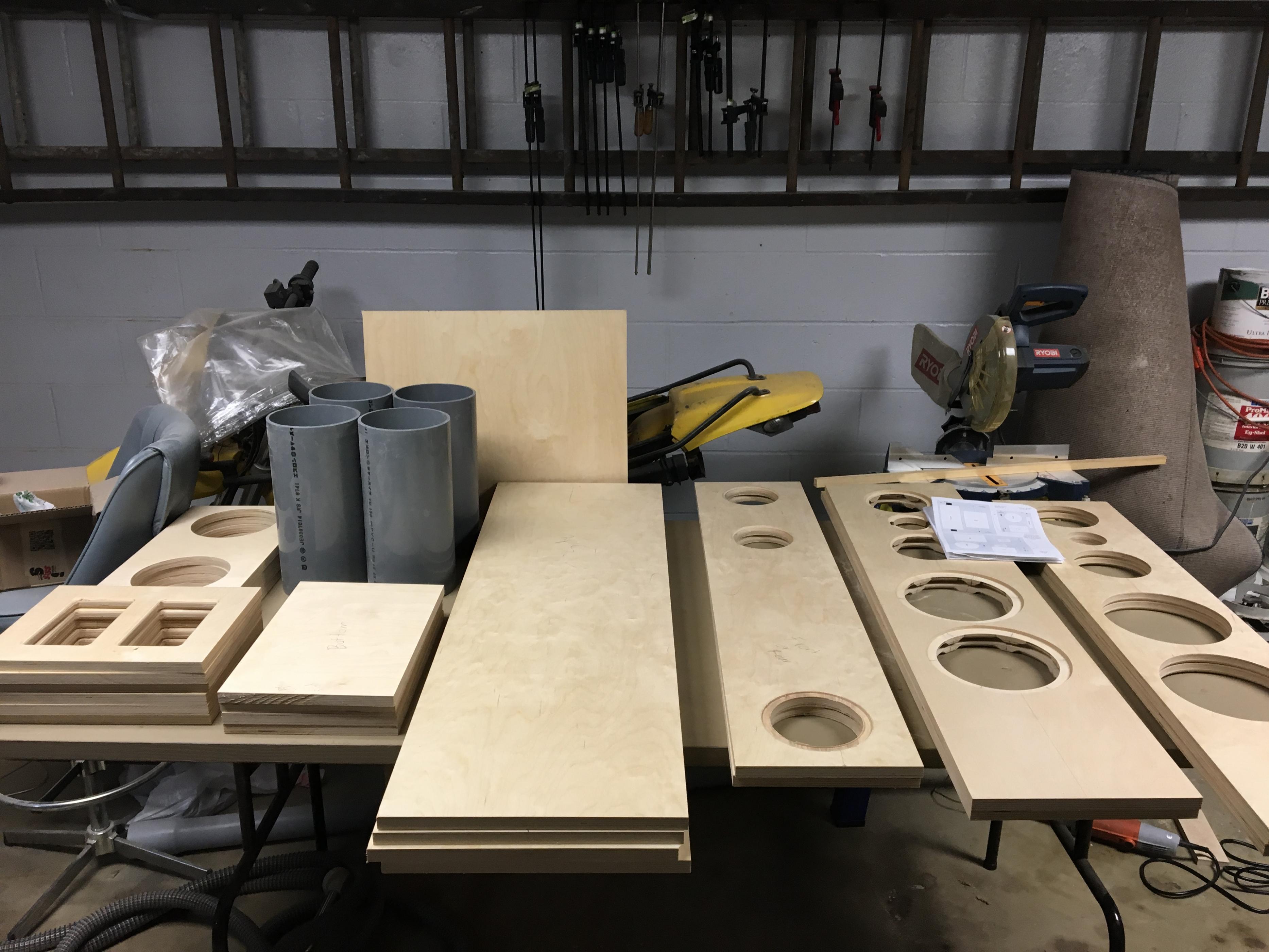

The build
I decided to use Baltic birch for this build, mostly because I hate working with MDF, but also think it sounds better. Three 5x5 sheets were more than enough. I ripped everything a little wide, then came back and made size when I could control the boards better. A Jasper Jig made quick work of all the holes. I routed them almost through, then used a drill bit in a Dremel to finish cutting them out by hand. Worked very well, the drill followed the hole without gouging and I did not have to screw the centers down to another board.

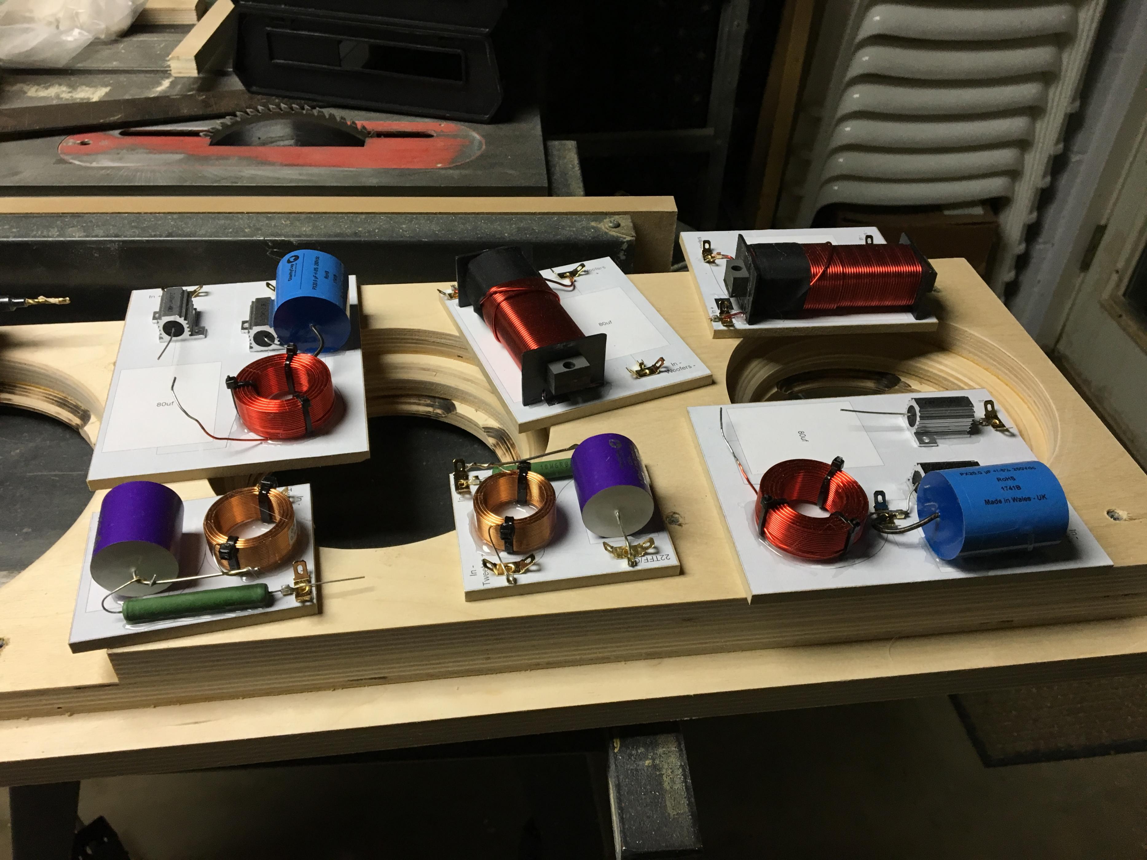

Build, continued
This was one of the more complicated builds I've done so far. It pays to really think it through before starting and have the whole plan worked out before you start. I had bought the complete kit from Meniscus and it was a joy having all of the parts needed. The guys at Meniscus were great once I found the email address on their site. Got no response using the web form, so it may not be working. Some of my parts were back ordered but everything came before it was needed. I splurged for the upgraded Clarity caps but built the crossovers myself. Had plenty of time to build them while glue was drying.

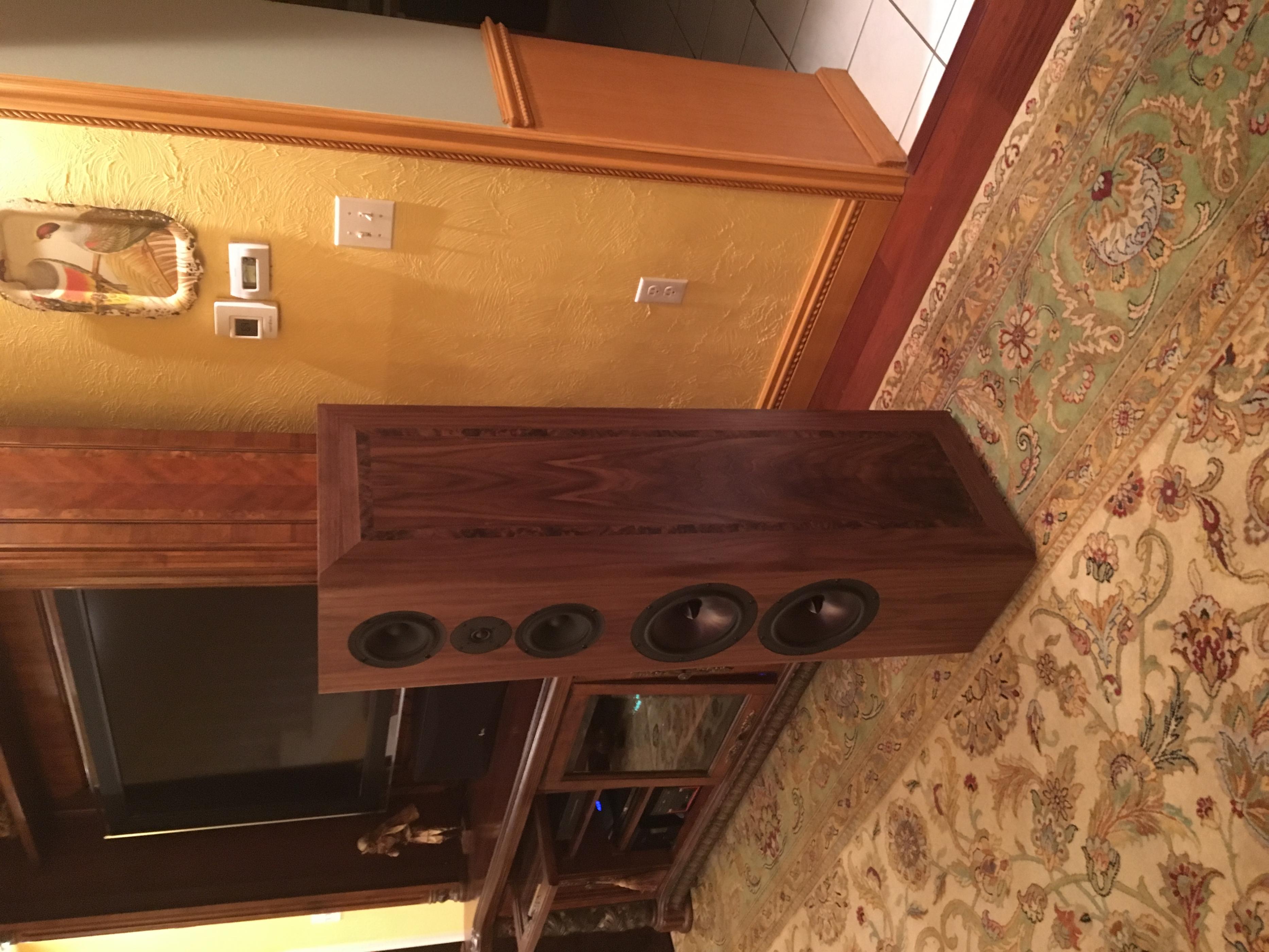

Finishing
The original plan was to buy a sheet of paperback walnut and wrap both speakers in it and be done. However, when I got my veneer, one end was beautifully figured and the other, not so much. Now, you can't have two speakers that don't match so I considered buying another sheet of veneer. In the end, this is what I came up with, I'm pretty happy with it. I used the nicely figured walnut to make panels for the sides, bordered by a burl walnut strip, then a straight walnut "frame". The whole process was done using Titebond glue with the iron on method.
Done

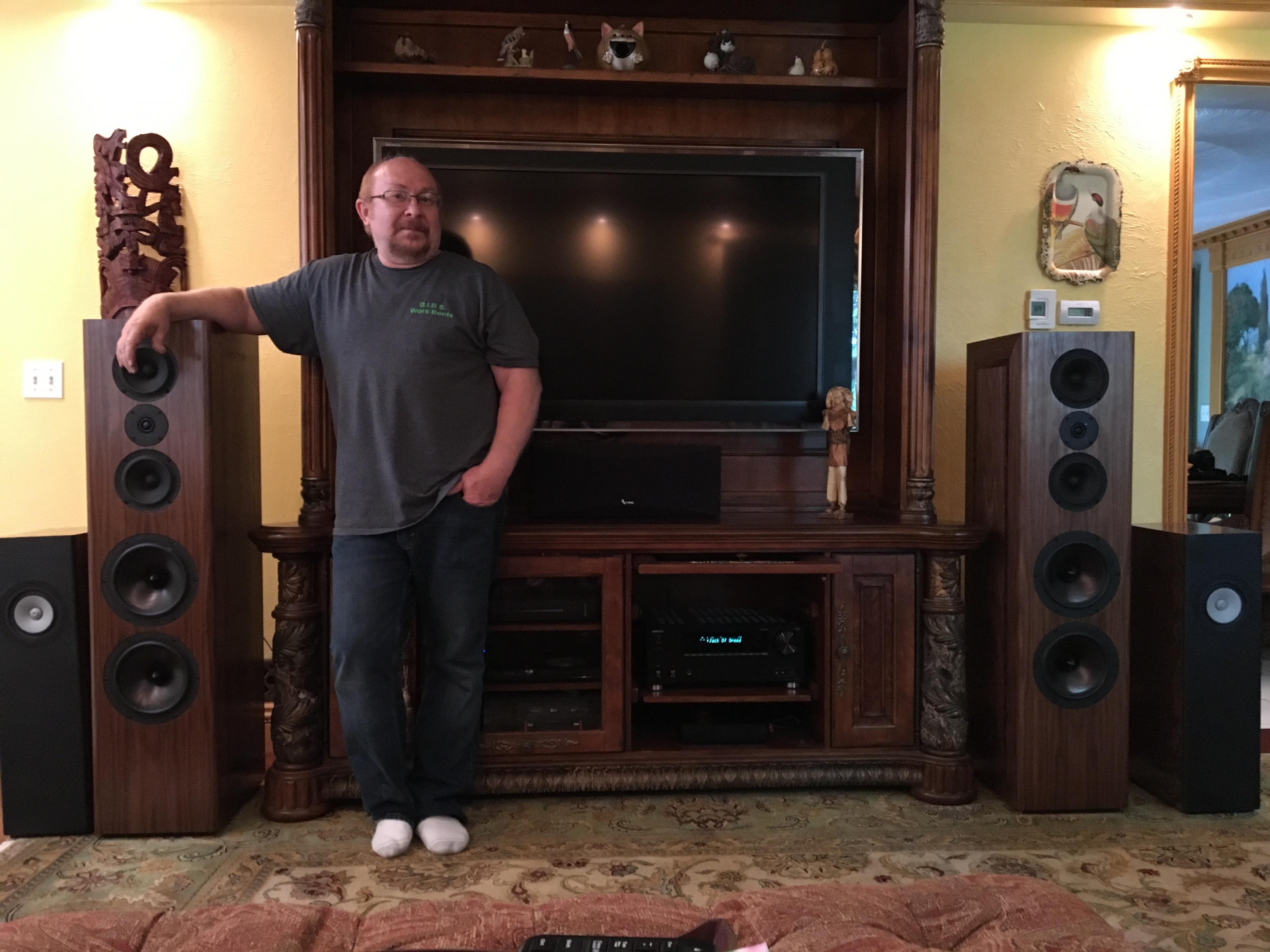

Here are a few shots of them in my living room. I used a tung oil finish and still need to let them cure for a few weeks, then a final scuff down and wax. A big thanks to Jim and Curt for a great design.

Very nice! Beautiful cabinetry!
I quick thought about placement. I think what you are hearing with changes in mid tunnel foam are directly related to the entertainment center. Ideally, the TV is wall mounted with an entertainment center that is lower between the speakers, but I'm guessing that isn't negotiable with the significant other. 😉 So, one of these days when she's out shopping, pull the Anthology's out so the rear of the speaker is about 2' in front of the TV portion of the entertainment and see how they sound on some of your best recordings. That should give you a baseline of what they're capable of.
Again, beautiful work! Enjoy!

Tim, I didn’t know how much the Anthologies weighed other than “a lot”, so I brought out the bathroom scales and got 94 lbs. each. MDF would end up at about 110-115 lbs. These were built from 13 ply, void free Baltic Birch apparently from Europe because of the 1.5x1.5 meter size. You may save 5 lbs by using Big Box Store Birch but I would hesitate on a speaker of this caliber. I’ve built several quick and cheap speakers out of it and find that it is not near as stiff nor as straight as the real deal. It will be 7 ply, 5 plies of junk wood and two paper thin plies of birch. The paper thin plies also seem to separate easily and that is what you will be gluing to. Any curvature in your plywood will make a difficult build impossible. That and when you run a screw in for a speaker and find a big void it’s a bit disappointing. With all the time and effort and money that went into these, I would hate to compromise for a 5 lb. saving. Money wise, you would need two 4x8 sheets from the BBS at about $53/sheet vs three 5x5 Baltic for $55/sheet. About 5% of the entire speaker cost extra.
Veneering done, time to sand and finish. There were small gaps at the joints of the inlay. I used some 220 sandpaper wetted with tung oil finish to create a slurry of sand dust and tung oil that I worked into the gaps, then wiped off the excess. After that dried, just finished as usual with tung oil
