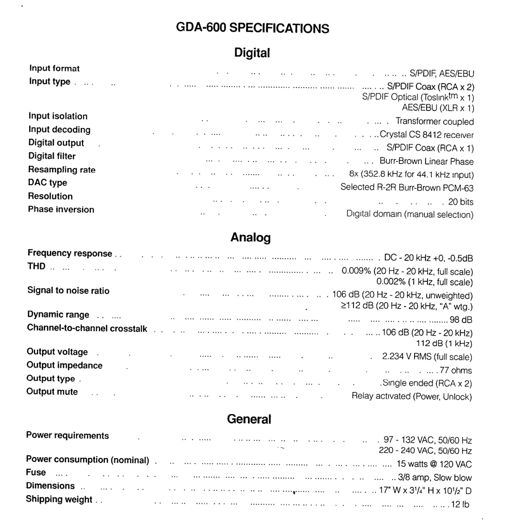

There's another issue to consider - the PCM63's output impedance is surprisingly low for what's ostensibly a current output, it really needs a much lower impedance on its output (I'd suggest <5R myself). You didn't say whether your Vishays were put in series or parallel but assuming the latter it looks like you may have about 50ohm in practice.

This part is confusing. The PCM63 datasheet shows output impedance as 670Ω. What I have right now with 1:10 is 9.09kΩ/(10x10)=90Ω, so with all losses it around 100Ω reflected load. The 5Ω will ask for 5x10x10=some 500Ω, which would suck lots of signal. If indeed to use 5Ω as a source impedance then we could easily make a high quality transformer of some 1:30, or even 1:40 ratio with still good low end response and quite low secondary copper resistance to compensate for signal loading.
In any case, at home the lowest resistor I could find was 2.65kΩ VishayDale, so to check if it makes any difference I put it in parallel with existing 9.09kΩ for some 25Ω load and indeed, things greatly improved. Will check at work for smaller values and check it tonight.

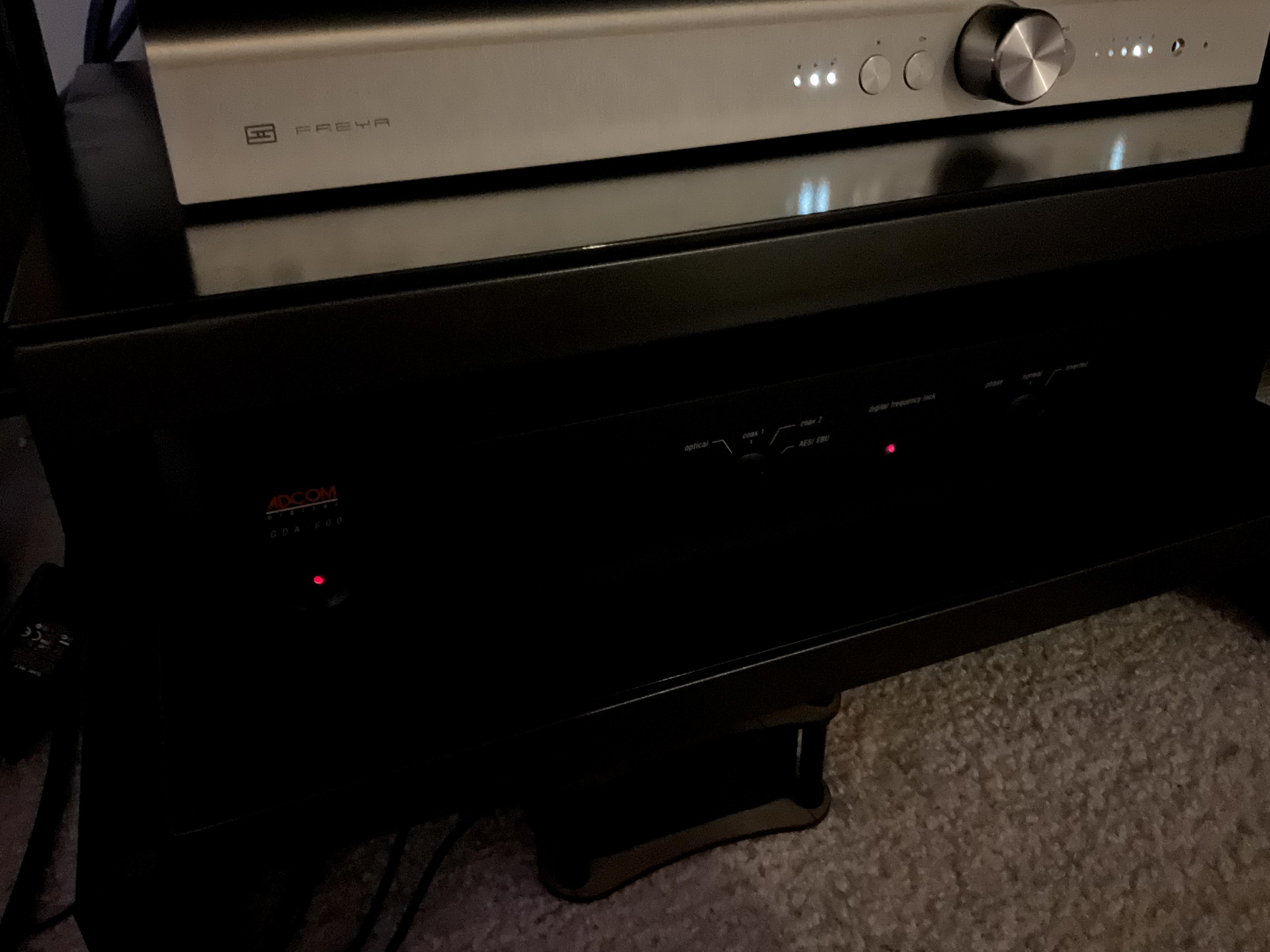

Anyone like it stock (with excellent transport)? I think it has a fun raw sound & wide open. Personally would not want to mod*, interesting R-2R BurrBrown PCM63 history at this point haha; and what a robust built piece, timeless.

My GDA600 config: DIR9001, DF1704, Japan BB PCM63 K, currently I use LM4562HA, most of the capacitors changed for better quality .., I got all items in stock to build a single-ended version of the Pass Labs D1 I/V stage .., i somehow really like the presentation from this DAC and I believe the Pass mod is the last mod with benefits, and by that will give me even more joy!
Ps. found it for $40 in a thrift store
