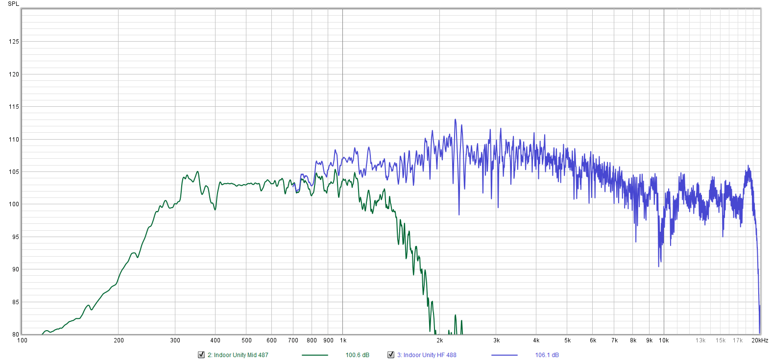

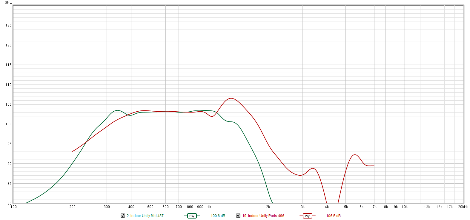

I have been printing another large MEH. Finally got it finished and vaguely measured. It is 630mm wide and 360mm tall. The horn is 350mm long without the comp
Here are the measurements:
The measurements were taken with the mic at the mouth in a small room as in the image above so they aren't ideal but I will try and get some better measurements soon.

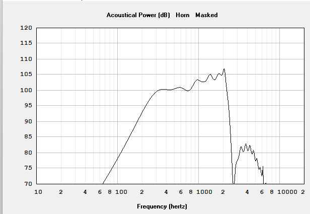

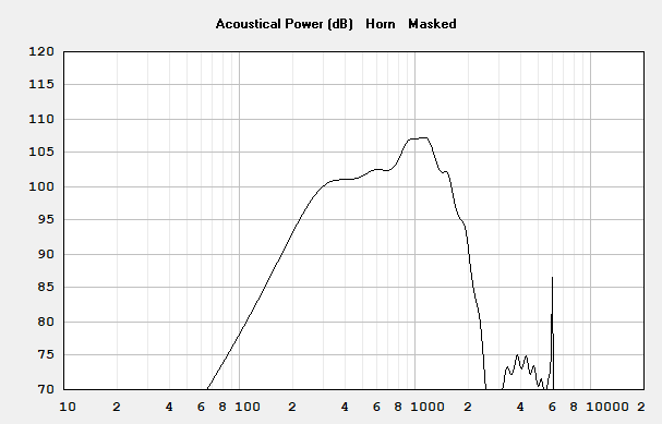

With the sims I had managed to get it up to around 2khz however it drops off rapidly above 1.3khz. I have managed to get smaller drivers up to 2khz before so thinking it is cancellations across the cone?
I might try doing some modelling in Akabak of just the front chamber and taps to see what I end up with.

Wow great project, I’m planning something along these lines too! The 4ndf34 is a little gem.. did you measure them and the compression driver with the same power? And what a nice print, how big is your 3d printer and which material did you print?
What dispersion pattern did you choose? Did you put the drivers top and bottom because of tighter vertical dispersion and therefore closer spacing?

To add another data point, pair of 4NDF34's measured indoors at 1m with some eq on the upper corner. Horn is an 18Sound XT1464.
Post the raw responses, whats with people scared to post raw responses?? These super smoothed FR's are only good for use during crossover design and give no hint of the true nature of the actual response. A raw response that is as smooth as the above does not sound like a response that is only as smooth after applying smoothing to it....Psy smoothing or not. OK so its an indoor measurement, the raw response shows directivity character. At least show a smoothed response and a raw one, my goodness.
I think it's more the comparative size of the driver's chambers- the 2" that made it to 2kHz had much less ATC (area of throat chamber) and the area and depths of the ports responsible for the 1.3K pass roll off.With the sims I had managed to get it up to around 2khz however it drops off rapidly above 1.3khz. I have managed to get smaller drivers up to 2khz before so thinking it is cancellations across the cone?

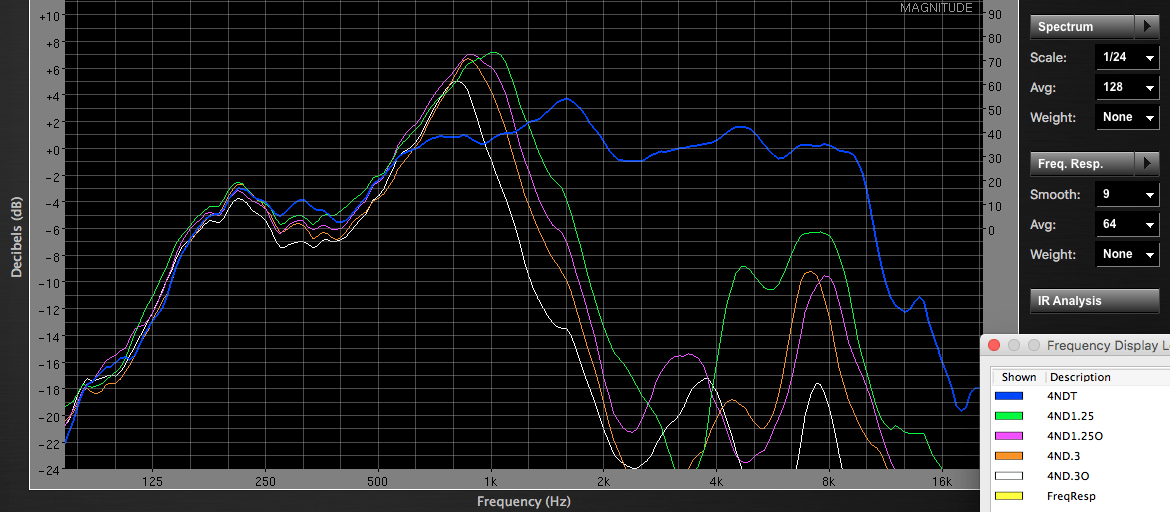

Here are some smoothed (ha ha Camplo) responses showing centered ports on a BC 4NDF34-8 driver compared to moving the ports to the edge of the cone.
The port depth was 1/2", clamped directly to the speaker gasket, no cone filler used:
4NDT BC 4NDF34-8 in 5" cube cabinet on carpeted floor measured at 10” from cone.
4ND1.25 As above with a cover plate with a 1.25” x 1” port (1.25 sq. inch)
4ND1.25O As above, port moved to cone surround edge
4ND.3 1.25” x .25 port (.3125 sq. inch, about equivalent to a 5/8” circle)
4ND.3O As above, port moved to cone surround edge
The smaller ports rolled off ~1/3 octave lower than the larger ports (and reduced low mid output).
Moving the port off center did reduce the acoustic LP frequency slightly.
Moving the port off center reduces the out of band response peaks.
The difference in the port location on the HF driver response may be more important than the port offset..

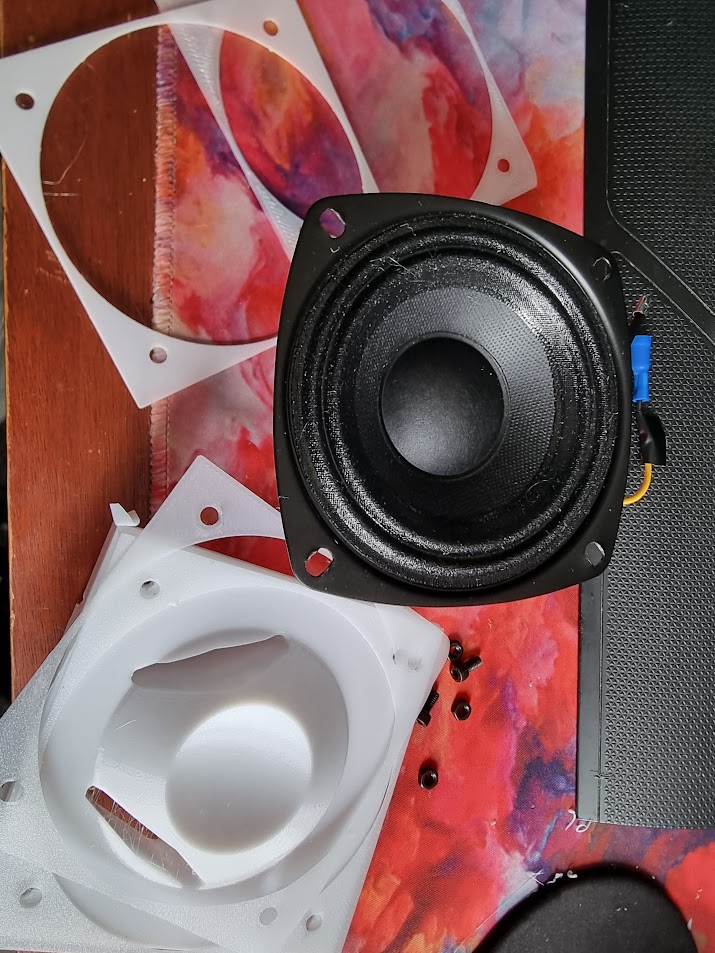

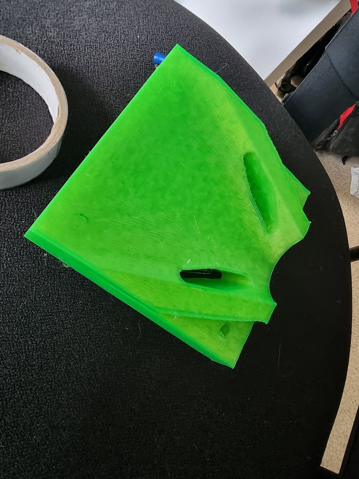

I have done quite small rear chambers and front chambers for this:
The front chamber is 2.5mm from the cone all over
The rear chamber going back into the basket of the driver with a cutout for the cone
@AllenB The CD I have can do 1.6khz but I now kinda just want to design something that can take this driver up to 2khz even though I feel like it will sacrifice some max SPL but I think it should be possible
@zettairyouiki I might release some STL at some point but it isn't too hard to make this sort of thing with ATH and Fusion. Feel free to PM me if you want any help

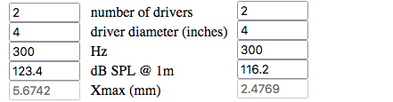

The B&C 4NDF34 has 3.5mm Xmax, and 5.7mm Xvar, with the front chamber just 2.5mm from the cone you will be reducing lower frequency output potential by more than -7dB, and unless you severely peak limit the driver the sound of the cone hammering the plug will be objectionable.
If I recall correctly, the 4NDF34 Xlim is ~7mm.

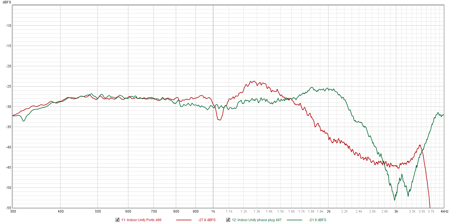

I have tried some more measuring and I think I just need to tune the ports on it to get to 2k, the front chamber seems to be small enough
(I reprinted this to be a bit better)
Ignore everything other than the shape of this, I need to do it SPL and Gain calibrated but I did manage to get it reasonably flat up to 2khz although I'm not sure how this would do in the horn. I'm gonna print and test some more ports, I think I ideally need to get the ports a bit closer to the CD
@weltersys looking at your sim vs measurement you are getting a similar cancellation to me above 1200hz which could be something that Hornresp wouldn't account for? I have been trying to avoid using Akabak for this because it takes so long but it might show some more of what is happening haha
I am currently printing a piece that has 0mm gap between the cone and the filler bit so I can test different thickness gaskets, I will print a few gaskets then measure different combinations.

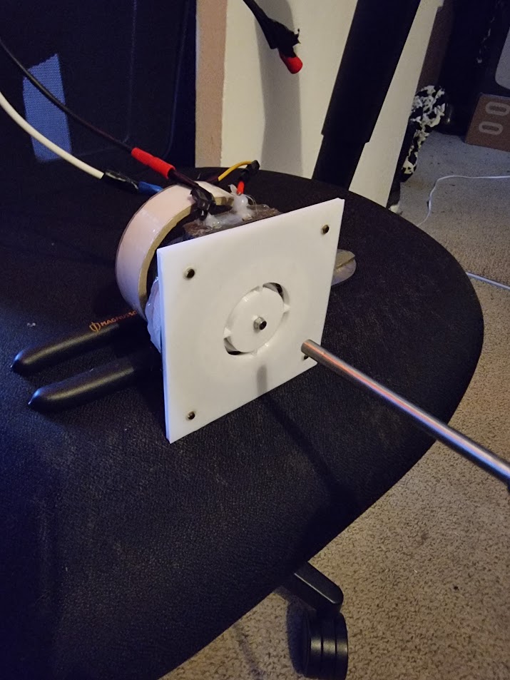

Also a picture of how it was measured haha:

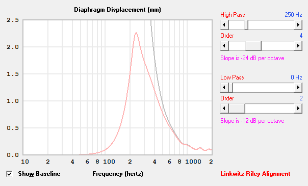

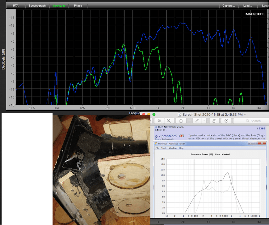

Looks like you may be simming a very small rear chamber which would limit excursion.Nice, from my sims with it in the horn I ran out of power before xmax with a high pass within the band at the low end. A high pass of 350hz limited it to less than 2.5mm xmax.
The average power seldom exceeds 1/8th the peak power for music above ~125Hz.
Hornresp does not account for any non-pistonic attributes of the driver.@weltersys looking at your sim vs measurement you are getting a similar cancellation to me above 1200hz which could be something that Hornresp wouldn't account for?

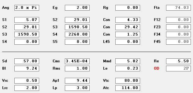

The sim was from Kipman725, included only to show that a "very small throat chamber" (VTC) upper response didn't appear to roll off much higher than the relatively large VTC used in the Boat Horn.

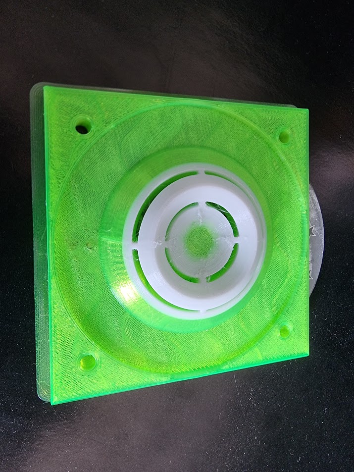

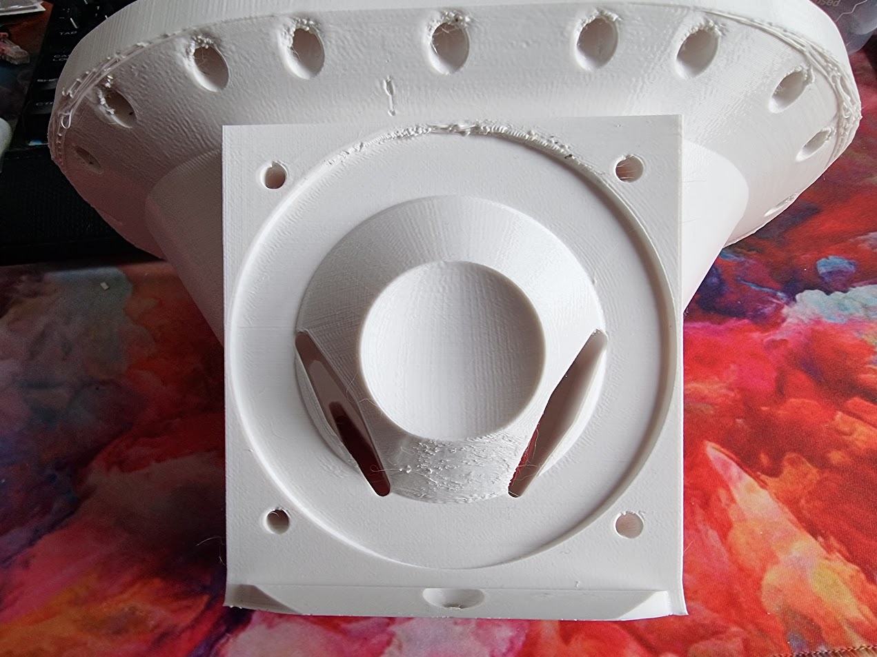

The response of your phase plug reaching ~2.2kHz is impressive, wonder what it would look like if the clearance is increased to ~7mm (or whatever Xlim is)?

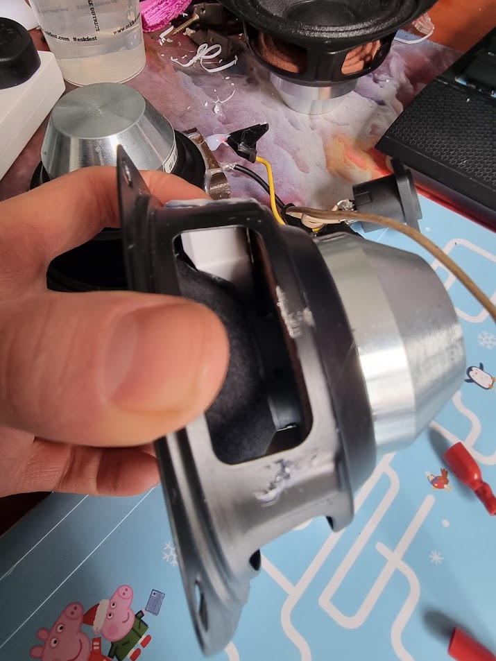

I am now looking at how I could do the phase plug style port and move the ports closer to the CD but I'm not sure it will fit.
I did sim them with a very small rear chamber. I got that volume using the model from B&C after designing my rear chamber caps I measured all the space left inside the model.
The port area and length in both the phase plug style and two ports are very similar areas but not length
Phase Plug: 20mm length and 5.05cm2 area
Two Ports: 30mm length and 4.73cm2 area
I think we would lose a lot of the high frequency based on sims, I can give it a go once I have printed this other part.
I also feel like I should print one with the same port area and length as the phase plug style one to see what that is like.
From what I have simmed hornresp also doesn't account for cancellations in the front chamber based on it's size/shape or cancellations across the horn for example only running one of the mid drivers in a MEH would give you a cancellation between the tap/driver and opposite wall of the horn.
Here are two sims with 2.5mm front chamber and 7mm front chamber:
2.5mm
7mm
Then for reference: (with a very small rear chamber)
2mm
7mm

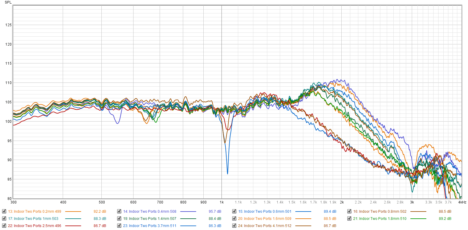

I have done some testing of different front chamber sizes with the two ports
I'm not sure whether it was worth doing or not but it is interesting that I started getting more and more of a dip just over 1k with the larger front chamber.
All the measurements up to 1.8mm were done with a piece I printed with 0mm front chamber then various gaskets
All the measurements above that were done with the original piece that was 2.5mm then the gaskets to increase it.
I am now printing a piece with a port in the middle with the same area as the phase plug just straight rather than spaced out around the cone, will see how that turns out
