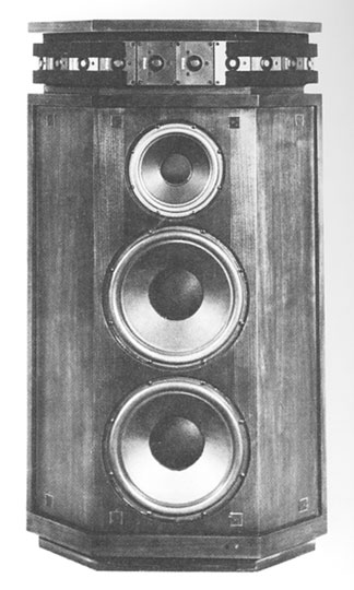

How about a DCM Time Window type configuration?

These were great sound-staging speakers, often images would seem to be coming from behind the front wall. A good three to four feet back if I recall correctly.

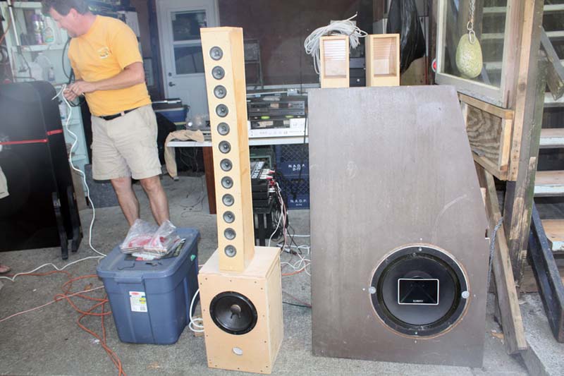

The speaker on the left is my focused array. It won the 2-way division at last Summer's speaker contest ("The Puget Sound! DIY Speaker Contest").
Behind the speakers is the distinquished diyAudio Moderator Cal Weldon, attempting an impersonation of a sober person...(didn't fool anyone!)
Best Regards,
TerryO
