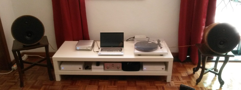

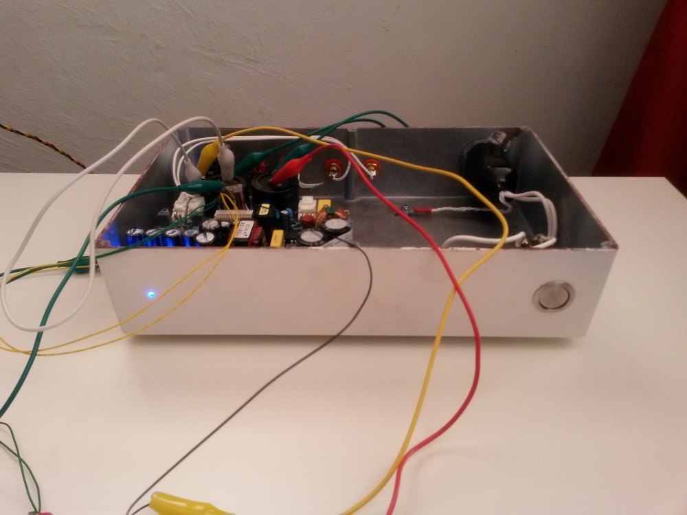

I love my diy Mini Aleph Class A amp, but it's a bit brutal on the electricity bill, so have been meanin for quite some time to do a good Class D build. In the past I've only dabbled in Tripath 2020, which I liked alot but it was a bit underpowered (curiously my Mini Aleph, which is around 10wpc, never felt lacking).
After some hesitation between the Hypex ucd180/400hg hxr modules and other options (nCore a bit too expensive), I decided to go for the new Anaview AMS0100-2300 modules -- http://www.profusionplc.com/pro/gex/pcatdtl0?ipartno=AMS0100-2300 -- and get a pair to use in BTL mode.
They are being built into a Hammond 1550j case.
At the moment I'm testing them with balanced inputs, direct from a Teac UD-301 dac, attached to a PC running JRiver media centre.
The input impendence on these amps is low: 2.5k-12.5k SE, and 1.39k-12.5k balanced. The Teac DAC has an output impedence of 200ohms.
I'll also be incorporating input buffers -- have ordered a set of Per-Anders' Sjöström Super Buffer - I'll get those boards in a few weeks, so at some point will be able to test the Anaview with a good input buffer stage. These buffers have an Input impedance of 1M ohms, and an output impedance of 2.5 ohms. I've left plenty of space in the cases for the buffers+psu.

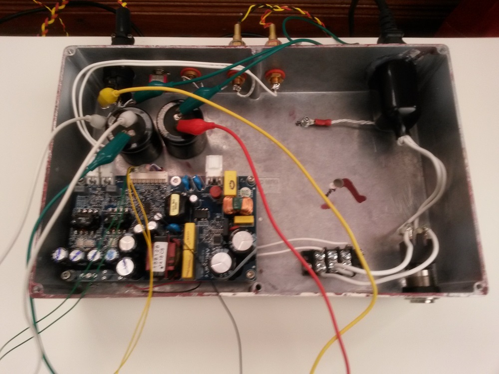

Tested the amps first without any input capacitors -- no pops or anything nasty. Then remembered I had a load of Black Gate NH 150uf 350v in my parts bin which I've used as coupling caps in the past and they seem to me to be totally transparent, so I've popped a couple in this build just for testing.
Have some crackling/distortion/static noise at high volume, though that could be because of the clip leads all over the place. Will solder them up next and see if that fixes it. Will comment on sound too once this issue is resolved.
Some pictures below.

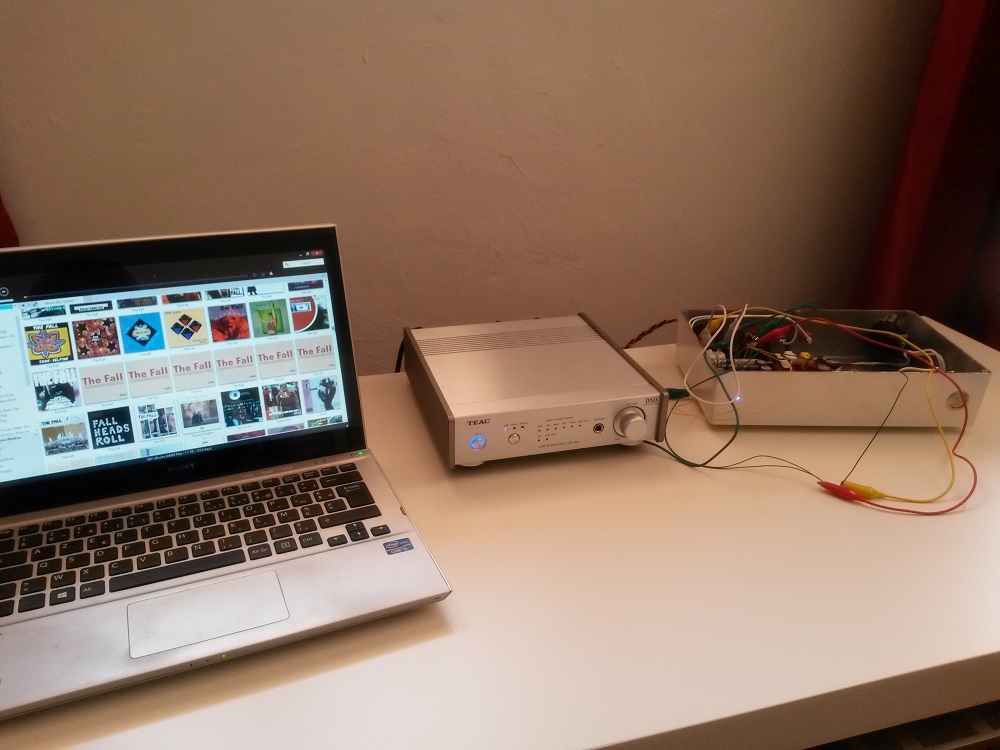

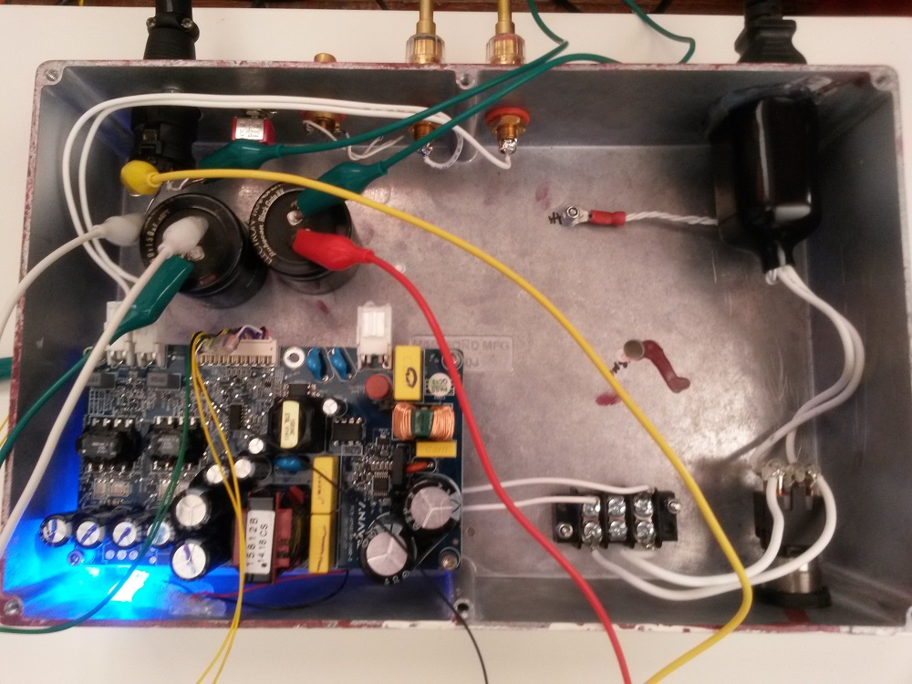

Wired/soldered up properly one of the amps now with the BG coupling caps, and still had crackling/distortion/static noise at high volume... however turns out this was because of the JRiver output settings, which was outputting everything to 2x DSD. Anyway turned this off and the amp is quiet as a mouse and very clean.

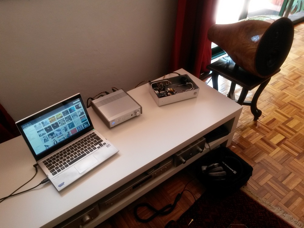

Both wired up and working perfectly. Just leaving them playing and will reserve making any definitive subjective comments until I can get accustomed to them and then start doing some direct comparisons with the Aleph. All I can say at this point is that they sound really very good. The bass is amazing -- very tight and detailed, no flab at all. They seem to grip the speakers like nothing else. Detail is exceptional.
Still need to test more with/without input caps, and then, when I get the boards from P-A, with/without input buffers.
As for the modules themselves, they are super easy to work with -- very much plug and play and the diy work is chassis/connectors. The boards seem very high quality and well made. Given the efficiency of these amps, they'll be the 'always on' amps in the house.

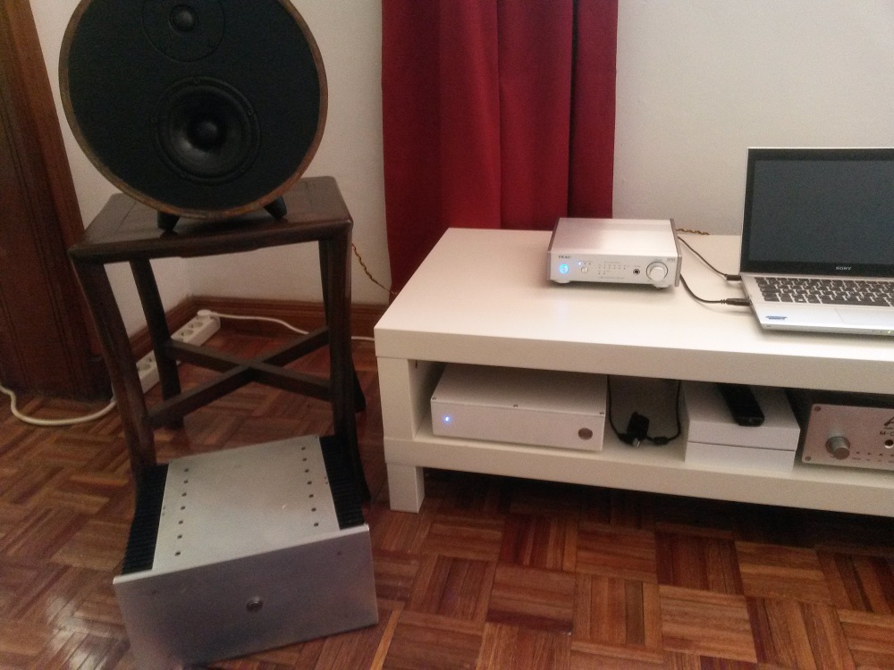

After a couple of days of listening, I can give some initial impressions based on listening comparisons between the Anaview and the amplifiers that I can actually do a comparison with. Obviously some people will be keen to know how the Anaview sounds compared to Hypex UcD or nCore... sorry, can't be of any help.
Compared to a Marantz PM17 (this is a push-pull, solid state, 60wpc integrated amplifier. Very well made, very reliable. About 16 years old). The sound of the Marantz can be described as warm, if not a bit muddy and mushy. Bass is a bit flabby. Fatiguing/harsh with full range speakers. Good with two-ways. Not a bad amp, but not a great amp either. In comparison the Anaview has significantly tighter bass, feels far more powerful, has more detail, and throws out a bigger soundstage. The difference in detail is incredible. Night and day. Hardly surprising though -- the Marantz is an integrated that has A LOT in the signal path. So this comparison was just for the sake of it.
Tripath 2020 (DIY board by autocostruire.com): The Tripath has some of that Class D detail but a bit of (reputedly) "tube warmth" (woollyness?) too. Sounds terrific with full range speakers with certain sources. On the downside it's also a bit dry, just doesn't have the muscle to drive 2-ways, and can be bit harsh on the highs too. Anaview has significantly better bass and control over 2-way speakers, and sounds similar to the Tripath with full range speakers, only far more detailed (and less forgiving of poor sources). The Anaview is better on the highs, no glare. The Anaview throws out a bigger soundstage.
Compared to Nelson Pass-design based Mini-Aleph amplifier (based on BrianGT's boards, with overbuilt PSU and quality components. About 10-15wpc. Class A). I love this amp. It's been my favourite for several years, but it's not really an "always on" amp because of the power consumption, even for this low-powered variation. It sounds great with full range and and 2-ways, has a very lush midrange and seems to make every source sound good. It works well with passive and active preamps. In fact to my ears this amp is just about perfect. At my listening volumes I've never found it under-powered.
In comparison the Anaview has more grip over the speakers, tighter and more detailed bass - the difference on this is very big. In the midange and highs, the Anaview is detailed and transparent where the Aleph is lush... The lows sound better on the Anaview, the mids are perhaps slightly pronounced on the Aleph. The highs are all there in all their glory (or not) on the Anaview, and smoother on the Aleph.
