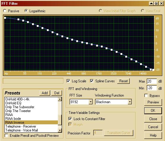

Of course and I'm trying to refine it ATM.
When recording with AA and perhaps also Cooledit, the fft range varies with the sample rate.
If you record with a 44.1 sample rate the range is 21.39Hz up to 22.050kHz.
I've inputted about thirty frequency points on the scale with the corresponding RIAA numbers and I'm currently comparing a wide range of frequencies by generating sine waves with a fixed frequency and let the fft do the job. Then, with the amplitude stats, I calculate the difference between the original and the RIAA'ed amplitude. The fft size is 8192 points, which should be pretty accurate. I'll post the RIAA curve if you can't find it here on the forum.

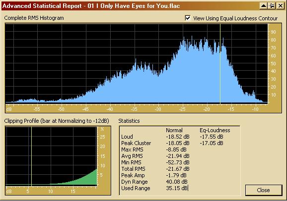

I'm slowly getting a grip on the dynamic range issue.
I statistically compare both files and the digitally eq'd one has a used dynamic range of 32.95dB, while the analogue RIAA has 38.65dB.
/Hugo

Two: the Audition FFT filter is linear phase. A RIAA equalizer should be minimum phase. That's a gross deviation from the spec. You have to fix that first before you can compare methods.
There's a pre-made RIAA filter in the Voxengo CurveEQ plugin:
http://www.voxengo.com/product/curveeq/
It comes with three flavours of phaseshift.
Werner,
The measurements I did were both done with Audition (see picture). I would assume the results to be consistent.
The best dynamic range is maintained with the Voxengo. Thanks for that link, Werner.
Then comes the Audition build-in Graphic Equalizer but both are very similar in performance.
30.75 dB vs. 30.15dB
The fft filter does a less good job with only 29.7dB.
I didn’t check the accuracy of the different methods yet.
Still, as mentioned, the analogue equalization is far better, say +5.5dB at best and definitely accurate.

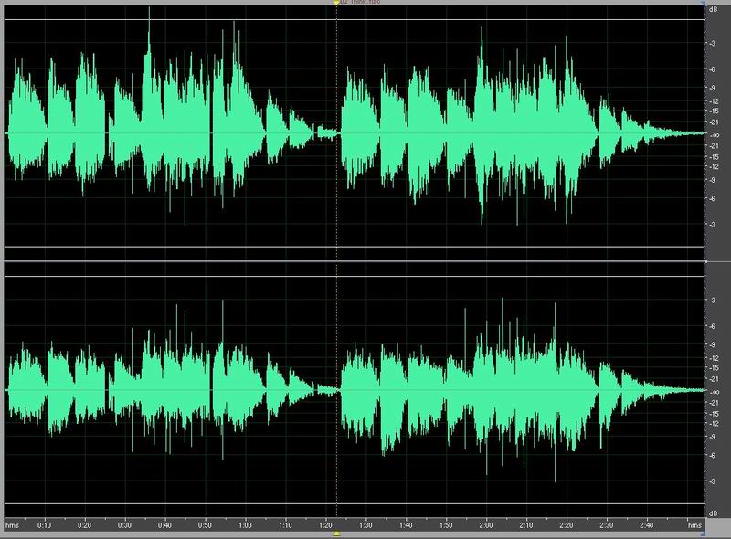

Another thing I noticed is the difference in waveform between both recording methods.
Left you see the digital and right the analogue version.
The first is not as nicely folded out symmetrically, especially the right (top) channel.
What could be the cause of this and how would I have to interpret this asymmetry?
Perhaps then your assumption is wrong. You are using very crude statistical methods on datasets which are very very large. The Audition stats work in time slices, glossing over finer detail in the waveform/dataset to get quickly to reasonably-accurate results. If you don't align the datasets with single-sample accuracy then you can't compare, or at least you can't use the Stats tools as the measurement tool you want it to be.
Further you really have to normalise the datasets with respect to average level in the midband (say 300-1000Hz) and perhaps even below 20Hz: LP replay causes such a heap of subsonic rubbish that any LF 'difference' in the signal chain (I guess the Ono is AC coupled, and the path use used for digital was near-DC) may warp the Stats results.
Audition's waveform displayer is even cruder. Again, you can't extract any meaningful information from this unless you zoom in to single sample accuracy.
Trust me, I've been using Audition for lab purposes for many years now.

The only two problems I’m still facing is the asymmetry of the waveform when recording straight from the cartridge (Only MC amp without RIAA) and the higher noise floor of the instrument input of the soundcard.
