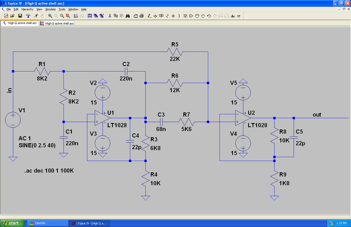

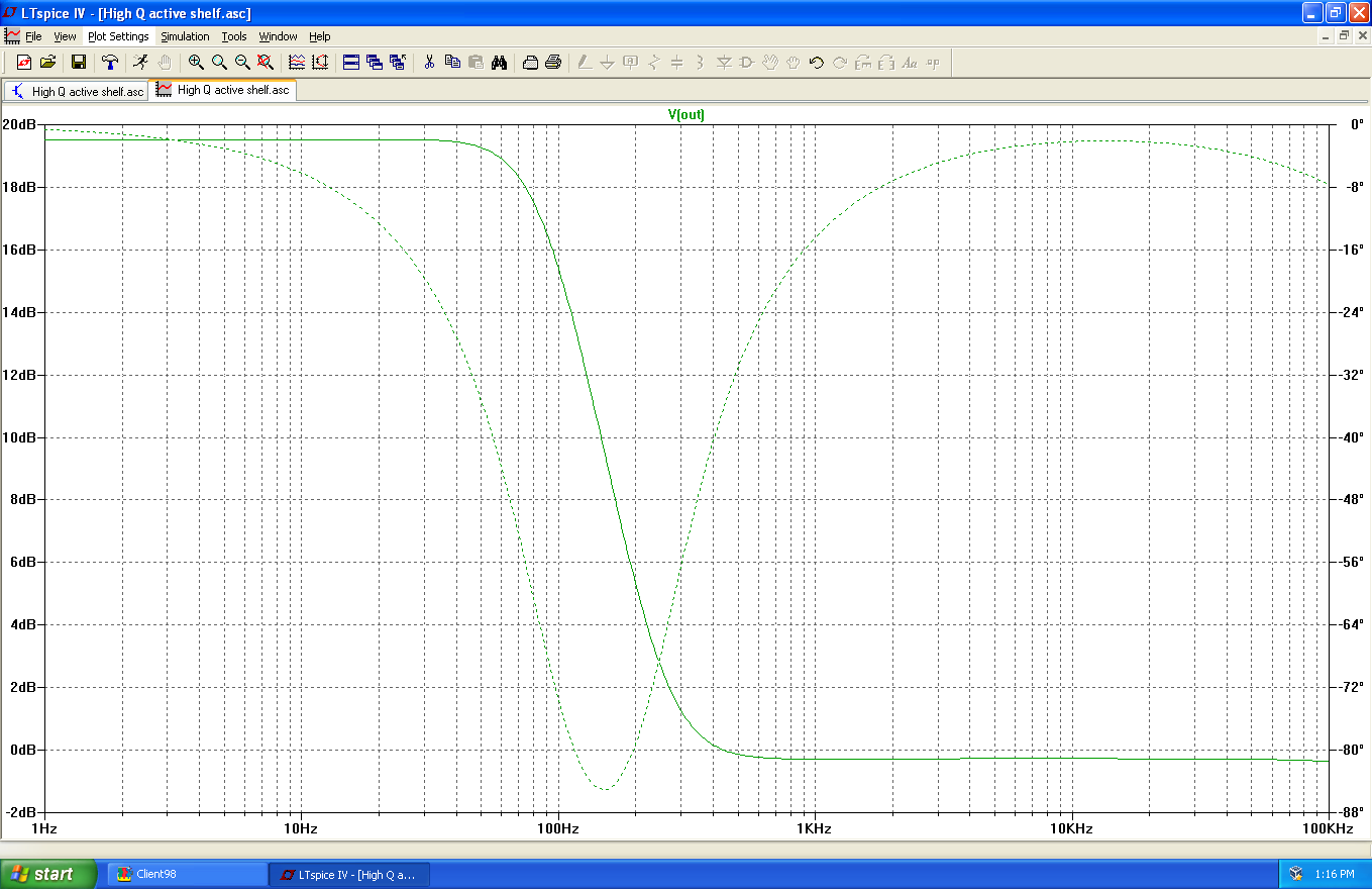

If you do decide to roll your own opamp based active EQ, I've got an EQ design that I use for transmission line speakers that could be easily tweaked to give you what yo need.
Here's a sim to do 20dB of bass boost, starting from ~250Hz and finishing boosting at ~80Hz. It's probably a bit faster than you need, but you can easily tweak the rolloff slope by changing R3.
That's a lot of boost though.
