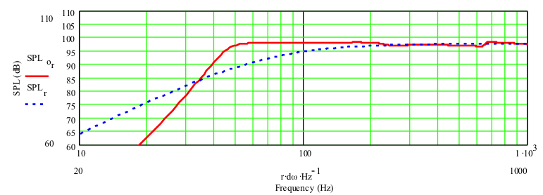

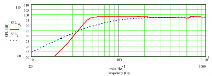

I have simulated the SAL in a MLTL, see enclosed. I have not build these yet, but it looks very promising. There is a lift in the bass, but I expect that the baffle step will compensate for this.
With less than 10 watts the SPL reach 105 dB without reaching the limits of the driver.
