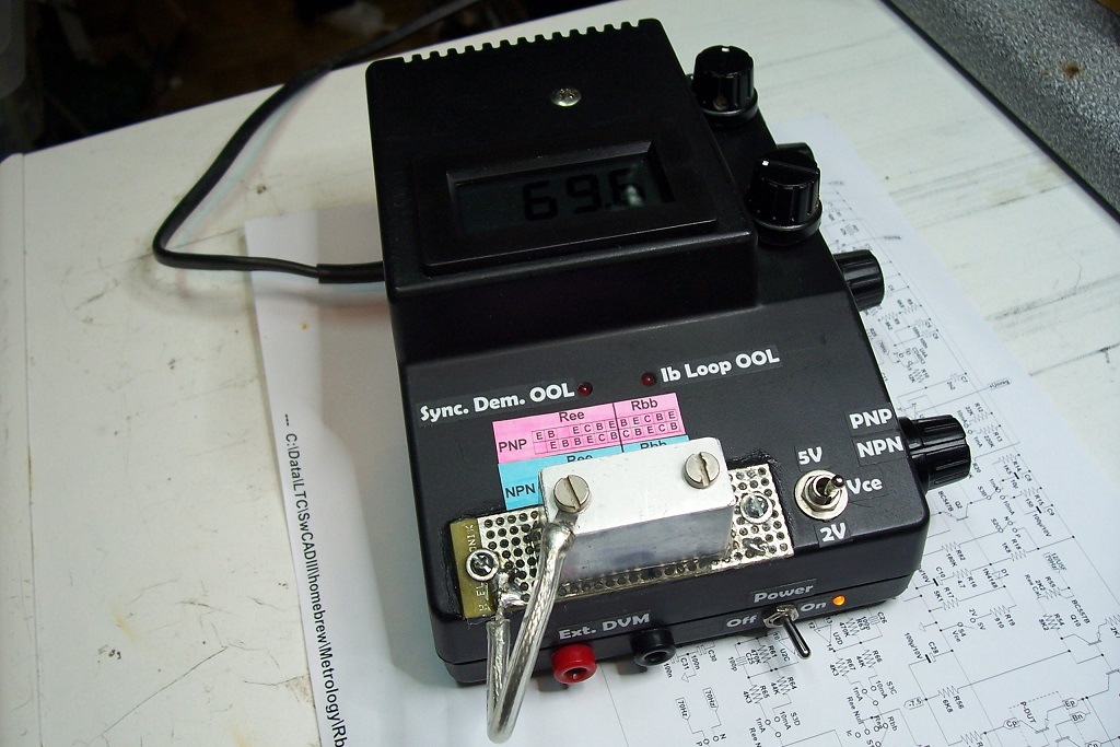

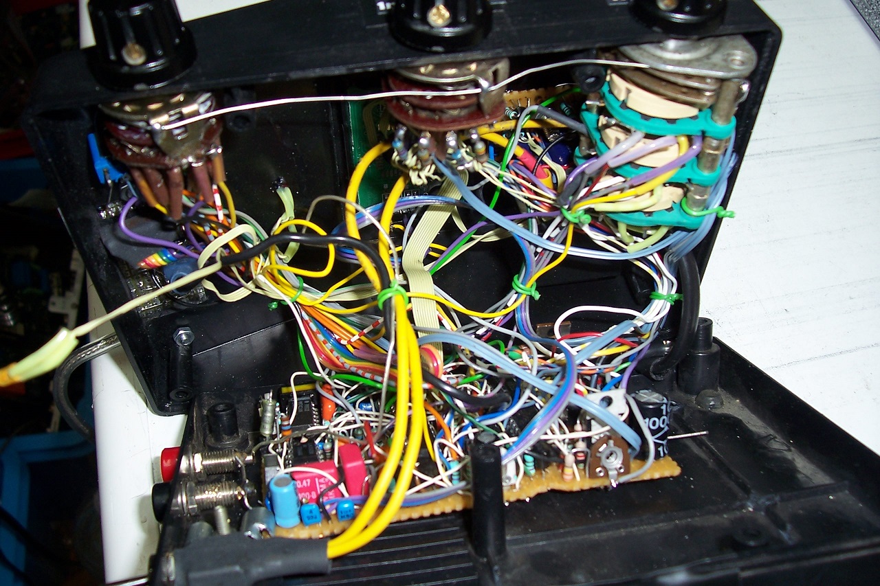

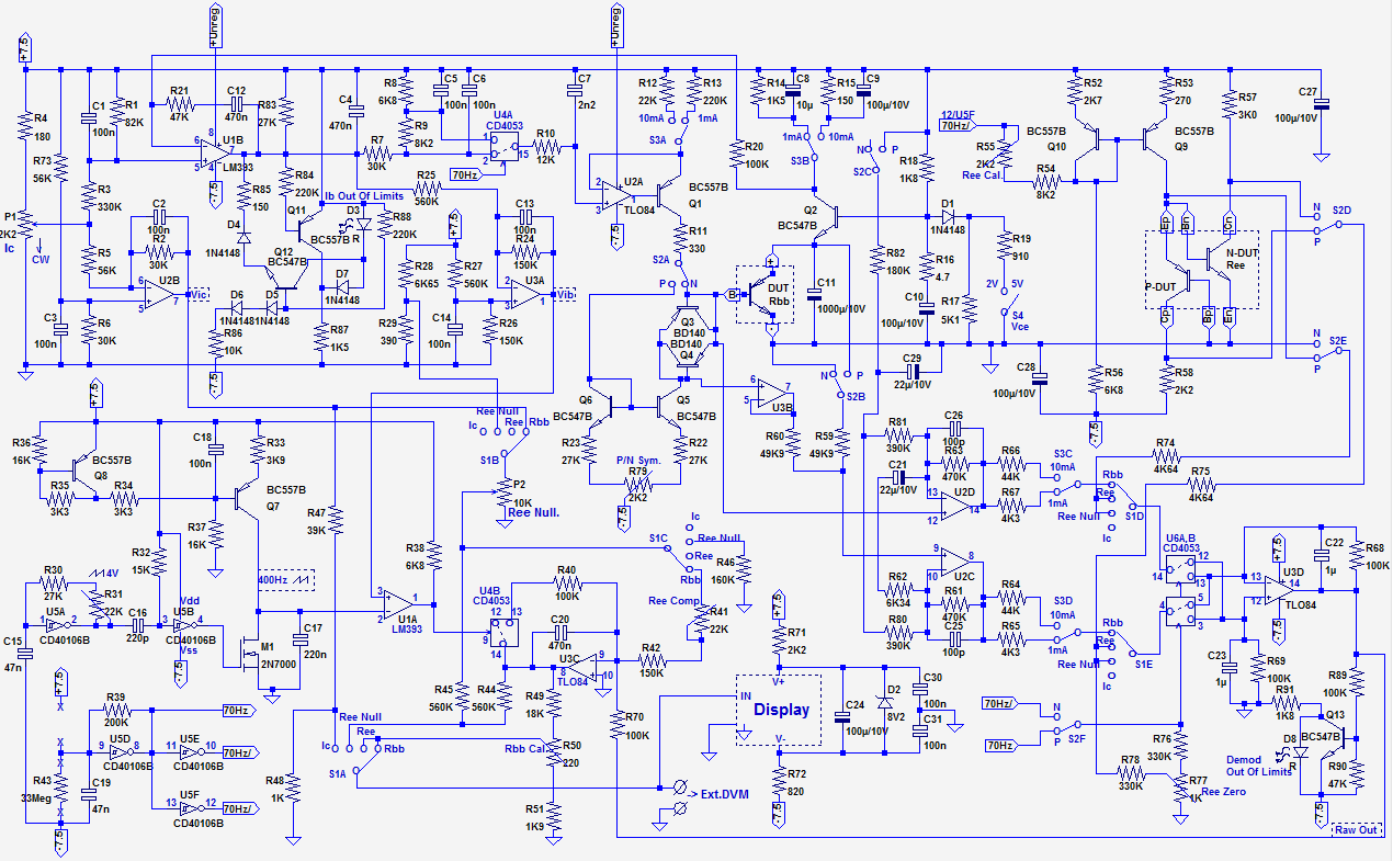

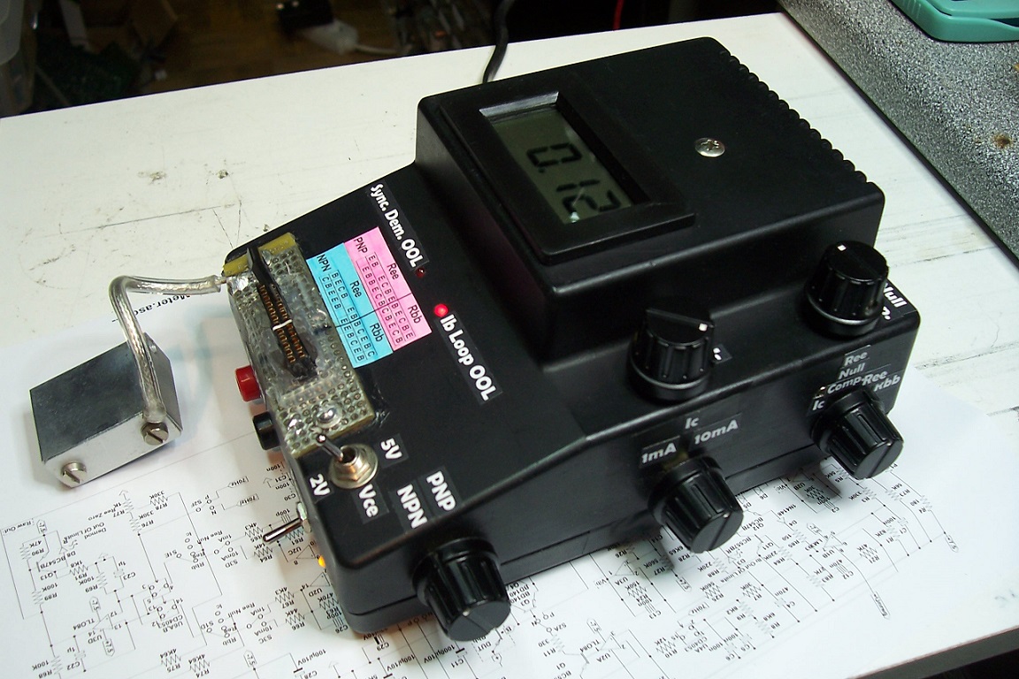

I will describe the circuit later, but here is already the main schematic, and a picture of the finished instrument:
Presentation
Characteristics:
This tester extracts the Rbb of an NPN or PNP transistor for collector currents varying from 100µA to 10mA, and Vce's of 5V and 2V (it makes almost no difference, but it is also almost free to implement).
Accessorily, it can also measure Ree: that is not the main purpose of the instrument, but since Ree needs to be extracted in the process of measuring Rbb, it can also be displayed.
Operation:
To test a transistor, the process begins by inserting it into the Ree part of the jig.
With the function selector placed on "Ree Null Comp", the nulling potentiometer is used to zero the reading on the display.
If desired, the Ree value can be read on the "Ree" position, then the transistor is moved to the Rbb section, as is the function selector.
The isothermal cap is placed, and when the reading has settled, the Rbb value is displayed.
Once the initial compensation has been made for a given transistor, the collector current and the Vce can be freely varied, without any further adjustment.
The average Ic can also be displayed on the corresponding position of the selector.
Principle of operation:
With the transistor under test properly biased (I will detail this later), its BE junction is placed in a bridge: the TUT and a reference junction Q3 or Q4 form one arm of the bridge, the other being R59 and R60.
The base current is pulsed at ~70Hz, with a ratio between the highs and lows of approximately e, yielding a voltage variation of ~25mV on both junctions.
The reference junction is a diode-connected transistor, selected for its low Ree and Rbb, and high beta down to low currents, meaning its behavior obeys almost perfectly the ideal logarithmic law, unlike the TUT.
The small imbalance caused by the series resistances of the TUT will generate a voltage across the bridge.
This voltage contains the Rbb*Ib information, but also the Ree*β*Ib term, which has to be eliminated.
That is the role of the Ree jig:
The Ree is measured by pulsing the base current of the TUT in a deep saturation condition, and sampling the resulting variation of the Vce.
This value cannot be subtracted directly from the raw Rbb voltage: there is the β factor between them, or in other words, the Rbb is referred to Ib but Ree is referred to Ie~=Ic.
The Ree voltage is thus used to set the position of a potentiometer fed by a fixed reference voltage, and when the actual Rbb measurement is made, the feeding voltage is switched to a voltage representative of Ic.
The potentiometer thus serves as a storing register and as a multiplier.
The same could be achieved completely automatically with a microcontroller and a good quantity of relay contacts.
Once the Ree term has been eliminated, the half-raw result still needs to be scaled according to Ib, to fulfill the Rbb=Vb/Ib relation.
The final result of these operations can then be displayed, and reflects the pure Rbb value.

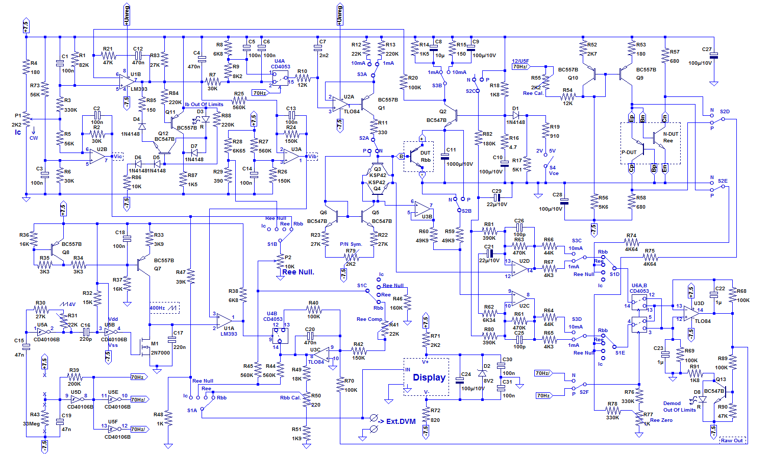

Here is the updated schematic. I will detail later what the issues were.
Now, let's have a look at the base current controller.
Its role is to convert the Ic potentiometer setting into the corresponding, properly modulated base current.
This requires a servo loop, because the beta of the T.U.T. is unknown.
The servo controller is U1B: it is a LM393 operator used as an opamp.
It compares the +7.5V-referenced Ic setting to the average collector current measured by R14 or R15, filtered by C8 or C9.
The cascode transistor Q2 sets the Vce of the T.U.T.
U2A/Q1 actually do the job of generating the base current, modulated by U4A to a ratio of ~1:2.718.
U2B and U3A generate ground-referenced versions of the voltages representative of Ic and Ib, used for display and processing.
The circuit is natively designed for NPN transistors, and the adaptation to PNP's is performed by mirroring the base current with Q5/Q6, and reversing the C and E of the T.U.T.
The loop can accommodate β-values in the 60 to 1200 range.
If those limits are exceeded (or if the T.U.T. is faulty or misconnected), Q11 or Q12 detects the condition and lights the warning LED D3.
The generated Ib also flows through the reference junctions, Q3 or Q4.
Amplifier, synchronous demodulator and Ree section
Amplifier:
The base current generated by Q1 or mirrored by Q5 is applied to the reference junction and the BE of the T.U.T., forming one arm of the measuring bridge.
The other arm (driven by the buffer U3B) is formed by R59 and R60, which are matched very accurately.
If both the reference junction and the T.U.T. ideally obey the logarithmic law, the two arms will generate a step of exactly 26mV, and the difference sensed and amplified by U2C and U2D will be zero.
Because Q3 and Q4 are diode-connected and selected for a good ideality, any difference will be caused by the imperfections of the T.U.T. and will appear between the outputs of the diff-amp.
Synchronous demodulator:
The difference voltage is fed to the common of the analog switches, which alternate between the + and - inputs of the difference amplifier/integrator.
The clock driving the switches is the same as the one that drives the bi-level base current, making the circuit completely insensitive to external perturbations (within reason), DC offsets or common mode voltage: the output of U3D is an accurate image of the voltage difference between the two levels, and nothing else.
This raw voltage will need further processing, because it contains other terms and constants than the pure Rbb.
Ree Meter:
The Ree meter uses globally the same strategy and detector as the Ib generator, but it can be made simpler, because the current is fixed.
The test current is generated by Q9 and Q10, and applied to the base of the T.U.T., which is driven into deep saturation. Since under those conditions, the C-E space is more or less a short, the voltage appearing at the collector will be an image of the voltage on the internal emitter, after the Ree; that's the theory anyway, because in reality, things are not that clean and there is also a residual internal Vce voltage, and the Ree itself has some disconcerting properties when viewed from a "compact model" perspective.
That is the reason for R57 and R58, and the difficulties I have encountered: because the final Rbb result involves a subtraction between the raw voltage and a Rbb-related one, any tiny inaccuracy in any of the terms has a disproportionate effect on the accuracy of the final result.
The surest way to blow measurement uncertainties is to subtract two very similar quantities, which can be the case here, but is unfortunately unavoidable.
The PNP jig looks different, but in fact works in exactly the same way, as the perfect CMR of the sync-dem allows the sampling across the C and E.

Processing:
Before displaying the final result, some arithmetics have to be applied to the raw demodulated voltage:
The first step is to correctly position the compensation potentiometer.
When the instrument is in "Null Comp" mode, the signal is passed through U3C without modification: U3C performs the base current hyperbolic correction (more on this later), but when no device is plugged into the Rbb section, the Ib loop is in positive saturation, making the switch U4B permanently closed.
Thus, the raw signal appears unchanged (except for the sign) at the output of U3C and is applied to one side of the resistive bridge R44-R45.
The other side receives the output of the compensation potentiometer, fed by a suitably scaled voltage of opposite polarity.
The output of the bridge is monitored, and when the null is reached, the potentiometer is correctly positioned to subtract the Ree*Ic term from the raw Rbb*Ib + Ree*Ic voltage when the function selector is moved to Rbb, and the Ic-dependent correction is applied through R41-R42.
Now that the output of U3C only depends on Rbb*Ib, the last thing that remains to be done to display Rbb is the division by Ib:
The DC gain of U3C is set by the ratio of R40 to R70, multiplied by the inverse of the duty cycle of U4B.
U4B is controlled by the the comparator U1A. A sawtooth is applied to its reference input, while a voltage representing the base current is applied to the other.
The duty cycle at its output is thus an exact image of the base current.
The sawtooth has a frequency of 400Hz, and the amplifier is filtered by C20, to make R40/d look like a real, continuous resistor.
  • Note that this step is much more than a mere correction, and needs to be carried out accurately for a wide dynamic range: the tester accomodates β values in a 1:20 ratio and Ic currents in >1:10 ratio, meaning a total dynamic range of ~50dB.

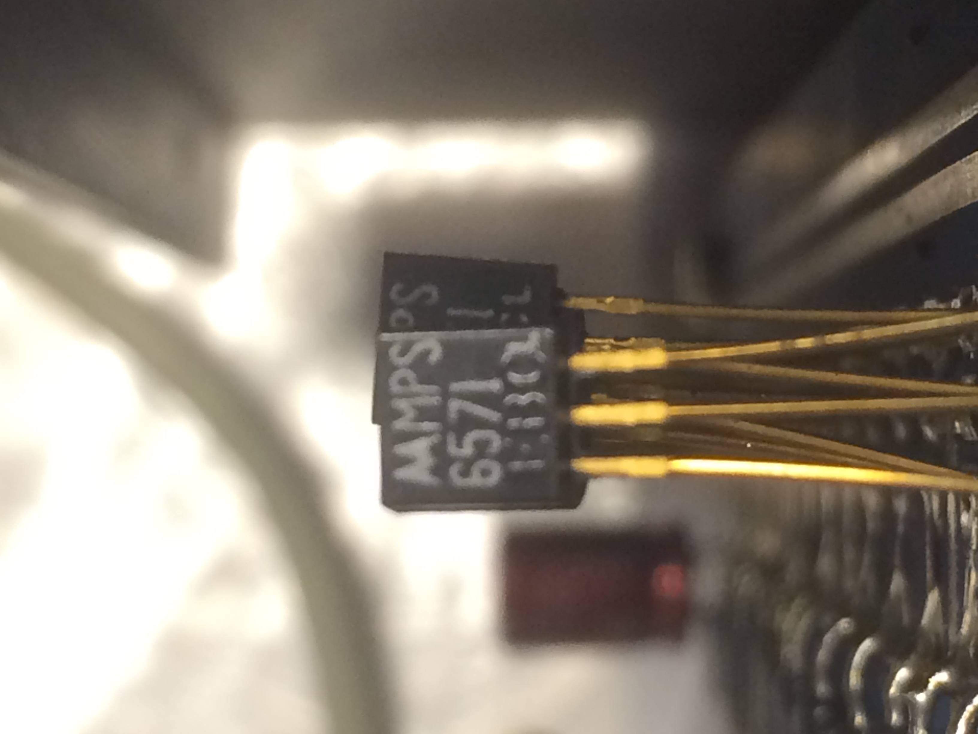

If you PM me your shipping address, I would be glad to send you a few samples of the lowest Rbb transistors that Horowitz and Hill measured, in their 2015 survey of 54 different BJTs (Art of Electronics, 3rd edition, p.501). I'll also toss in a couple of MPS6571s; these are the NPNs that Nelson Pass used in the Threshold M1 moving coil pre-preamp, and that he also used in the Threshold NS10 preamplifier phonostage and line amp stage. Datasheet attached.
_
  • MPS6571.pdf
    MPS6571.pdf
