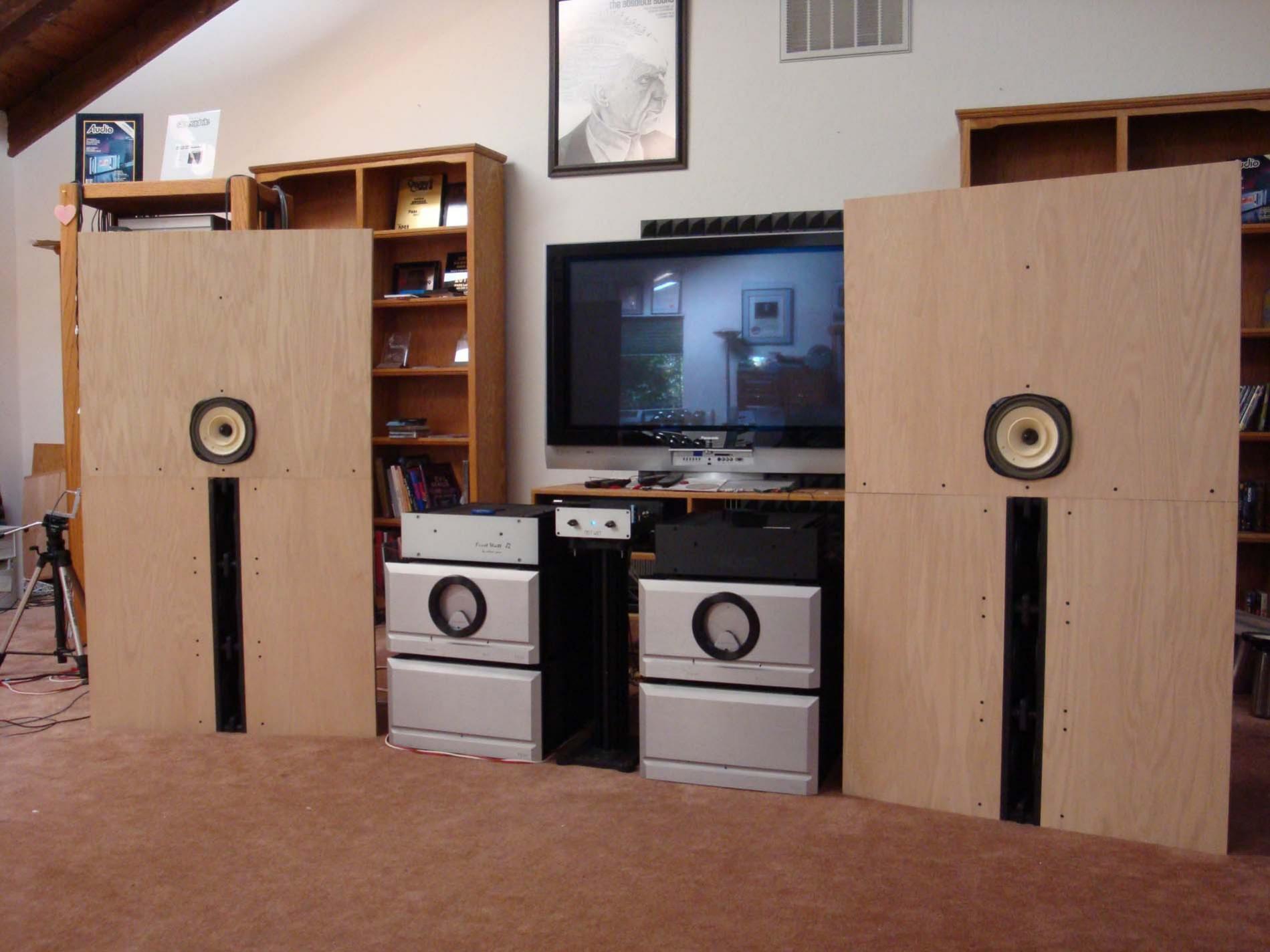

but Nelson has a neat article about the slot OB he first developed long ago at AMT and some modern, recent updates with graphs!
www.firstwatt.com/pdf/art_slob.pdf
With Lowther
With Lowther
The first part of that article about the low-frequency version essentially describes the LAT (Linear Array Transducer) that is no longer made (by Tymphany). I have a couple of those smaller ones laying around that I was selling. Little did I know they were AMT's all along. 🙂
