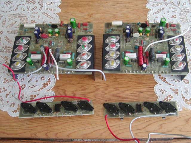

I have some Ampzilla driver boards with original transistors date coded 1977.
I believe this make these boards the second board out as the kit was made a few years before this.
So, my memory has gone to hell and I simply cannot remember which bias IC it
needs to function. Do I need the CA3086 with this version or the MPQ6001?

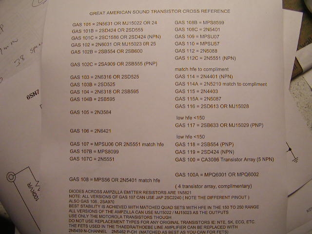

In checking your prior post you have gone on record saying the Ampzilla used the CA3046 because you checked the pin out. What I am looking for here is 100% proof of what was actually used by GAS. I have old GAS IC's that are marked GAS 100 and GAS 100A. Unless some proof can actually come to life here I'm going to stay with my assumption that the GAS 100 is a CA3086 and the GAS 100A is a MPQ6001.

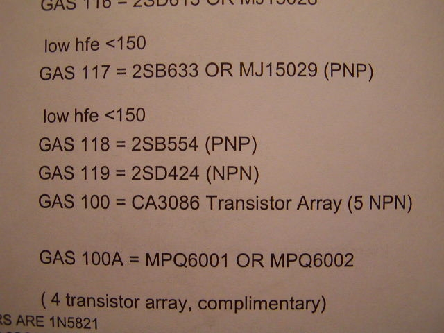

I would say that the cross ref sheet qualifies and it clearly lists the CA3086 as the replacement for the Gas 100 IC.

The CA3046 will work fine. What I was trying to remember and find out to satisfy myself was the correct IC that was used.
Per the Cross Reference sheet the CA3086 is what was actually used so that is the answer I was looking for and not the pin out of the 3046. Both have the same pin out and both could be used. For reference purpose I believe it is important for others to know what the proper part number was/is.
