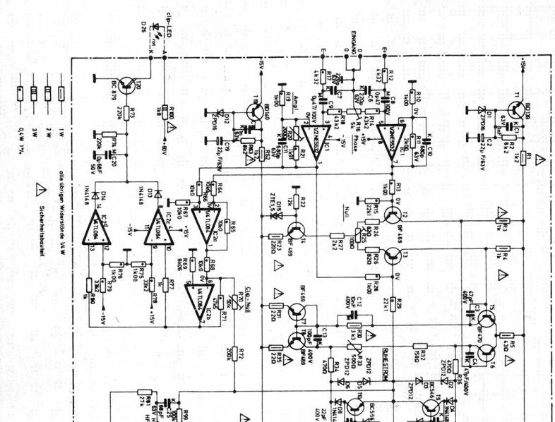

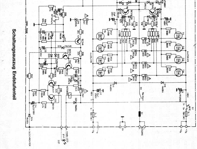

P.S. Also I have one schematic with 2SK414/2sj119 (similar to yours) from old RIM-Muenchen catalogue. I can send you, if you whish.(or place here, Moderators?)
Catalogue diagrams.
Hi Moamps,
If the information is out of a catalogue there should be no problems putting up the diagram here ,mentioning where it is from. I am sure lots of us would like to see the circuit.

Hi Moamps
For some reason I havnt seen your reply before now.
That amp from the RIM-catalogue looks very interesting. I have approx 20 of each of the MOS-fets, and the rest looks cheap.
Can you tell me anything else about the amp? Was it in production by any company? -and if so, when was it?
I'm told that the powerresistors in the output needs to be non-inductive or else the output-stage could oscillate..?

Thanks for the reply
It seems to be very clever/new curcuits. i was looking for something more proven and reliable. The RIM-curcuit lokks "pro" and includes clip-led and overload-protection.
