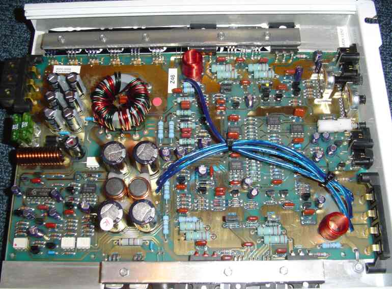

much better
Great pics, now thats more like it, these look much better, all the amps I have are like this, not as big, but lots of smps devices, capacitors and output transistors. My guess is if you were to take the clamps off the top of the transistors they'd be as I described earlier, tip35/36 class if they are bipolar or irf mosfets if its a mosfet output stage.
How do these sound? Have you tried them in any sort of comparison to known good home audio equipment? I have been analysing the schematics and as far as I can see most of these are very, very generic AB amps. If I kill any of them doing my listening test I think I'm gonna replace the amps with two channels of parallel 3886 chips (4875?), sounds good, and has very good protection against abuse...
Stuart
Stuart

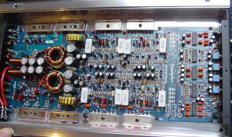

Hi
JBL , better say Harman, has used some home audio curcuits in their older amps. The white GTx (also known as Concord -ST and QD series) series amps have pretty good sound quality and fairly big DC-converters. Huge heatsinks and realistic power ratings, I remember those had been damn expensive over here. In some of those models they used the µPC1298 ( I think thats the right number) Voltage amplifier with Darlington-power stages. That resulted in 50-80W RMS per channel depending on the SMPS and very good and clear sound. In some better home amplifiers from Kenwood or Sony those µPC can be found. But those amps didn´t sell very good as they had been too expensive for the majority. A lot og people dont care what´s inside the box......stuff must be cheap and LOUD........ 🙂
I used to install ALTAI amps a lot a couple of years ago. They were inixpensive amps , huge heatsinks. Although made in Korea, those amps used very good parts and the biggest 2 channel amp delivered more than 500W RMS into a 4 Ohm load ....double SMPS and huge output stages. Sad the company doesn´t build those things anymore.
Last week I fixed a broken PG - ZPA 0.5 pretty good sounding amplifier , but for a 1kW amp they really should have used better heatsinks! Somehow it´s the American companies "doing the right thing" : o ))))))))
But there are a few German companies around, as well. This is a picture of a pure MOSFET power amplifier, delivers more than 2x80W RMS into 4 Ohms (no kiddin!) . Very small heatsink (they really get hot !!!) but those babies have been wonderful, also very expensive. 🙂 But they had programmable filters and stuff included. The company went out off business a couple of years ago
There had been a couple of models around, the cheapest (2x50W) starting with 300US$

I don't have pics, but my Alpine MRV-F400 and MRV-F300 amps look similar to the PG stuff. Of course it's a Japanese amp, but still very rugged and durable. It's a 1994 model, and has been excellent. The heat sink seems to be adequate, it does get hot under prolonged coninuous usage, but it hardly ever sees that kind of usage, so that's okay.

Phoenix Gold
I had one of these amps a few years ago and still regret selling it. The build quality was fantastic and for a laugh I installed 2 KEF B110 units in the car to see what the sound was like. It was better than my home hi-fi which used a Mission Cyrus II at the time!
If they still make them like that - get one and keep it!
