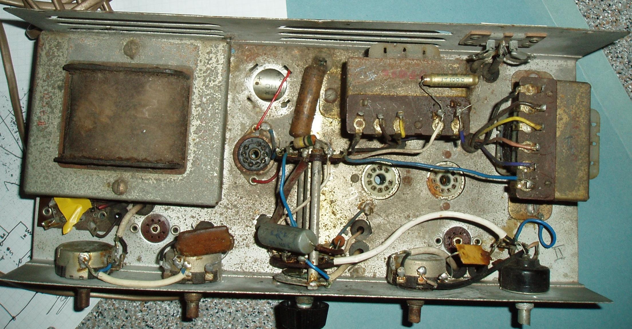

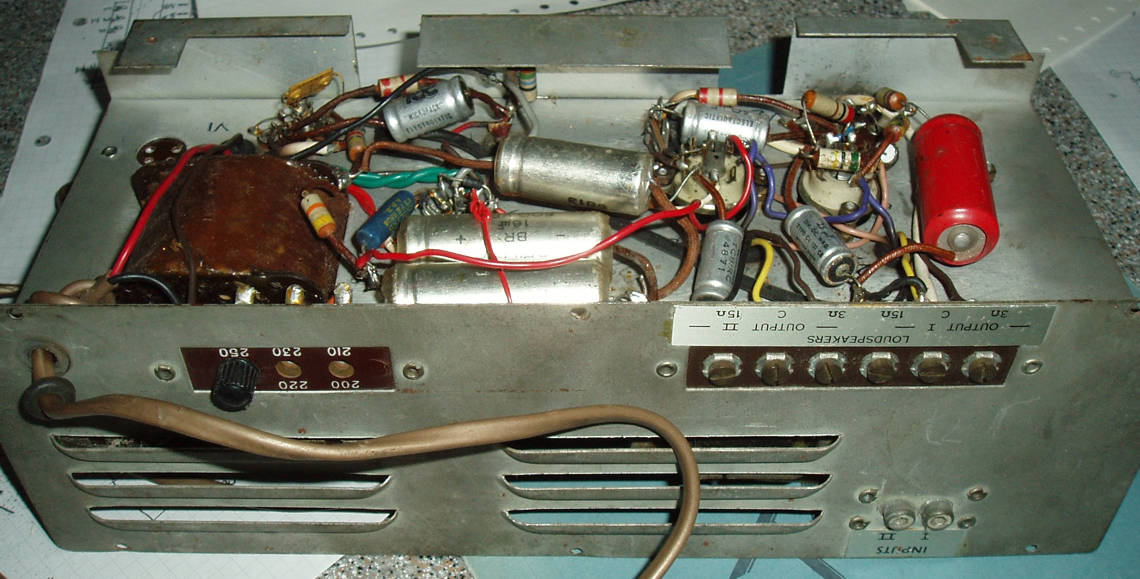

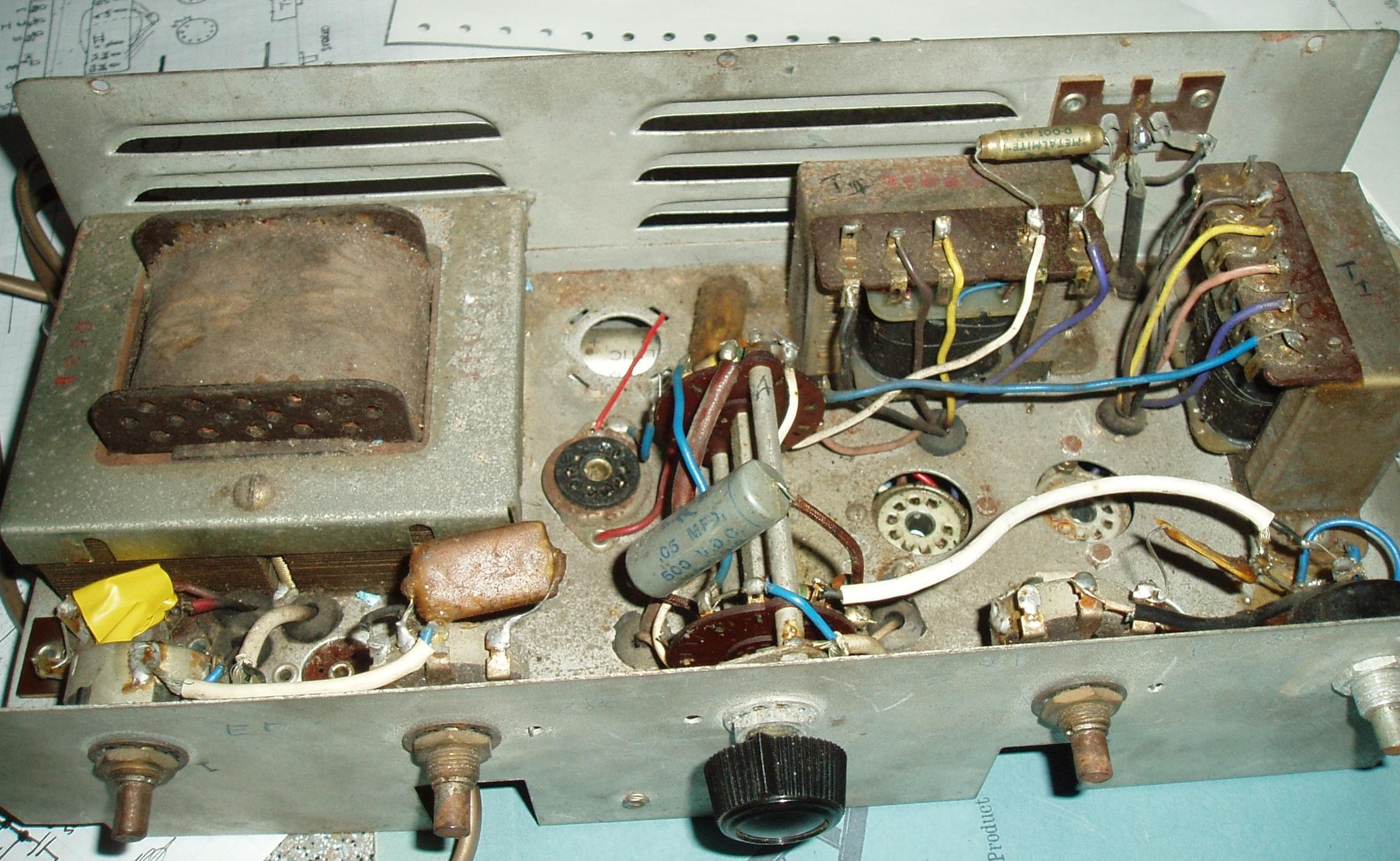

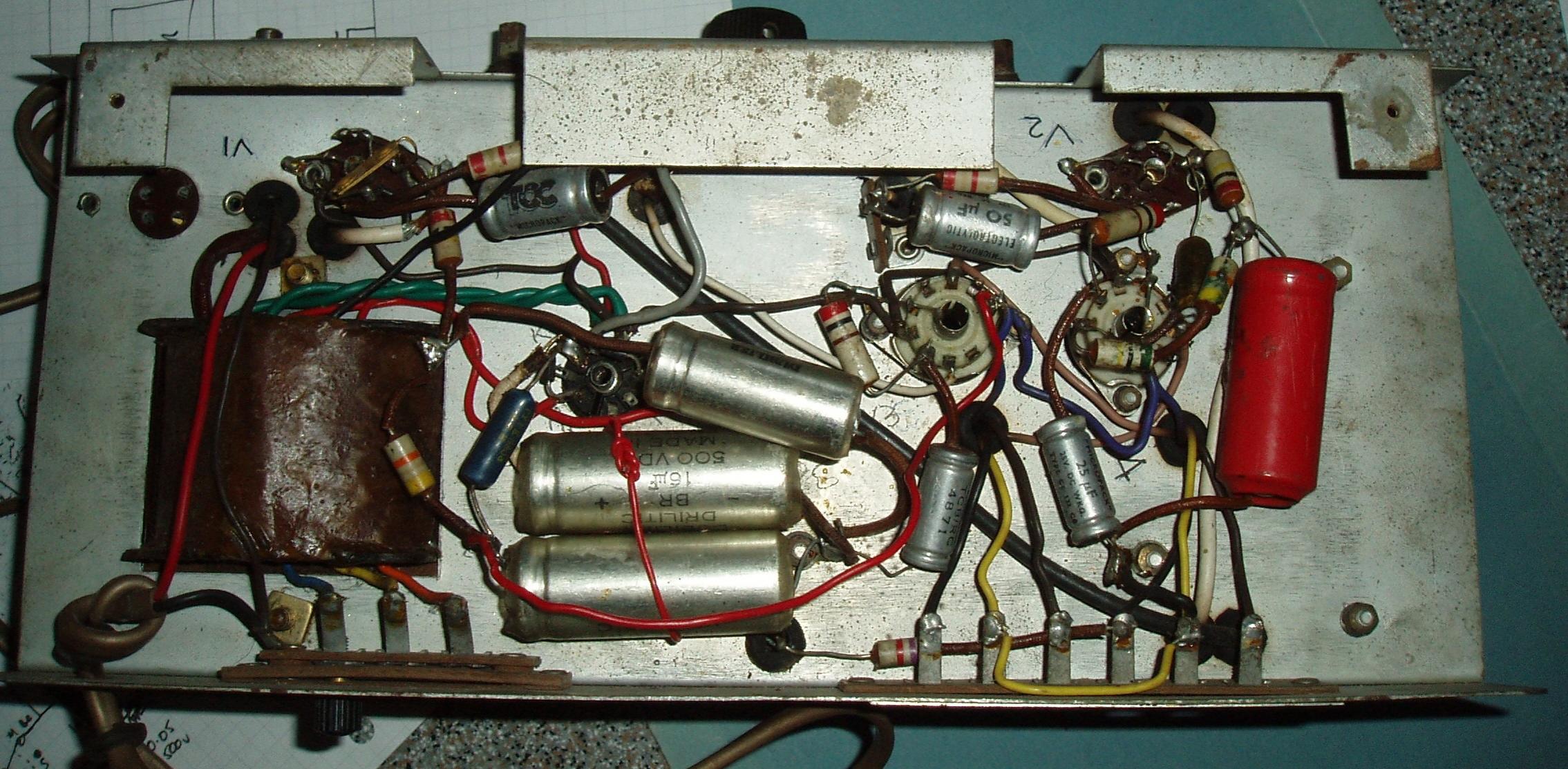

Here's a few photos of the innards.
As can be seen, the construction is pretty 'cheap' but it's been stripped and the chassis cleaned up a bit and now 50% through the rebuild.
The case is quite rusted but is responding to being cleaned up prior to a re-spray...
More pix later...
More pix later...
