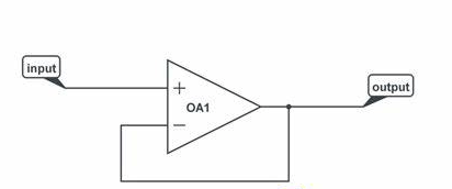

It's a Cary tube clone and an Purifi class D... What kind of "buffer" should I use? Can you provide a link to such a product? Thanks for your response.
Though I am unable to send a link, there are so many options for a buffer that can be added to your preamp output. A classic example would be the Musical Fidelity's X-Can that was made back in the late 90's, but of course, there are many newer examples such what is available as a kit at DIY Store. As usual, you have to be careful when buying many of the tube buffers available on eBay, but that should go without saying. One of the coolest builds was designed by Pete Millett (and probably others as well) using the Korg SP1 NuTube. I really enjoyed the effect/improvement of sound in my system.
Even simple opamp buffer can sound transparent and provide ample input range and plenty of low resistance on output to drive any step up transformer. I use opa604, with unmeasurable (by me) distortion.
