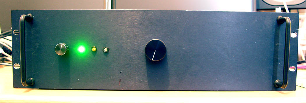

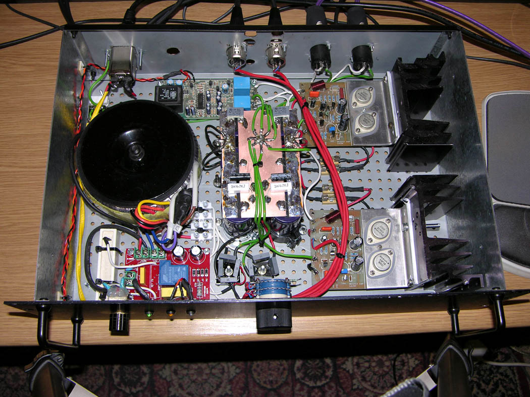

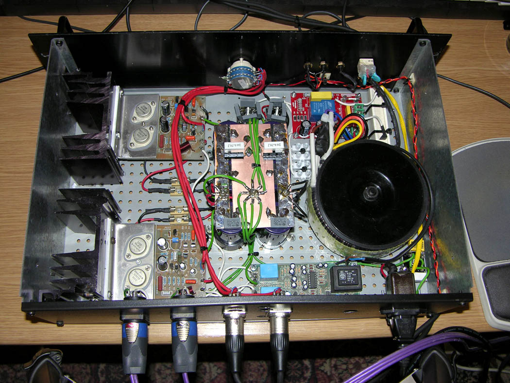

Finished!
So I finished my amp rebuild. It's got two old Maplin mosfet modules that I put together back in 1997. I have no idea where the heatsinks came from.
I've replaced the old 2A 32-0-32 laminated core transformer with a brand new 500va 35 + 35 toroidal. It had just two 4700u 80v power supply capacitors that I've replaced with six 10,000u 80v types, three per side. It has a Velleman loudspeaker protection module (wait and error leds on the front) and a cheapo chinese inrush limit module with a massive ceramic resistor. Switching on is absolutely silent, apart from the satisfying relay clicks. Check out the literal star earth!
I've also put in a chinese 23 step switched attenuator. Note the replacement resistor because of a faulty resistor value.
When I turned it on with speakers plugged in for the first time I thought it was broken. Turned out it was working perfectly; it's just absolutely silent with no signal. Then when I cranked it up I hadn't realised these amplifiers could sound so good with so much grunt!
It's not particularly pretty (probably prettier on the inside!) but it does a good job.
