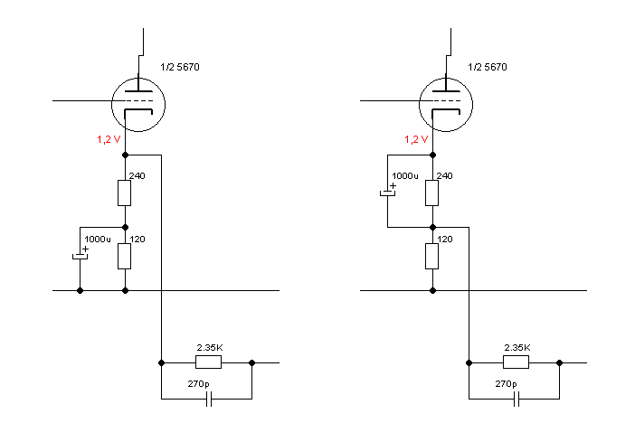

Like k35kk wrote in the thread you linked to: I think there is no GNFB going on in your schematic. The ac-signal from the secondary of the output transformer is shunted to ground by the 1000uF capacitor (C5).
Possible ways to do get GNFB going on:
