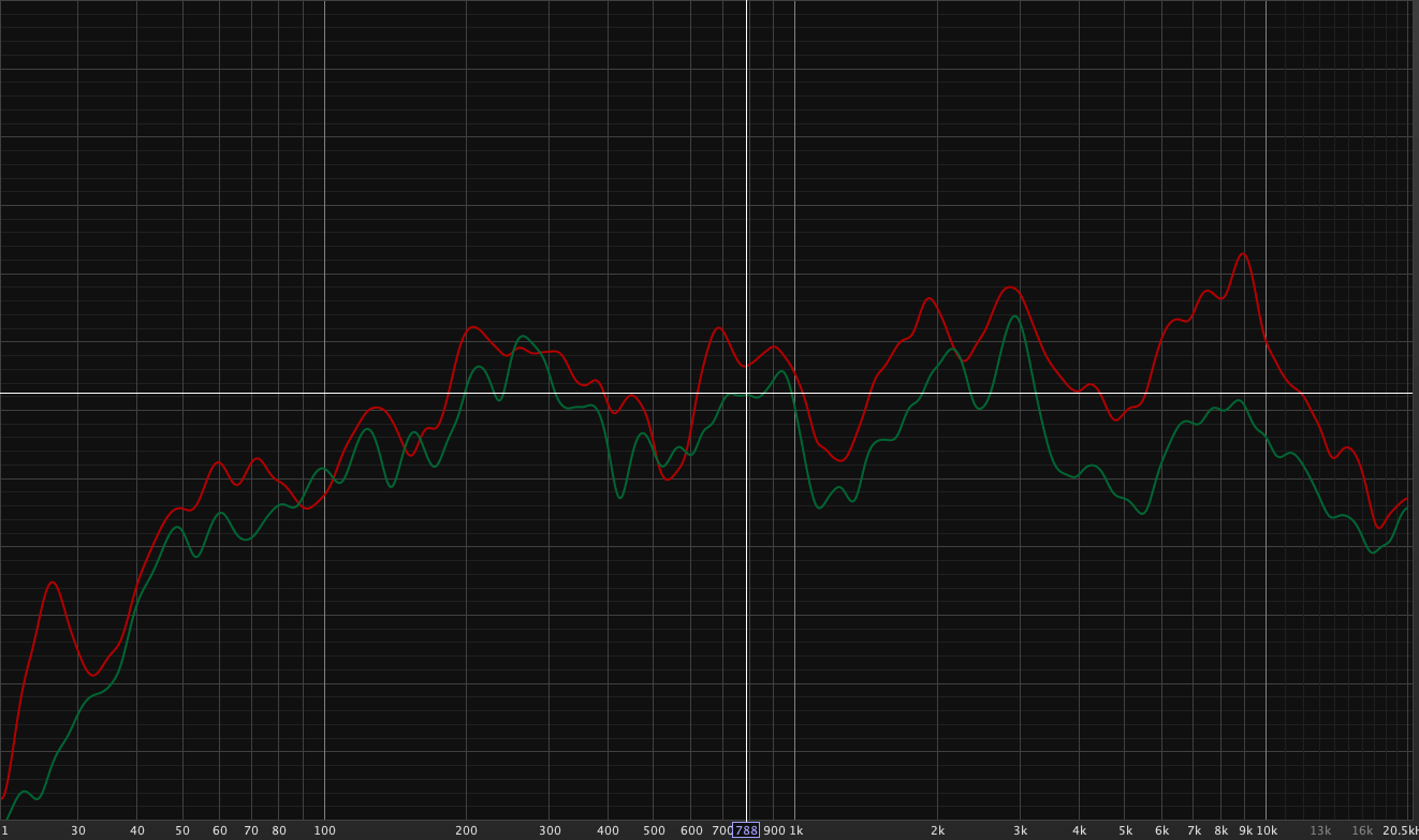

A filter circuit of some sort came with the SALs that I bought from a community member - it may have been made by one of the folks testing the driver originally. It's a resistor, inductor and capacitor in parallel. I assumed it was meant to be in series with the driver. I did some frequency sweeps to see what difference the circuit made and then put it aside since I didn't like the results in the test. (The filtered results are green in the image.) I did eventually do some listening tests with the M2 and the circuit did reduce the shout (and the high frequencies) but not that much. The tube amp seems to be the best option so far.
