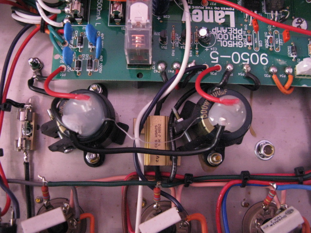

I haven't checked the -35V on the control grids, but by 50/50u caps you mean the big two that are 500WV,100uF each right?If you have around -35V on the control grids, using EL34/6CA7 and the valves are balanced, check the main smoothing 50/50u capacitors. THERE IS 460v across them. BE CAREFUL!!!!!
Placing a temporary 47u 500v across each one in turn will help with fault finding.
In my case i'll be needing 100u 500V across each to check if they are faulty? I'll drain them first though, at the moment I'm getting a reading of 3V across one of them, the other one I can't seem to be able to measure. I haven't turned the amp on in two days, so they may have discharged, but anyways I'll need to get hold of a 500v cap first before I can check anything.

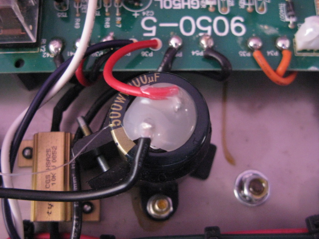

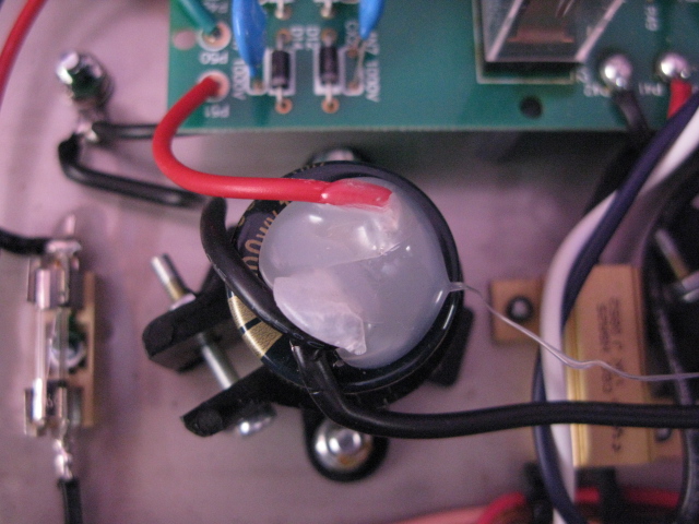

There is something odd I noticed about one of those caps. They have some glue or epoxy thing on them but one of them seems to have cracked & lifted up a little. I've attached pics of them. The Cap1 is the one that has cracked glued thing, the Cap2 looks fine. Is this normal?
Also do I scrape this glue off or heat it off? It seems soft enough to peel with a knife/blade, but it's located in hazardous region

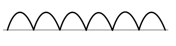

Then for now, you can assume it's post-rectifier noise and no external sources are to blame. 100Hz can be a result of too little/faulty filtering, a non-twisted high current wire carrying 100Hz in close proximity to signal wires, or just bad design. Do you own an oscilloscope or know someone who does? It would help to see what comes out of the PSU.
The 'sharpness' (added harmonics) comes from the fact it's no longer a sine wave. This is what comes out of the rectifier at 100Hz (assuming it's full-wave):
I used to have a OS but not anymore, don't know anyone that has one either. There are no twisted wires that I remember seeing, they seem to be using straight non flexible single strand wires in most places. They are bent at right angles at places but no twisted pair. I'll get a 500V cap first tomorrow and see if adding it in parallel to the one that I attached a pic few posts above helps lower the hum. It's odd to see that glue/gum lifting up like that, there's more of that stuff elsewhere in the board but none has cracked. Also I read somewhere that laney was using TL072 chips that were rated for 50°C , these would overheat & cause hum. Replacing them with 140°C rated seemed to solved the issue. I'm not sure how to check these for specs, but for the time being those would be the last thing I'd consider gone wrong.
