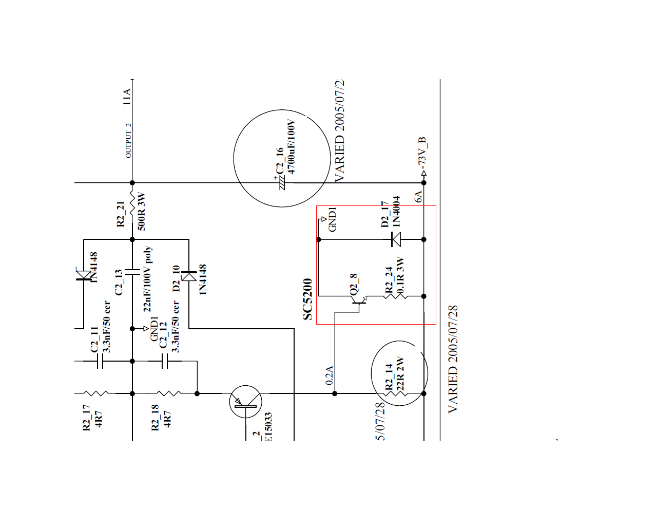

I recently repaired this amplifier. It was shutting down and blowing fuses. I replaced all output transistors, fuses and a lot of resistors which were recommend changes by Manufacturer. Could you please hep me to determine why R2-24 is still causing a problem? I powered amplifier without speakers or input. R2-24 burned in 1 second. I turned of amp immediately.
Check resistor R2_14. It is possible is open. That will make the base of Q2_8 positive. I think it should be negative to disable the Q2_8. To check it remove R2_24 and check the voltage at the base of Q2_8.
R2-14 is definitely open. It was a new resistor yesterday. Thanks for your expertise. The traces are very tiny so I will look for excessive solder and study the schematic to the best of my ability. I would sure like to know what caused R2-14 to burn as well.

Trust me on this, new or not if R2_14 is open then SC5200 is bad. Shorted Q2_8 puts 73 volts right across R2_14. No other path does that can be seen on schematic as posted. Measure ohms between base of Q2_8 and ground to check out the SC5200. Bet you find a dead short.

Thanks so much. Is it possible that I have oversoldered? Otherwise what would cause SC5200 to short? Thanks so very very much. You are really helping me to understand.
From what I can see R2-14 is parallel to Q2-2 (cutoff schematic) I am 90% certain that Q2-2 is bad. I am going to pull Q2-2 and Q2-8 and check them both.
