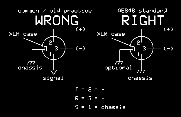

I have an amp that appears to have a separate audio ground for the unbalanced input. The PSU, output boards and -ve speakers are grounded to the main star but the input boards has its own separate ground for the unbalanced input which eventually connects to the main ground via a ground wire to the output boards. The balanced ground connects to the chassis but not at the star point. The amp suffers from ground loop hum on the unbalanced input. My thinking is that if I connect the balanced ground to the unbalanced on the input boards and then rewire the balanced ground to the star point, that may go some way to alleviate my hum issue. Is this correct? I have read this site's article on grounding, btw, which has given me the idea of connecting grounds to a common point.
Any thoughts on this? What would be the point of separating the balanced and unbalanced grounds and not star grounding the unbalanced input immediately?
The balanced pin1 is not an audio ground. It is a low resistance that couples the chassis together. This low resistance path allows leakage currents and mains earth currents to pass between equipment without causing Audio Hum.

Whatever you do, keep the balanced input pin 1 connected to the chassis at the nearest point. Connecting it to signal reference is/was a commonly made mistake known as the "pin 1 problem".

It seems like the unbalanced signal input's ground conductor should follow the signal conductor closely (to make minimal enclosed loop area) and tie to ground only at the grounded end of the input resistor at the first actual amp input stage, and the input resistor's ground reference should have a separate conductor to the main star ground.
Thanks. There is hum from various sources on the unbalanced line but no hum from an unconnected input (not PS ripple hum). I have been using a ground loop cable with a small isolation transformer for now. I suspect the problem is in the sources but just wanted to be absolutely positive. I'll leave the pin 1 ground as it is as I rarely us the balanced line anyway.Whatever you do, keep the balanced input pin 1 connected to the chassis at the nearest point. Connecting it to signal reference is/was a commonly made mistake known as the "pin 1 problem".

I'll add a grounding wire to star at the input resistor's ground for good measure. Thanks for all the help everyone.
