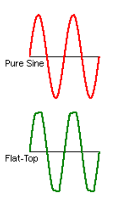

Here is an interesting read! Mains Quality Among other things, Rod Elliott makes two observations. First that the very same dirty AC power that supplying the audio amp will ruin the sound is considered OK to supply the regenerator without affecting the amplified AC signal... The second is more interesting as he proves that the dirty AC results to better DC after rectification than the perfect sinusoidal AC!!!

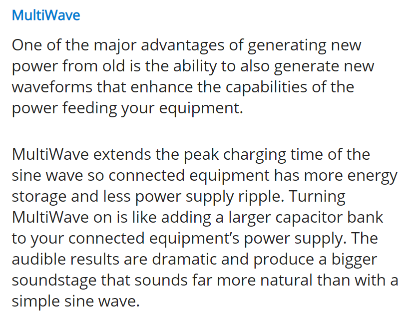

PS Audio, a company that sells AC power regenerators for audio equipment, agrees with Rod Elliott. They've even built a couple of these better-than-sinusoid waveforms into their regenerator. Collectively these alternative non-sine waveforms are called "Multiwave" ; perhaps because "Fourier" was already taken. Here's what the sales lit has to say, Figure 1 below.

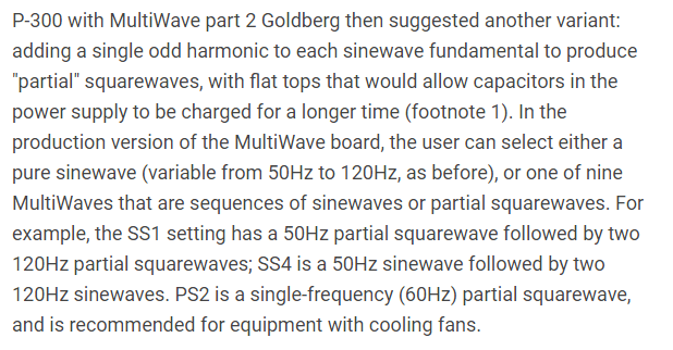

edited a few minutes after posting: I found a review of the previous generation of PS Audio regenerator product, on Stereophile's website. It contains a discussion of Multiwave, and Rod Elliott would be very proud. Figure 2 below.

The main problem with "improved" waveforms is that they need to combine a number of (possibly conflicting) requirements: the peak value needs to be the same as for ordinary mains for usual peak-rectifying supplies, the rms value also needs to be identical, because of "historical" loads and servo/measurement systems based on it, the average value must be equal or preferably lower, to satisfy magnetics components like transformers and motors (traditional turntables for examples), it cannot depart too much from basic trig functions to allow motors to run reasonably smoothly and "roundly", and it cannot contain fast edges that may couple into unwanted paths.
If you build a single-purpose conditioner, you can pick and choose your waveform, but if you need to power a complete audio system with different components, this will narrow your choice, probably down to a single one if you want to be reasonably universal and compatible with various types and generations of equipments, and this single option is....
