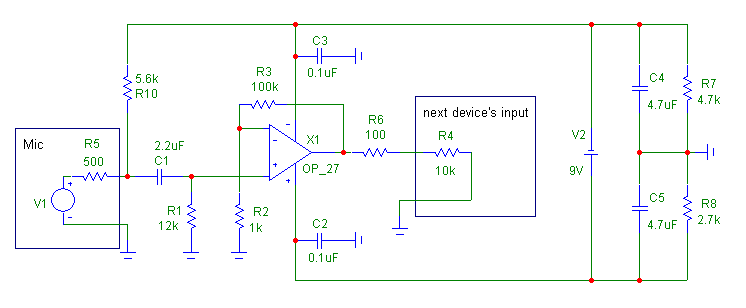

this is half-way a power supply, half way an amplifier problem...
as I wanted to design an easy microphone amp for a single battery but don't like those big electrolytic caps necessary in an op-amp circuit with single supply, I thought of using a dual op-amp:
One channel to split the voltage and to provide the virtual ground, the other to be the mic-amp.
So I simulated the circuit and it seems to work fine except one thing:

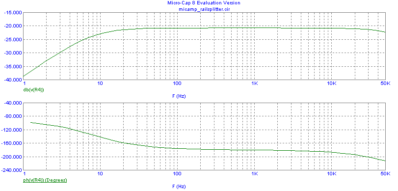

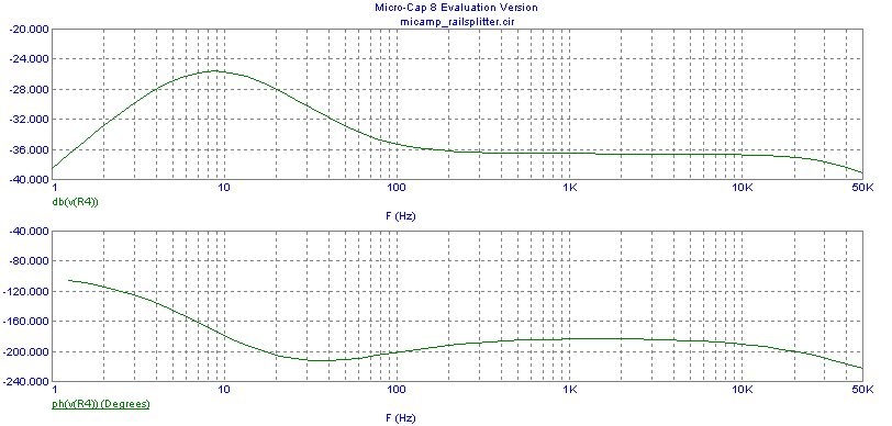

If the output resistors R3 and R4 are both 100 Ohm for example, the whole thing seems to be a filter, the frequency response shows a bump at ... well 10Hz or so and is far from being flat. Also this happens at R3=100 Ohm and R5=10 Ohm ( I played a bit with the values to see how the frequency response would look like), but not for the shown configuration, R3=1k, R4=100Ohm.
Unfortunately I don't see why that is, so my question is:
* Do you see a reason for the "not flat" behaviour?
* How to choose the values / modify something in my circuit in order to prevent those problems.
Please help!
Dominique
PS. Ok, my micamp circuit isn't well made yet, and the "dual" op-amp is named Op27 here 🙂, but that's not important for the problem...

Believe me, you don't need that X1 rail-splitter. Change R2 and R8 to 4.7K, parallel them with 4.7uF tantalum caps, remove X1, the middle point of R2 and R8 is your virtual ground.
The tantalum caps work also as power bypassing for low frequency for X2. Do simulation again, everything will be fine. If low frequency is still not flat, increase the values of the tantalum caps.
Active rail splitters never work in hi-end audio. In circuits that do not drive heavy loads (like this one), two resistors filtered by caps do the job without introducing other troubles such as noise and phase shift. In circuits that drive heavy loads, then use X1 for the load return, and only for the load return.
The problem with active rail splitter
The problem with active splitter is: the power bypassing caps are loads to the splitter. And we all know: most opamps cannot drive capacitive loads.
You have two ples in transfet function- one is internal pole of an op-amp and the second is created by those bypass capacitors to ground C1 and C4. My advice is skip those caps if you want splitter.

darkfenriz said:You have two ples in transfet function- one is internal pole of an op-amp and the second is created by those bypass capacitors to ground C1 and C4. My advice is skip those caps if you want splitter.
Like I said, these bypass caps cause trouble to the active splitter, but the right solution is to get rid of the splitter, not the caps. These caps are absolutely necessary for the opamp.

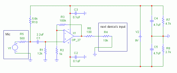

Hi again,
getting back to my previous concerns about that resistor which I forgot in the first schematic:
Here's the updated schematic, but I'm not sure if is it ok with the adapted split resistors...?
Dominique

If my memory serves, the condenser mic consumes very few current, about 0.1mA. Such a 1/10 current will not move the middle point of the splitter.
If this current is large, then you may adjust R7 or R8 to balance the rails. Another way is to connect the - of mic to batt -.
Yes, the mic capsule just consumes 0,5 mA at most, rather 0,25 mA in my case, that's not much!
Now I tested both versions on a breadboard, both worked, but with the resistor virtual ground version I had considerable noise which looked like noise from the power lines. With the dual op-amp version with one channel producing a virtual ground the succeptability to that noise was way lower, so I think about going with that one.
But is there a way to avoid the power supply pin capacitor problem?
Isn't there a way of calculating those capacitors in order to prevent a problem with them forming a pole? Or to push that pole to a region where it wouldn't hurt?

Ok, I understand, but as my mic has just two connections, the mic - should be connected to ground via a capacitor, same size as the other on the mic's positive side, shoudn't it?
