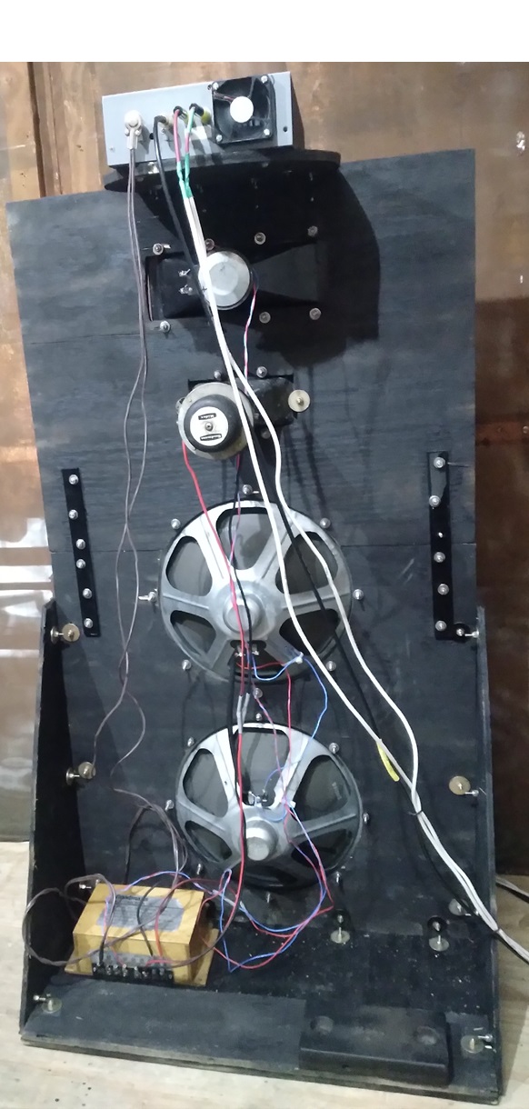

Here's the speaker I am driving with the amp.

That looks like a piezo electric tweeter, basically a capacitor. Amplifiers do not like capacitive loads. So a decent kit will have an output inductor that will help. Speaker lead length should never be an issue unless it is insanely long. A series resistor for a piezo tweeter will also help by raising the cutoff frequency and isolate the amp from the tweeter. Piezo tweeters do need a crossover, they aren't happy being feed a full range signal. If it is dynamic my comments don't apply.

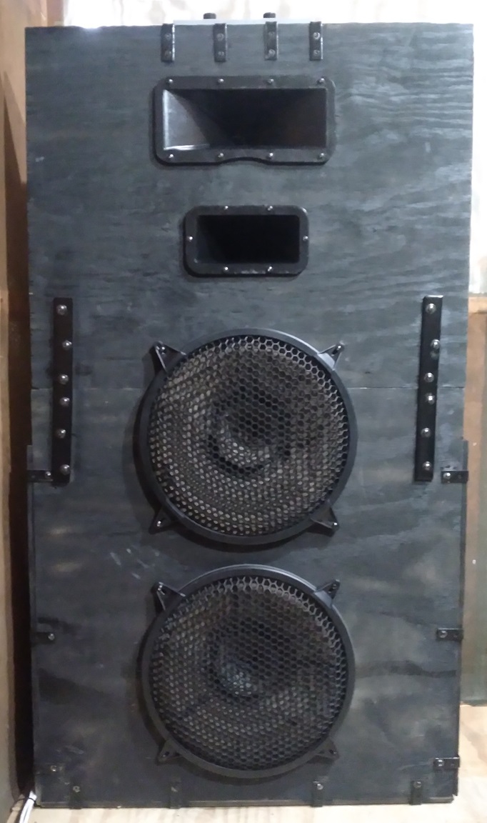

The speakers are:
Two 12" 8 ohm RCA woofers wired in series for a 16 ohm load with zobel network on the woofers.
One 15 ohm Goodmans Midax.
One 8 ohm tweeter from a Klipsch KG-4 speaker.
One Goodmans three way crossover network.

Okay, good.
Those original amplifiers needed an output zobel to stabilize them. An output inductor if they didn't have one.
Yep, something close to 50 watts might be more appropriate. Not to go loud so much, just for the headroom if a good song comes on.
