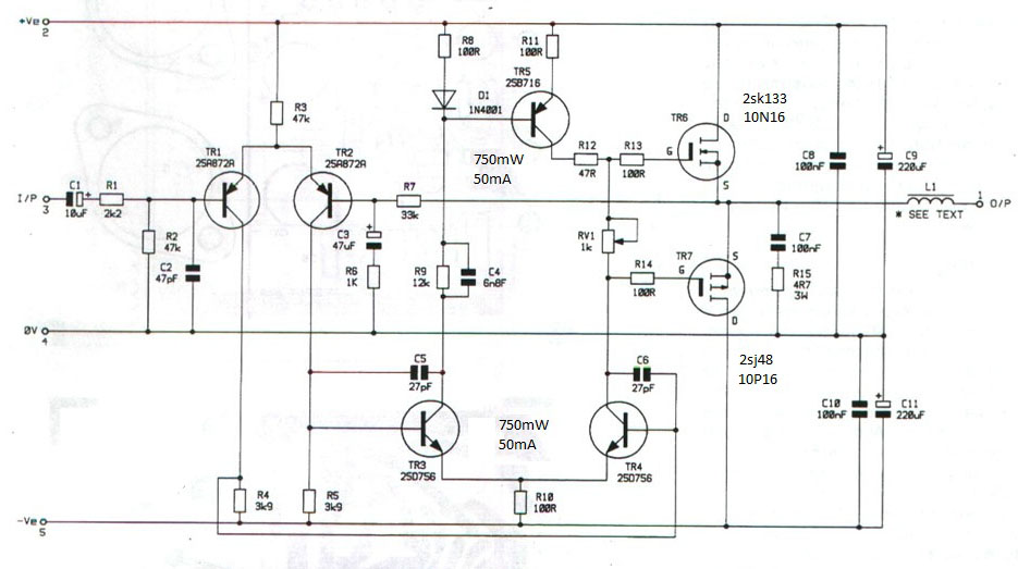

Hello fellow forum would like to know if anyone har Zero sub amplifier, is an amplifier that caught my Atencio.
It is the famous Dr Jacoid
> Output power (RMS) 180W into 8 ohms -------------
> Output power (RMS) 230W into 4 ohms -------------
> Output (music) --------- 220-230W into 8 ohms
> Output (music) --------- 270-300W into 4 ohms
> Check osetljivost/impedansa----0, 6V/47koma (by 200Wrms ohms /
> ----- 7 Hz 112KHz-/-3dB frequency response (to less than 0.01% distortion)
> ------------------- THD <0.003% (a 130WRMS into 8 ohms)
> ------------------- THD <0.005% (a 180WRMS into 4 ohms)
> S/N------------ noise> 95 dB (compared to 100Wrms)
> ------- Damping factor> 300 (in 150WRMS into 8 ohms)

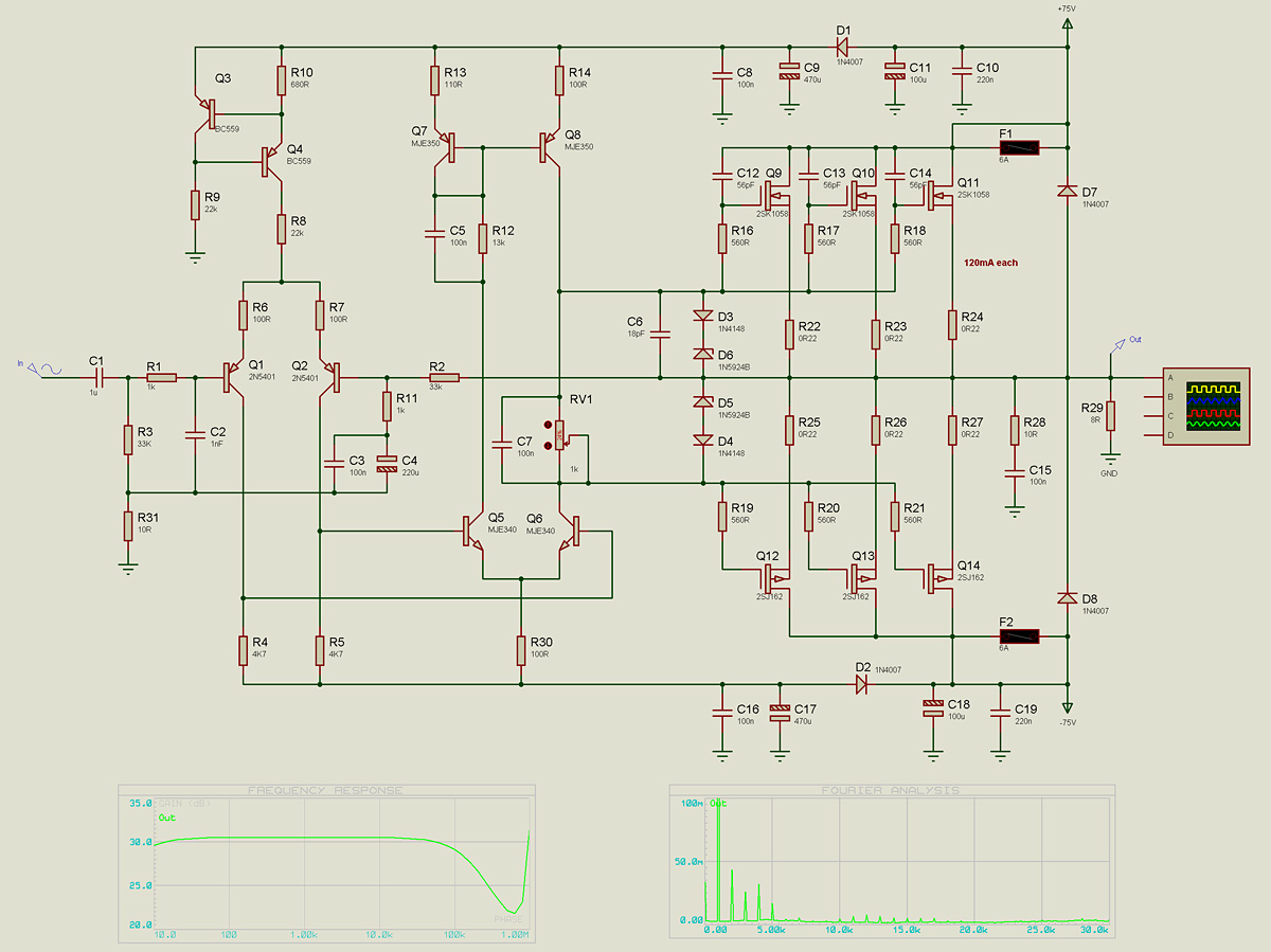

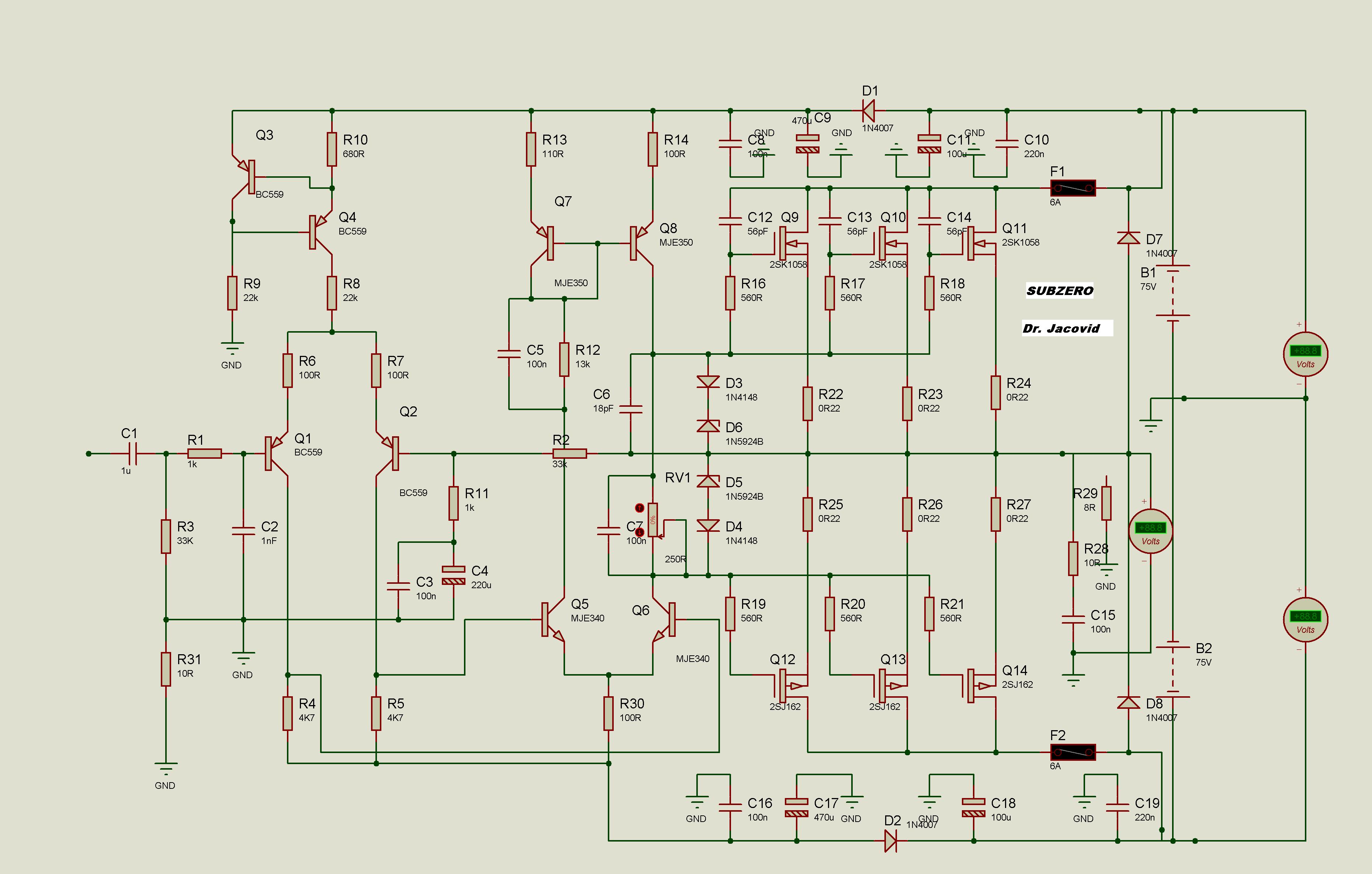

I'm making the diagram in proteus but I'm also good at it when I upload Temin archivo.Para help me simulate

Just saw this thread and thought I could help, sorry its late.
I've had to make some very minor changes.
Hope its what you wanted.
I use Proteus for PCB design and microcontroller sim,
but I find it limiting, something like Multisim is more versatile.
Regards
Edit: fuses are shorted out to simulate graphs, since they don't have proper sim data.

What's the interest? - this design is 95% Hitachi app. notes from >30 years ago.
It only differs in minor details and by using modern LATFETs. Get rid of the sluggish
MJE340/350 and use decent VAS transistors and watch it improve. You will find it
has been simmed by a lot of folks who only just rediscovered it for themselves.

idk, but I just corrected some things, so he can see how to get a circuit to sim in Proteus,
Now he can change things, to any topology.
Maybe IPS and VAS from Apex SR200 with some mosfets at output,
Its similar IPS and Diff VAS structure, just pimped to the max 🙂
Regards
Attached: Just for reference sake, heres a old Mosfet Amp.

You need to have the same Vce on Qs 5&6, and to a lessor degree Qs 7&8. I would change the mirror (Qs 7&8) to a Wilson mirror. This way you can use better matched small signal transistors for the mirror and only need 1) TO-126 device to load the VAS. As for Qs 5&6, you need to add a cascode to Q5, where Q5 collector drives emitter of BJT (or source of fet), base (gate) tied to GND, and collector (drain) connected to the mirror. This will make it so as the average Vce of Qs 5&6 are equal, so then is Pd and temperature rise. Since Vbe is dependent on temperature, if one LTP device gets hotter than the other it will throw off the balance and you want to maintain a balance in the LTP in order to maintain stable DC bias and have a more symetrical transfer function.😉

Thanks looks luxurious VOSTRO I also do not use the Multisim well, so I wanted to help. In your opinion after such a simulation is how much power this amp came with an eight-ohm load.
the bias of each transistor is 120 + milliamps
PS I did the PCB in proteus for I see that I think there is easier to make the pcb in ares
