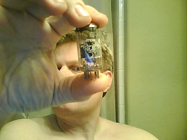

I found 3 of these tubes in a stash of tubes I recently inherited from a pt of mine who passed about a week ago, age 81. May his soul rest in peace. He was a good friend and mentor in building tube amps and such. He gave me about 600-700 various tubes he collected over the years 2 months ago, most of which are fairly common and good tubes or TV type tubes. These three here were found in a box, with 30 or so other tubes, in the garage after he died. His wife called me today and asked me to come over and pick the rest of this stuff up.
I have heard of the Amperex Bugle boy 6DJ8 and that they are almost untouchable price wise. Of course when I looked at these and saw they were the Amperex and 6DJ8 I immediately noticed the little tube man playing what appears to be a trumpet.
Of course you now understand why and what I am asking......are these the famous "Bugle Boy" 6DJ8 tubes???

If any of the white lettering / design rubs off, their value goes to ZERO. HA HA HA!
Honestly, they are good old stock tubes, use them or sell them. It's all relative. It all depends on what you want them for (sound or money).
The fame / notoriety of tubes stems from what somebody is willing to pay for them and write about them in order to perpetuate said myth.
They were well made tubes. Period. Nothing magical about them. Don't feed into the hype.
By the way... I have 30+ of these NOS in original boxes and I don't feel the need to brag about them. Ooops, I just did!
Have fun.

It's impossible to know without seeing the internal construction. For instance, I have a pair of "Made in Germany" Amperex 6922's that are actually made in Hungary by Tungsram and rebranded.

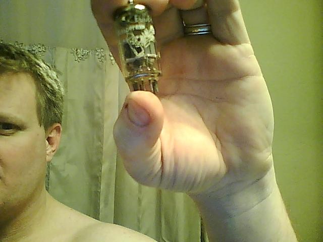

Well, I guess I should have looked at eBay first. There are some of these Amperex Bugle Boy 6DJ8 tubes listed for fairly reasonable prices and others are off the charts ($300 for a couple or so tubes). Is there anything particular that makes some of these tubes more valuable than others or are the sellers just insane?

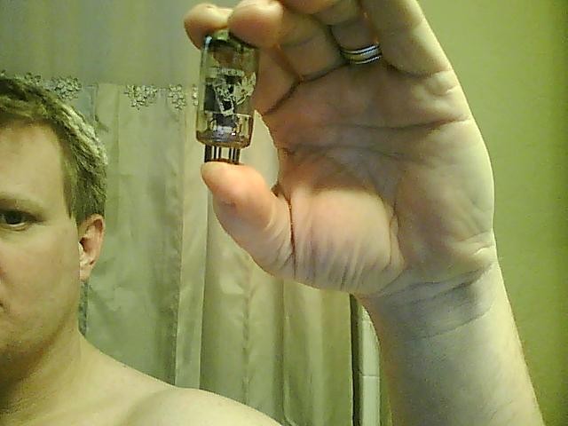

What I do know about 2of these 3 is they are NOS, probably from the 1960's. the other one appears to be slightly used but tested the same, about 105-110. I know he hadn't bought a tube in over 30 years so that makes them at least 30 years old. They were also manufactured in Holland. the used one has a "D" getter, the other 2 are "O" getters. The pins have some gold tone to them but are not solid gold.

Amperex tubes are typically made by Philips*, what are the 3 letter codes near the bottom of the tube.
*(my tube guru says, "Amperex never built a tube in their life" althou i understand that before they were bought by Philips they did)
dave
dave
Philips bought Amperex of Hicksville, NY in order to qualify as a supplier to "Uncle Sugar's" DoD.
FWIW, Hicksville made 7308s are well regarded. Prices for those "bottles" have skyrocketed, like those of other desirable NOS 6DJ8 family tubes.

As for Ebay sellers... The ones that start out an auction for 99 cents and let the demand dictate price are the good guys. The sellers that put up 2 tubes with a starting buid of $300 aren't insane; they're just greedy pigs. If you track such auctions, rarely do they get a bid (depending on what tube they are selling), which makes me question if these sellers REALLY want to sell what they have. There is a lot of psychology that goes on with different selling methods used on Ebay (once in a while, an insane buyer will buy those two tubes for $300). The sellers in the know, that know the value of what they are selling just let demand dictate price.
As for NOS tube prices... Like I said before, hype is what dictates most of it. The funny thing is that a lot of NOS on Ebay actually isn't; it's just a term that catches bidder's eyes.
You have good tubes in your possession. The value of them WILL NOT go down. If you sell them now, you will probably get a good price for them. If you sell them down the road, you will get an even better price for them. Old stock just keeps getting rarer and fetch higher prices.
I have sold many old tubes on Ebay for crazy prices, but I really wish I had held onto them as the prices they would go for now are from double to 4 times what I got for them. In the future, they would have gotten even more.

BTW, the letters at the bottom (somebody asked), well there are 2 I can read...looks like an R and and F. There are also 3 numbers at the bottom "011"
Need to know where they are showing up in the codes... the top line of 3 is the change code, the 2nd where they were made, and when.
Mullard, Philips, and Valvo Tube Codes
