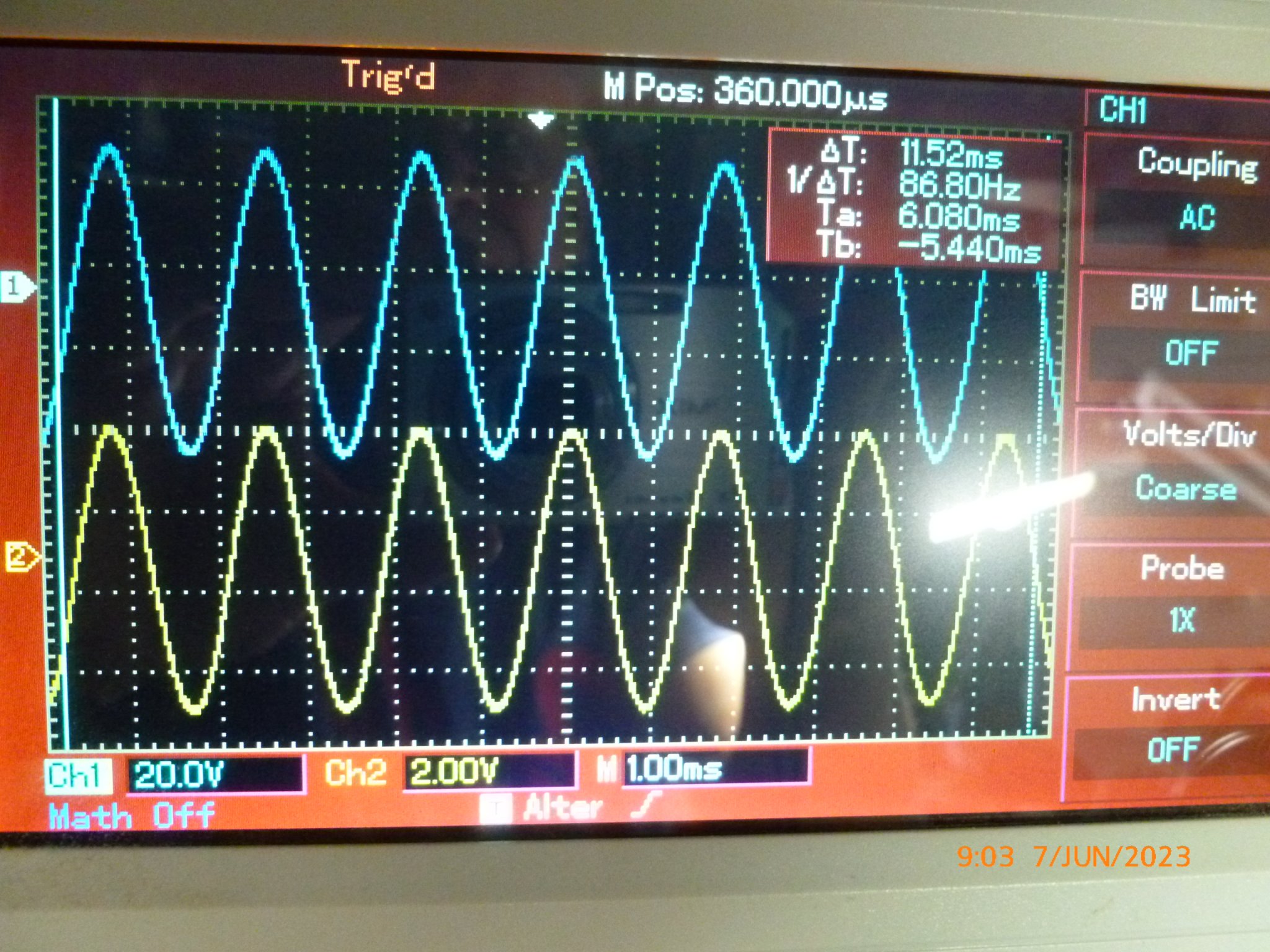

OK here some pics

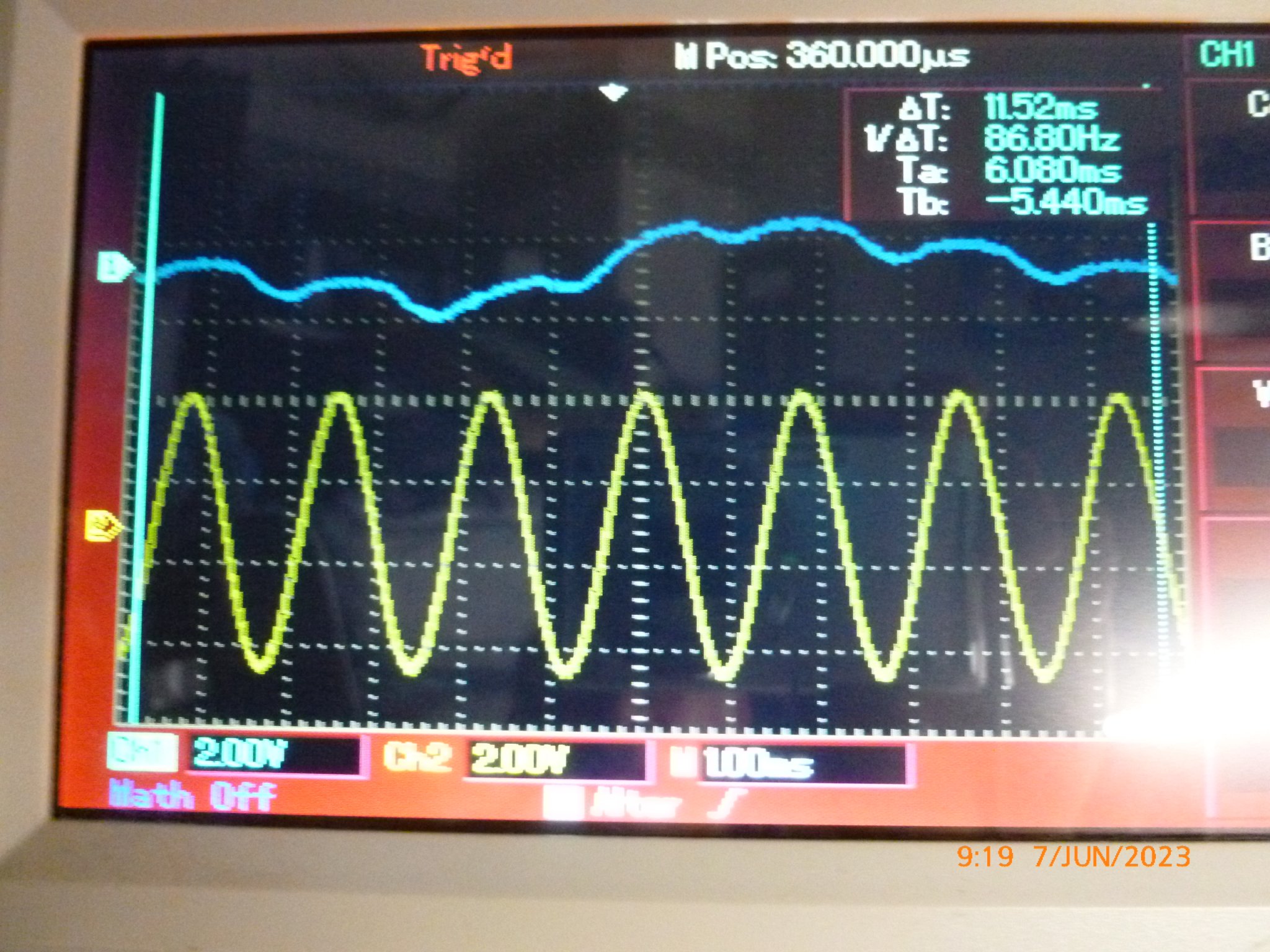

Pic no. ending650 Blue trace is collector of Tip 142 Yellow acoss dummy load

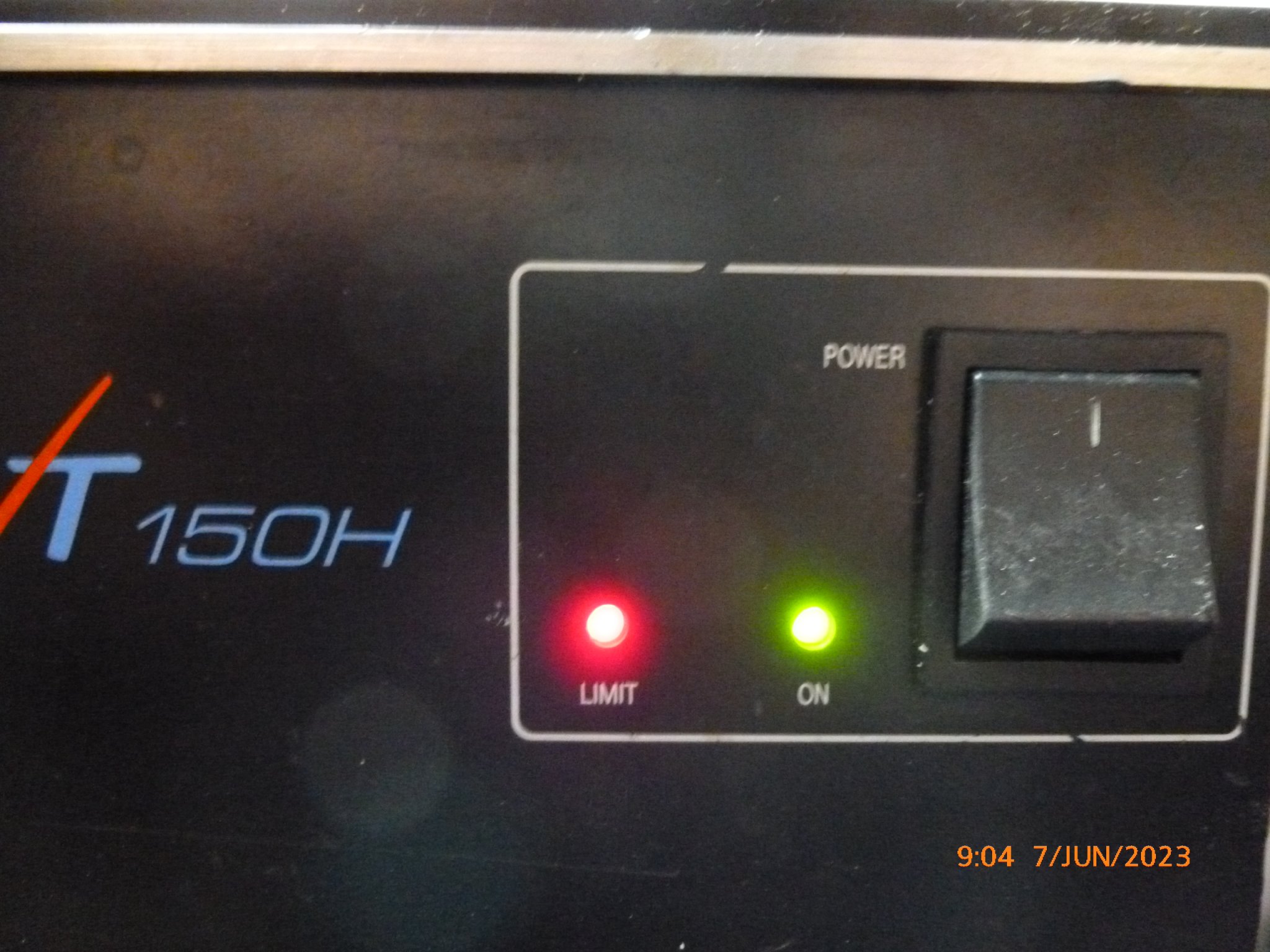

649 limit led

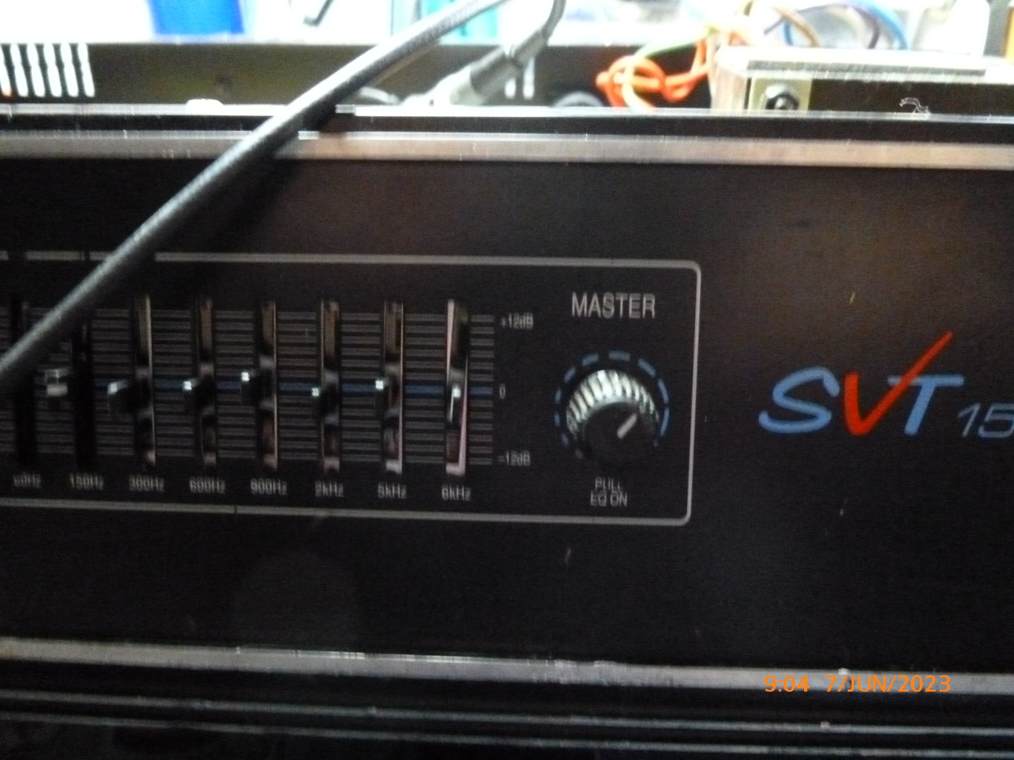

648 master vol. and pull for EQ

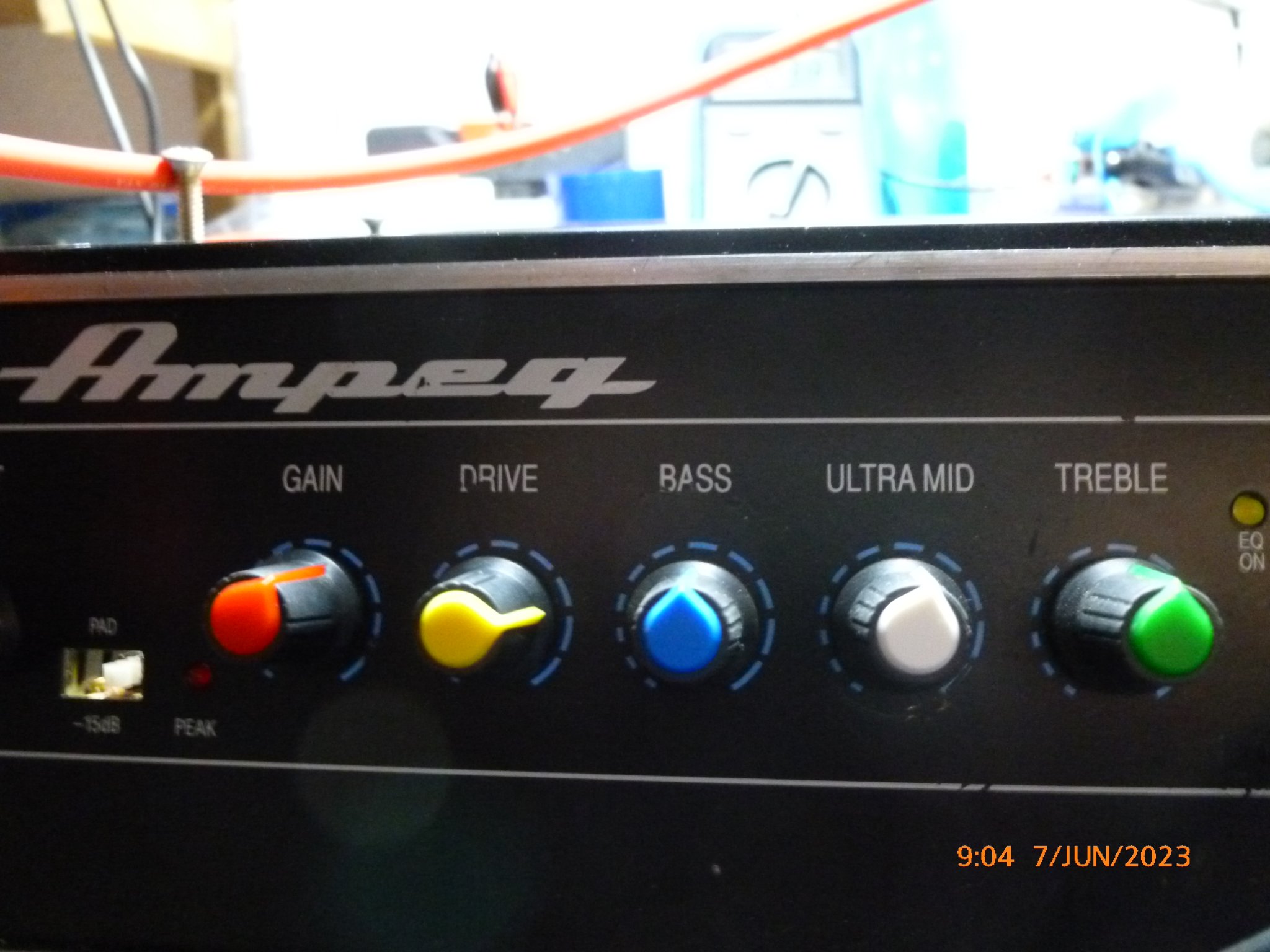

647 knob settings

645 Blue trace base of TIp147 Yellow across dummy load
649 limit led
647 knob settings
646 volts across dummy load which is 8ohms

limiter light is on at 23.8 volts
sounds about right , about 140 watts if it was 4 ohms.
but louder makes outputs blow...hmmm.
