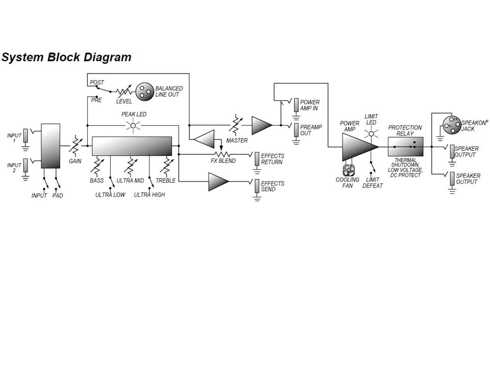

First off thanks for any help you can offer. I have a Ampeg B500DR bass amp that won't get put out any bass guitar sound. When I turn up the volume the fuzz gets louder but no signal output. There is a relay I was tapping on and after a few taps I resistor in the power section fried. I attached the block diagram but could really use the schematics if anyone out there has them.

Well, if your speaker or wires are not messed up, (test above) check to see if there is DC coming out of the speaker hot terminal on and idle. If so, one or more output transitors are bad. Then if none of that, check your power supplies that they are about 80% of the capacitor rail voltage. Checking rail voltage while playing into 4 ohm resistor (watt rating >amp rating) would be a better test.
The speaker and wires are good. The weird thing is when you turn up the volume you can here it increase but nothing from the bass guitar comes out.
I’m having the EXACT SAME Problem out of my B500DR. I can plug into the power amp out and get sound....but if plugged into the input it cracks and pops....but you can tell the power section is working.

I’m just trying to figure out why my head puts some sound, but won’t put sound out that I’m able to jam with.

You have some problem in the preamp section. It will be a matter of troubleshooting. Apply a signal to the input and follow it through the amp to find the point it goes no further.
