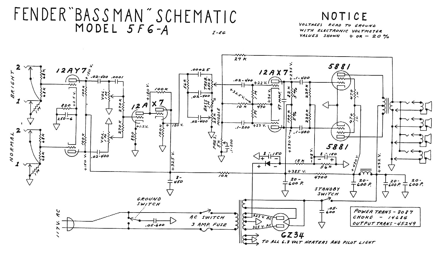

I'm a bass player - electric and double-bass, mostly jazz. I have a Selmer Treble n Bass amp which needs rebuilding, and I was wondering about changing the circuit to a Bassman (pretty close already) or maybe an Ampeg B-15. It will go in a combo with a 15" speaker.
Right now the circuit has 12AX7s and EL34s. I rather like the idea of the 1964 Ampeg B-15 with 6SL7s and 6L6s.
What would you do? Thoughts.....?

It has to be the Fender using 6L6CG output valves. I favour 6SN7 for phase splitter and driver stage but ECC83 is fine. 5U4 works well as rectifier.

Tell me more - much more! I build audio tube amps with DHTs usually, so quite experienced though not an EE. I have built with all the common tubes in an audio amp and a lot of esoteric DHTs. 6SN7s are nice - a more neutral sound than 6SL7s which are more fat and warm. I'm thinking that could be good for a double bass, where warm and fat with nice sustain is a good jazz sound.
What about the output tubes? I have EL34s at present. 6L6s are less greedy on the heaters. What to expect in terms of sound and output?
I'm also debating fixed or cathode bias for the outputs. The Ampeg B-15 was rated 30w with fixed and 25w with cathode bias.
Why the Bassman over the Ampeg circuit?
The Selmer is a bit toppy, the Ampeg is nice but won't go down as low as the Fender. The Bassman has a better response at lower frequencies and tends to make nice warm sounds. I would use fixed bias only because more power is available and agree 6SN7s are a great valve the 6SL7 is a bit peaky. Excellent for double bass if there is enough iron in the transformer.

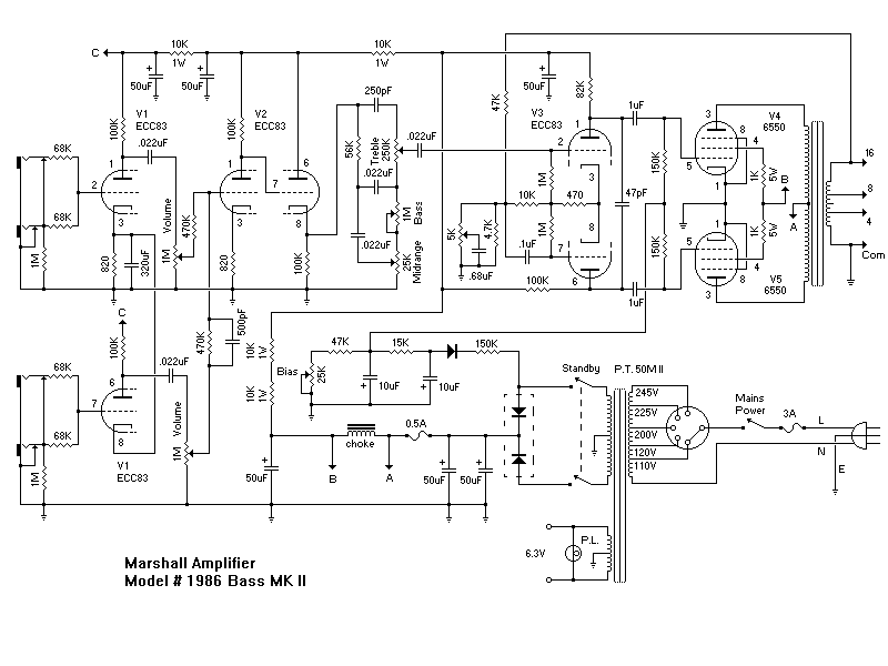

What about 6550 tubes? As in Marshall 1986 Bass Mk 2? The much loved Ampeg SVT used 6550s. My OPT is designed for EL34s, however, and I believe 6550 has a higher Ra

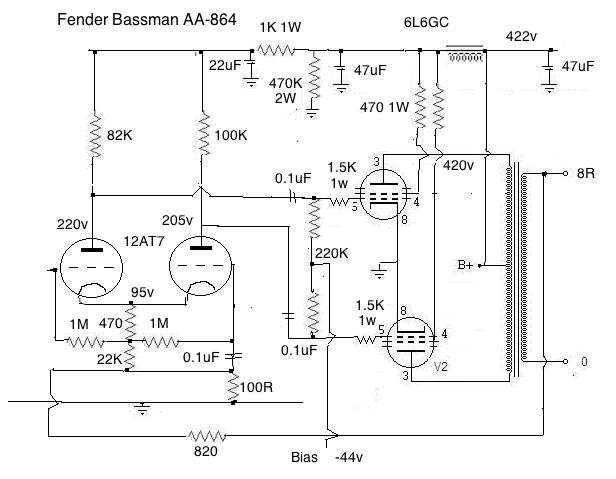

I've been drawing out various circuits to try to get to know them. I'm liking the output stage of the Bassman AA-864, which has a 12AT7 phase splitter. I have a bunch of 6N1Ps, and I always liked the full sound they give. So thinking of substituting a 6N1P for the 12AT7. Should be fairly straightforward allowing for the socket change and increased heater current. Incidentally, is the feedback resistor 820 in this? It's illegible.
