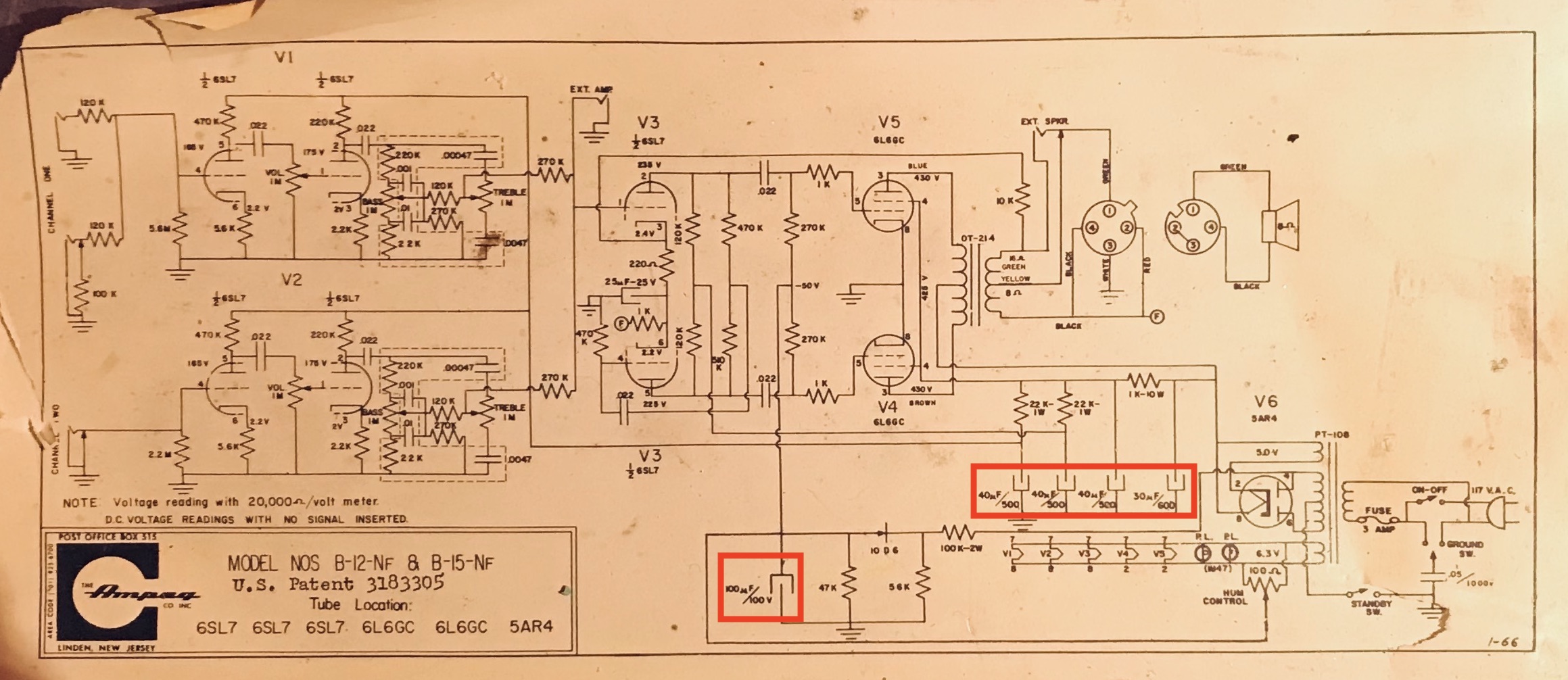

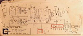

Ok,
so i replaced the 5 capacitors (marked red below),
and there's a noticeable improvement, thanks a lot for this !
but still, when i increase the volume i still get the same, but quieter, noise.
anything i can do to further improve it ?
thanks again !
Fred

i would clean or replace the extension speaker jack (common fault due to corroded contacts).
the only other caps i would replace are the phase inverter output caps the .022's.
is the feedback resistor off tolerance?(10k from output transformer secondary) while your at that try replacing the cathode bypass cap in the phase inverter (25uf 25 v)
