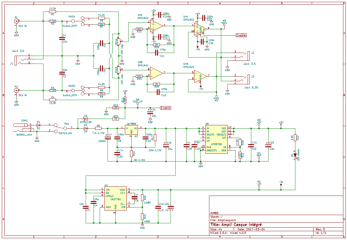

About the schematics:
Regulators:
Ampcasq was designed in September 2016, at this time LM27762 was announced but not available. So, I did stay with LM27761 for -5V and LP38798 for +5V; LP5907 was a bit short on current. The 7805 lifted by R17/R12 was added to limit LM27761 input voltage to 5.5V, its max value. 7805 allow Ampcasq to be powered by any DC source from 10V to 35V, 300mA max.
Power Input:
D1 to protect against bad connection.
D2, R23, R10, R11, C24 to manage the Enable pin of the OPA. Objective was to avoid noise in the can at power up/down. This partly works: mute the output when enable Low (<~0.8V) but can’t avoid noise in can when power supply capacitors are discharching and OPA1622's supply getting out of tolerance. On power off with SW1, OPA1622 is muted as C24 is quickly discharged through R23, D2 and SW1. D2 is a Schottky, not for speed but for low drop (Vf close to 0.3V).
Crossfeed:
It is based on an Xen-Audio (EUVL) paper: Xen Audio cross feed.
There’re three positions for the switch: Low Xfeed – No Xfeed – High Xfeed. Low Xfeed is Ok, High is exaggerate: there’s too much bass boost. After some listening sessions I finally do not use the Xfeed.
Gain + out
Not much to say.

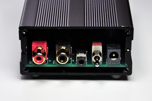

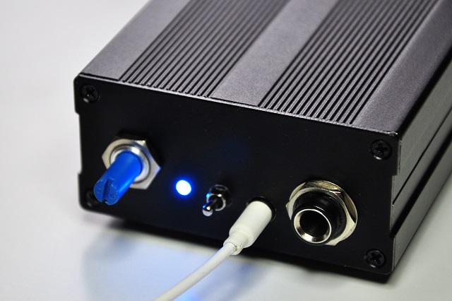

Some pictures
It's mostly finished, but a (very) important thing is missing : a nice volume button 🙂

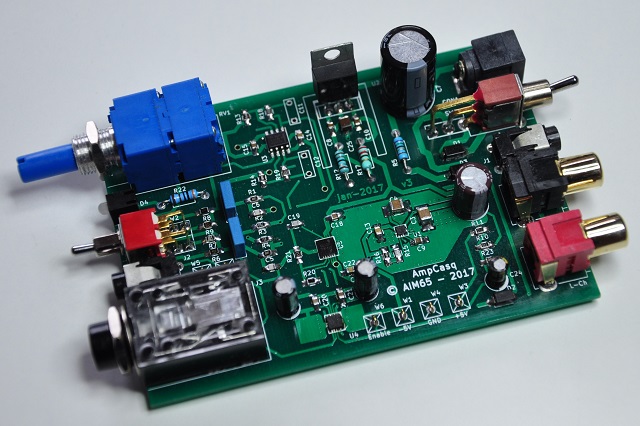

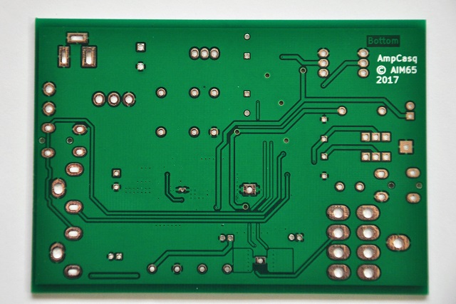

Right, I had hum issues with the first version of pcb, then I spent some time on the ground plane and now it's dead silent.
Lm27761 is very sensitive to ground, I've spend a lot of time on it, now it as it's own ground plane on component side and it behave very well up to 200mA.
Thanks for comments Sergey888.
To be honest I wasn't planning to do a high end headamp, only to go through all steps of project in order to have a finished and usable headmap, and also something I could share on DIYA.
Decoupling caps of OPA supply has been choosed to provide good value for price : nothing exceptional but Pana FR for ecap and Murata for the 100n MLCC Y7R 50V, 805 form factor. At 5V bias this cap is at 100% of its nominal value. Murata does publish the full specs of its capacitors on its website this is very useful. They’re located as close the chip as I could imagine being able to weld them…
I’v done some measurements with a scope with various load, they’re consistent with OPA1622 datasheet. It drive 32R paralled with 1nF up to 3.1Vp, while staying stable and it operating a cool temperature. Heatsink made in PCB is enough.
You’re right, so does nigelwright7557, layout is perfectible, I’ll keep that in mind for the next project !
Improving it does not mean that you need to spent tons of $$ on part - you just need to add and properly place a few fairly cheap components.
First of all 100nF caps have rather high impedance to really do a lot. It is necessary to provide a local low impedance path for at least high-ish audio frequencies. Something low-ESR around 220-470uF would be capable of doing it. And the reason for that not that much of a creeping signal products through a finite PSRR (also this is also can be a limiting factor) but inductive coupling supply rails, that caring highly distorted current, to signal lines. The longer those lines are - the more likely you'll get a trouble because of it. It is not the greatest idea to let them flow to the power supply.
The difference i'm talking about is not something you'll be able to see with a scope.
Have a look on some of my measurement results. On this level i managed to achieve something like 3-4dB improvement just by moving caps closer and keeping signals line further from supply.
http://www.diyaudio.com/forums/head...buffer-headamp-based-opa1622.html#post4703047
I dropped a huge clanger when I made a similar circuit.
I hadn't kept the power supply ground separate from the audio ground and got massive hum. I had randomly mixed in power supply ground with audio ground.
The power supply needs to be on its own on one corner/side of the pcb.
