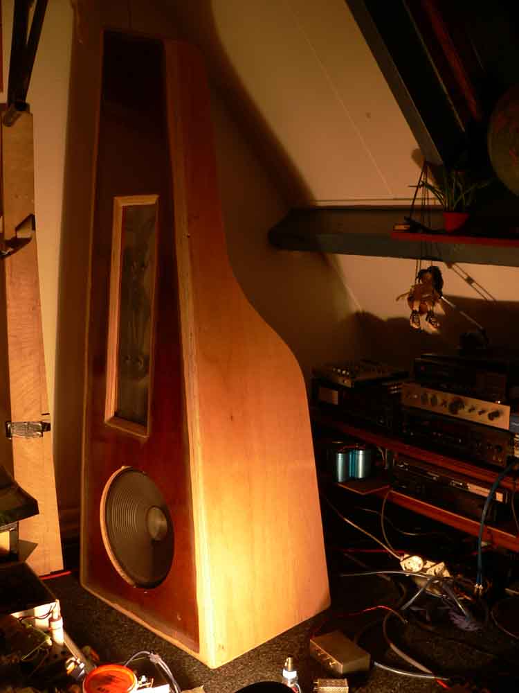

About Tripath amps driving capacitive loads, I drive electrostatic speakers with AMP9, but I've read about people driving fullrange ESLs with AMP5.....

Ah, hi Reverie 🙂 really, the capacitance of a speakercable will be in the range of pF or nF max. especially at 2.5 meters...😎
An ESL produces a capacitive load far beyond that value...I think most amps can handle Cat5e as in 'not break down'...only down sides can be filtering effects...(highpass=loss of bass....)
