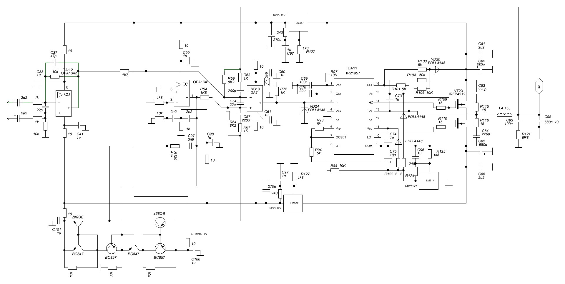

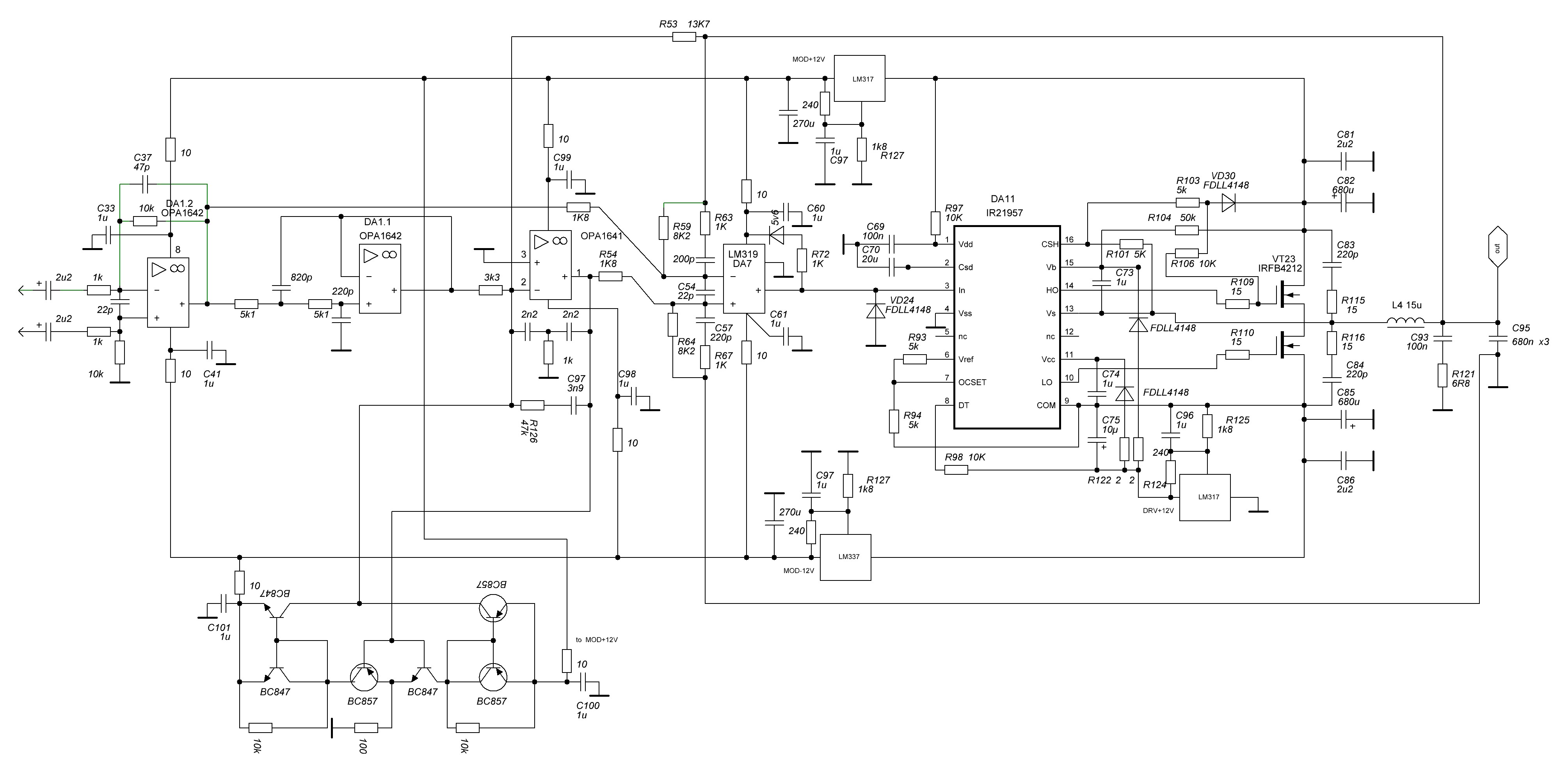

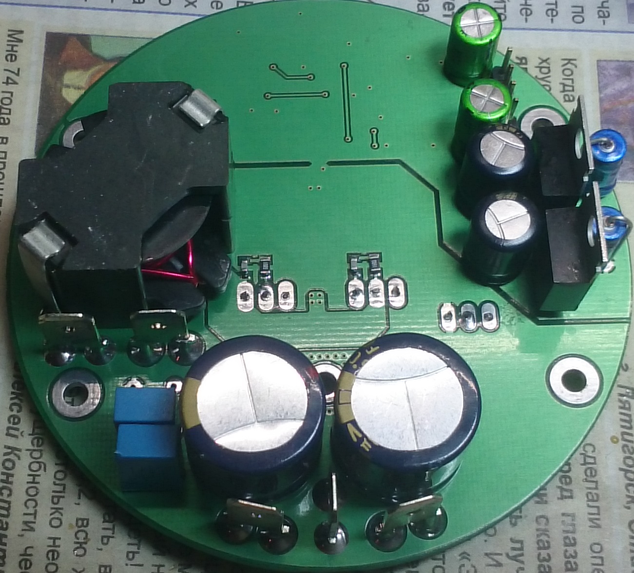

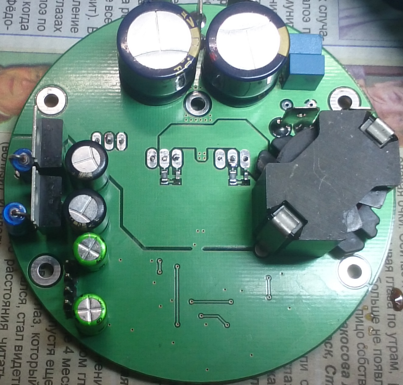

Amp using idea from Kemp's paper.
Main idea -UcD based amp add integrator - we obtain low distortion.
I draw a full sheme later.

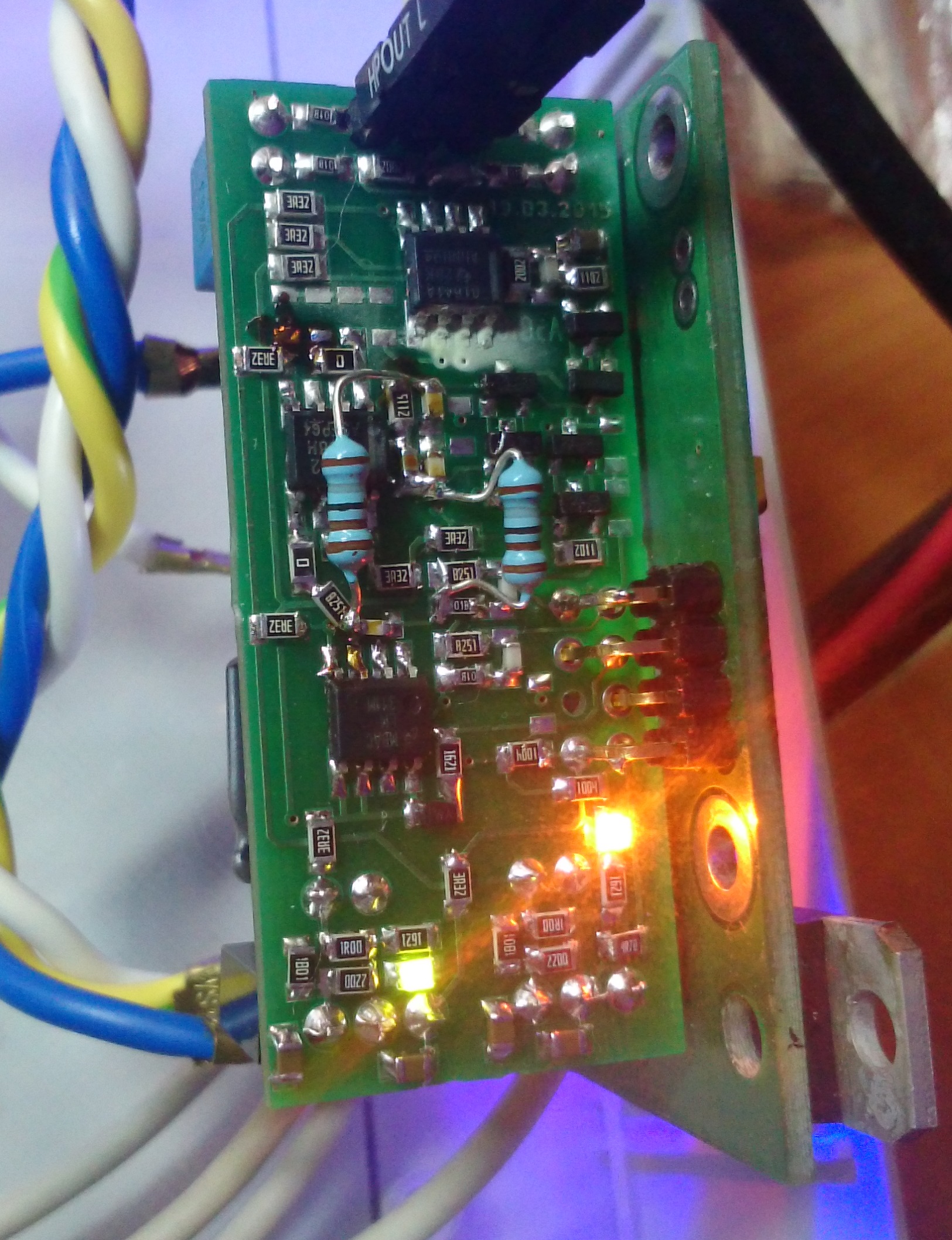

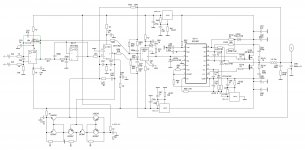

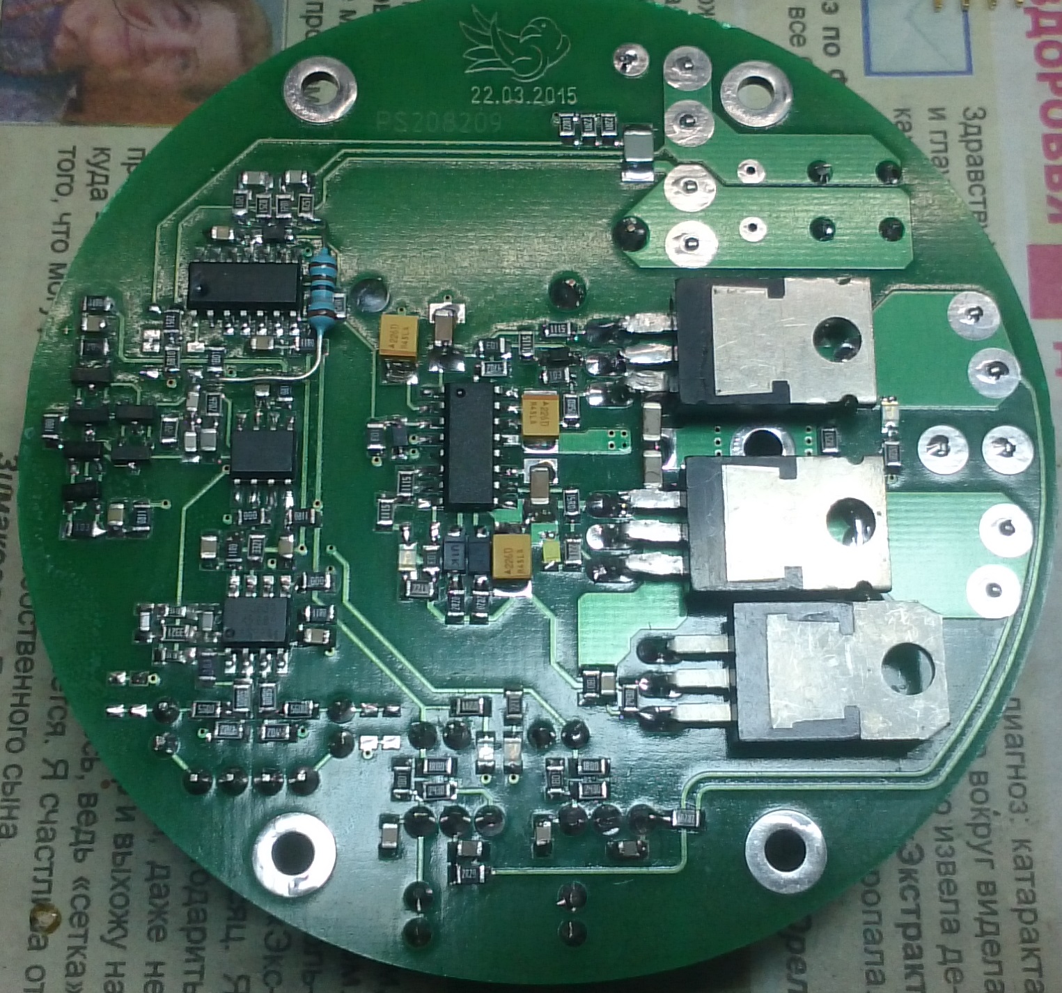

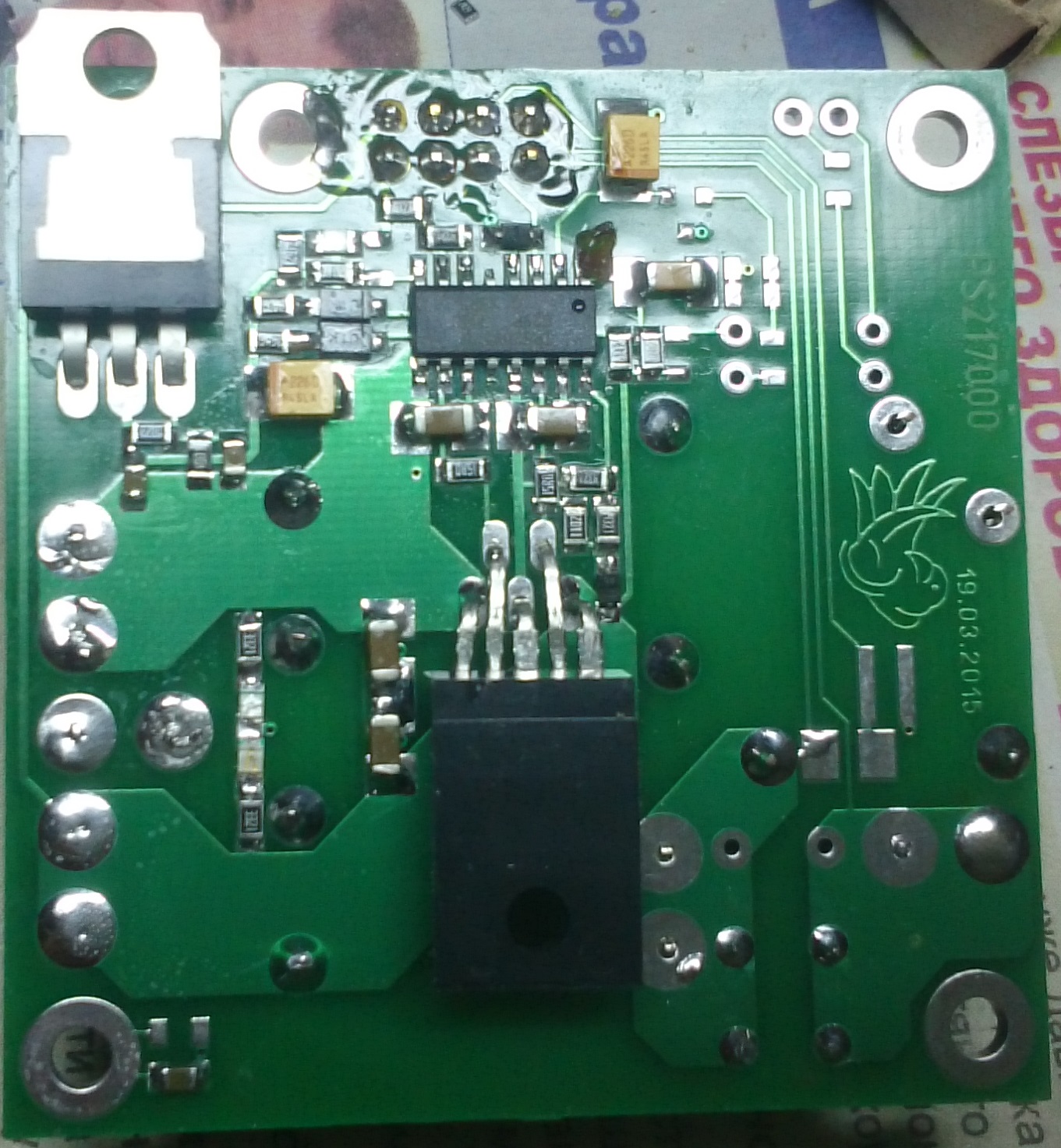

Another amp used integrator. Sheme and PCB. RU forum.

Thanks for your willingness to share. I am looking forward to read more details.Main idea -UcD based amp add integrator - we obtain low distortion.
I draw a full sheme later..
In general I think your solution is a promising trade off to reach high performance at reasonable complexity.
...seeing your design and also the vegalab forum, I feel that knowing the russian language would enable me to read threads with pretty valuable content...

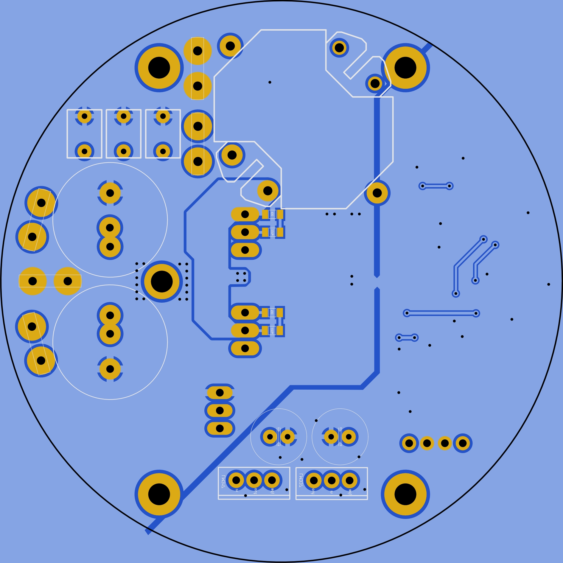

Gerbers?
Not needed from my side. All relevant layout information is visible in your pictures. And when building, then I always love to roll my own designs.
I am more interested in the schematic + design considerations behind.
Also in chosen component values + why exactly these values had been chosen, while often multiple other parametrizations would be possible as well....
But I do not want to push you to publish things that you prefer to keep with you.
Basically it is clear how a marriage of Abletec and the Kemp anti saturation circuit or even other anti saturation circuits will look. Inspiring topic.
It is up to you to publish more or keep it with you.

Many thanks for sharing!
😎 Your integrator is not just a simple integrator like shown in the
Abletec drawings, but yours is higher order.
I' ll have to dig deeper into this approach!

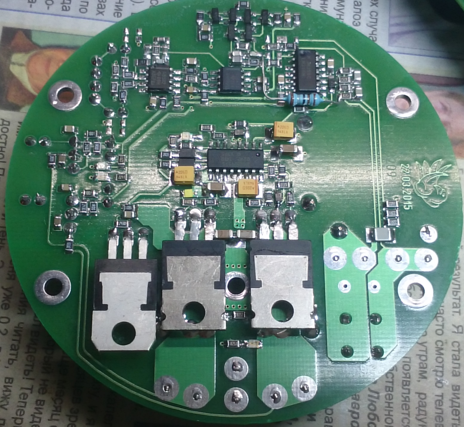

wow really beautiful layout, NCore inspired. 🙂
This sematic diagram - simple idea from Kemp paper.
Abletec even easier.
...true... mixed up some connections in my brain, when I looked at your schematic the first time.
Nice way of summing the integrating gain to the UcD.
Better / less demanding for the OP amps compared than feeding the entire UcD feedback through a PI or PI².

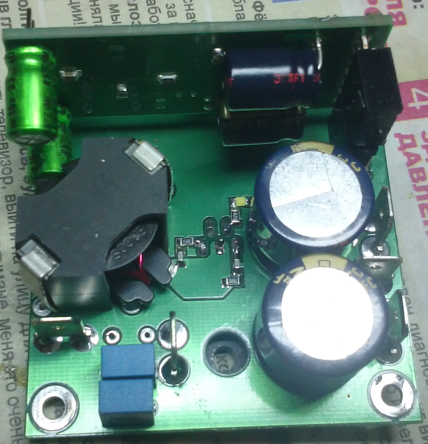

How about your other amp, the one which uses the Abletec idea?
