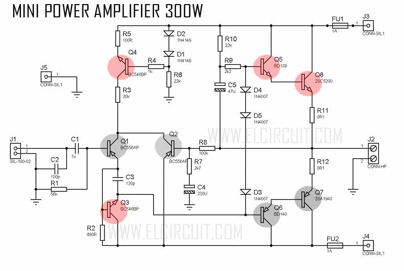

Hello to everybody,
I would like to build up really good and simple amplifier. I guess that original Toshiba 2SC5200 and 2SA1943 are good (even I have more sympathy to Sanken).
Is here something that should be improved? I am quite obsessive about THD and S/N ratio..

Is this the amplifier ?

I'm not going to be a jerk and call it trash. I will however suggest that you look for something better to build. What your interested in is NOT a 300 watt amplifier and I would suggest something with a better design and certainly a more robust output and driver stage. To be honest I have seen better designs in commercial amplifiers than the one your interested in.

Hello Burnedfingers, yes, I thought his answer was ‘simple’. Sorry I was not more detailed: I’ve found the scheme here Mini Strong Power Amplifier – 100W RMS | Te1
I’ve found lots of schemes, sadly, I cannot decide which one is simple and really good. What I know it should has output 70-120W max.
I'm not comfortable with a single pair of the TO-3 plastic case outputs. Several pairs of the outputs would be much better. To be honest there are better amplifiers out there to build that will sound and perform much better. Two pairs of the outputs would probably be safe for a 4 ohm load.
Seriously I would look for something better.
The schematic attached is terrible. The input stages are complete nightmare. The BC556 will smoke if they will be connected as there mentioned. The current regulator based on BC546, should be pnp as well, as it connected to the positve rail. The 20kohm resistor on the collectok of the ccs will saturate it (ccs try to generate 6mA, which means 120V drop on the 2kohm resistor)
What is the function of Q3?? It's acting like 6-7V zener depending by the breakdown voltage of the B-E diode of the BC546.
There will be large offset on the output as the totally different bias resistors on the input stage.
Anothe issue is the large crossover distortion on the output stage, because of the 0 bias...

Cerafully checking the pcb, I found, that it will work.
The LTP is OK on the pcb, even wrong in the schematic.
The ccs (Q4) will not work, but there will be current to the LTP across D2-D1-R4-(BE diode of Q4)-R3, it will be around 2mA. So simply R3 would enough to the positive rail.
Q3 is OK on the pcb, even wrong in the schematic. Anyway it will be close to the limit, so I would use stronger.
The output offset will be high, and the crossover distortion will be terrible.
Sajti

100W output with a single output pair is possible if those outputs are MT-200 ones, like 2SC2922/A1216 from Sanken, but even in that case, they are rather stressed at full swing.
