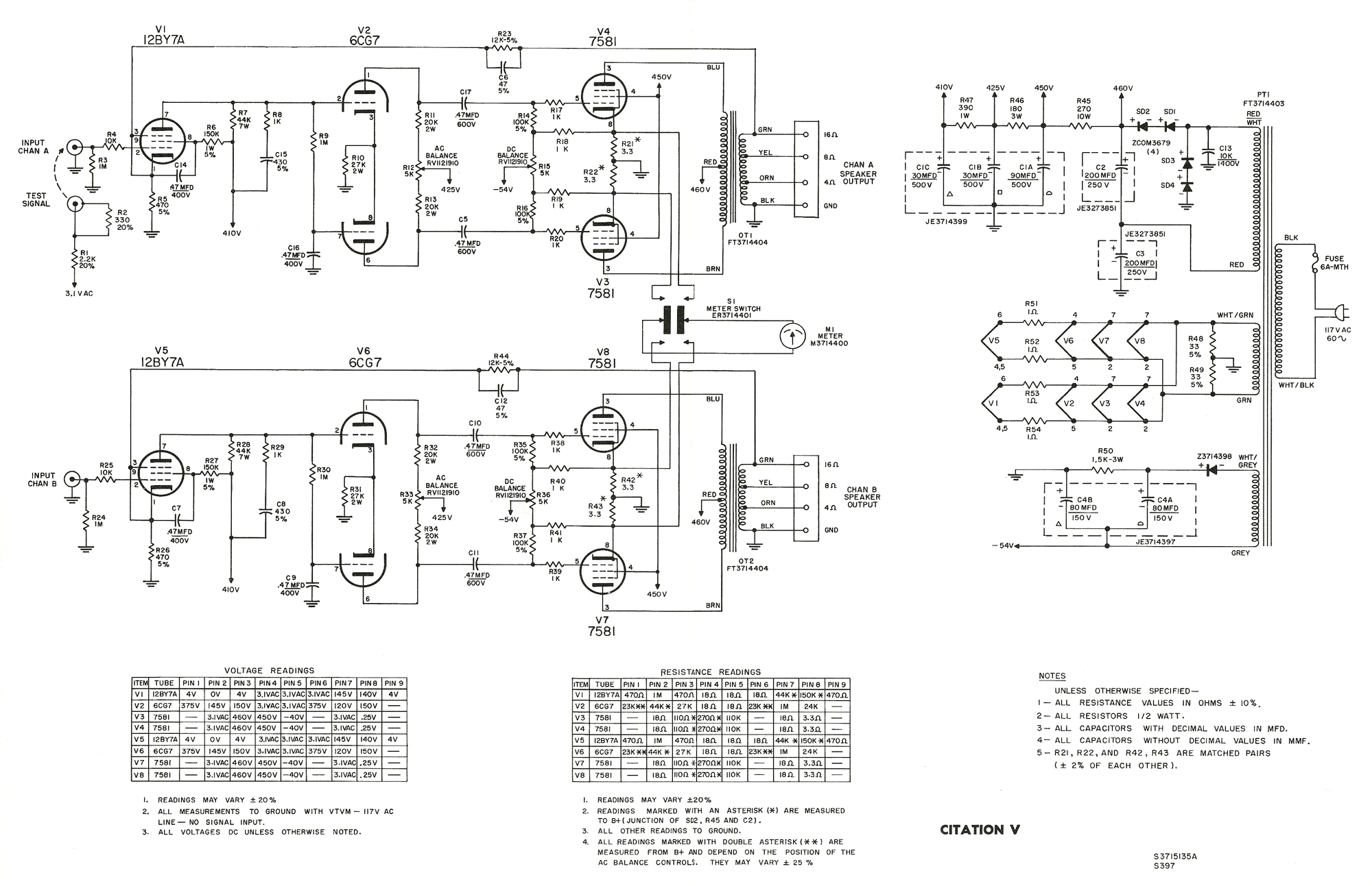

PP KT88/6550 "finals" get you 60+ WPC. Mullard style topology is "idiot resistant" and that's what I'd use. The H/K Cit. 5, with its high gm small signal types, is a superior implementation of Mullard style and (IMO) is an excellent place to start.

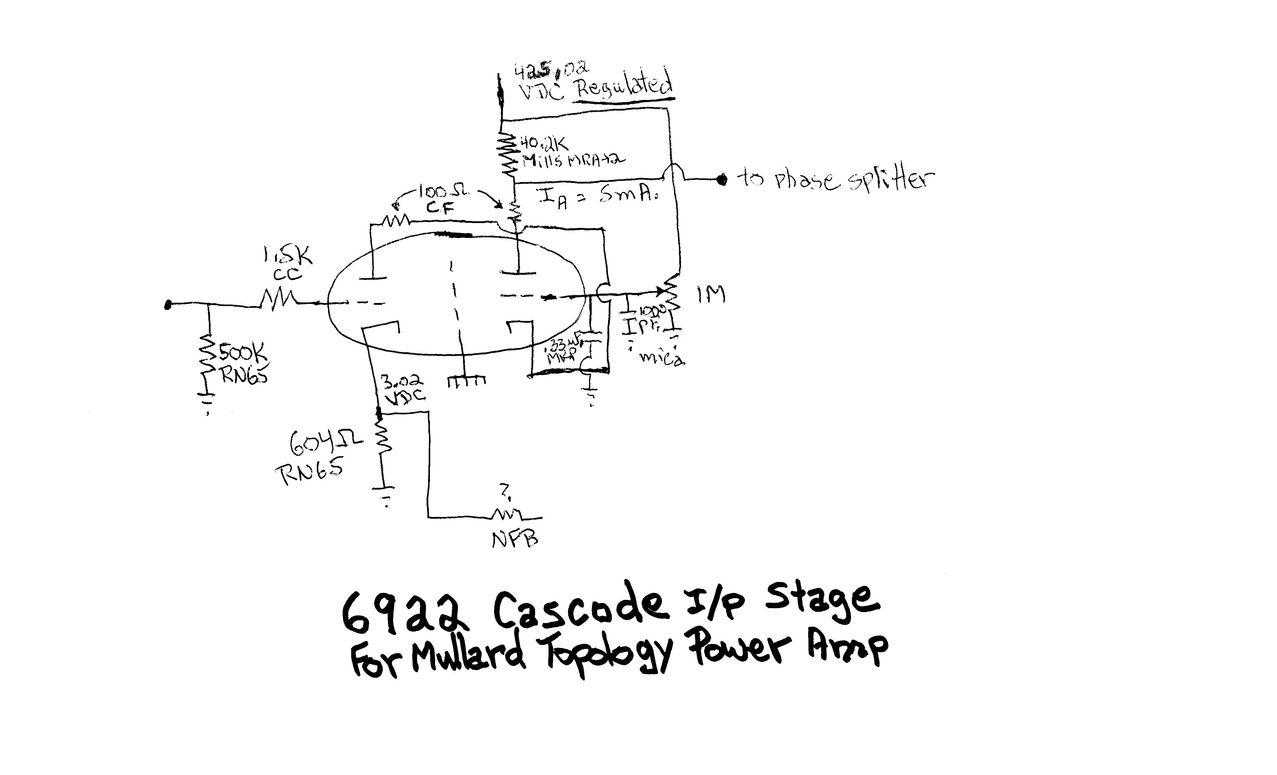

12BY7s are getting scarce. A 6922 cascode is provided as a substitute high gm voltage amplifier. CCS loading the LTP tail and, perhaps, an ECC99 as the LTP are incremental improvements of something pretty darned good in its original form.

Magnetics are costly and represent a major part of the cash outlay in building a tube power amp.
Mullard style circuitry is known to deliver satisfactory results, when "iron" that is not the very best is employed. With that in mind, I suggest you look at Edcor's model CXPP100-3.3K for a KT88/6550 build. Solid, if unspectacular, performance is what you get. Edcor is an excellent value.

Truly spectacular requires "iron" that's not available for a new build. Among the very best amps, ever, is the Harman-Kardon Citation II. The Freed magnetics in the "Deuce" are pure gold, but you have to cannibalize an amp to get them. That's (IMO) vandalism. 😡 Now, a project of acquisition and refurbishment of a H/K Cit. 2, ala Jim McShane, has my complete support. No, you can't have my "Deuce". 😀 I'll part ways with it, when "dirt nap" time comes.
The Cit. 5 is the "little brother" of the Cit. 2 and doesn't bring the rear up by much. McShane is on record stating the "Five" will slightly out image a "Deuce", but (all around) the Cit. 2 is the better amp.

Mike Maida wrote a seminal paper on high voltage regulation. Read it. A very nice recent implementation of Maida's concept can be found here. Tom C. is a member here at DIY Audio and a lengthy thread discussing his work can be found in the archives. Tom's PCB will easily feed 4X KT88 screen grids.
A visually appealing g2 regulation strategy is stacks of gas discharge regulator tubes. They will consume valuable chassis space and come in Octal and 7 pin mini packages. FWIW, I favor this approach in combination with "12" W. types (not big, honking, KT88s) where both voltage and current requirements for g2 B+ are modest.
Power supply rejection ratio (PSRR) is essentially non-existent in cascodes, which is why I call for regulated B+. However, VERY well filtered "juice" is an alternative. Stopping a buzz at 2X the power line frequency is the target of these machinations.
