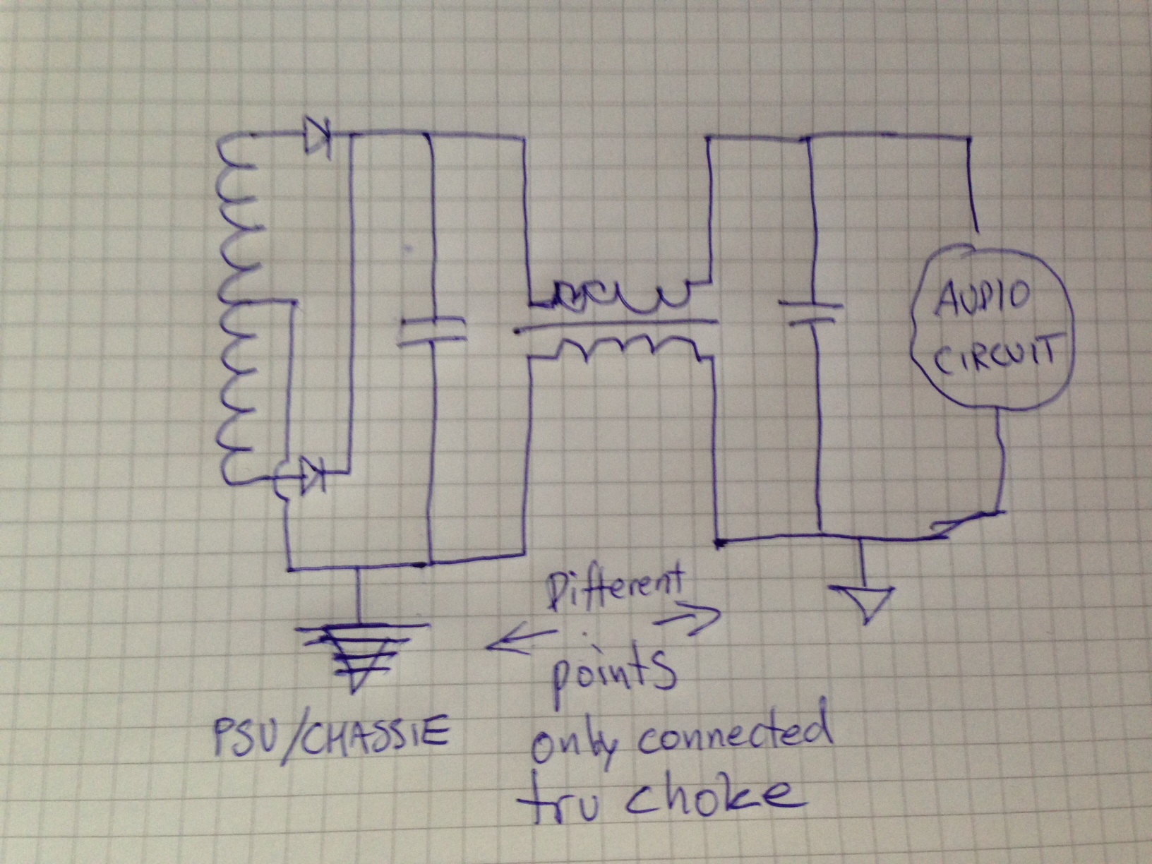

Has anyond here tried common mode chokes and connect second C bank to audioground instead of PSU/chassieground?
clarify ; there are several possibilities , according to your question(s) and some of them are BS and some aren't
in a meantime , look at this thread (sch somewhere down) : http://www.diyaudio.com/forums/solid-state/161663-nem-ai-50-a.html#post2091636
As always
That was a hybrid amp w 2 PSUs with common mode choke input to the sand part.
I was just thinking cap input, then common mode choke and separated ground stars.
as always (and I'm always saying that ) - GND is state of mind
your drawing is proper addendum to your previous post ....... and I have no objection
ZM rests his case and I lift my hat. Would you have tried toroid CM chokes by any chance, the ones usual in switched supplies, or are they made for choking higher freq noice? I'm merely after to blacken out the ground noice, spikes etc from rest of apartment gadgets.
