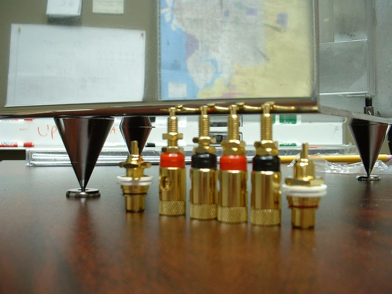

WOW! Nice Work!
Hi MantramAudio,
Very, very tasty!! Where did you source the fantastic looking conical feet?
Cheers
Jon
Hi MantramAudio,
Cheers
Jon
