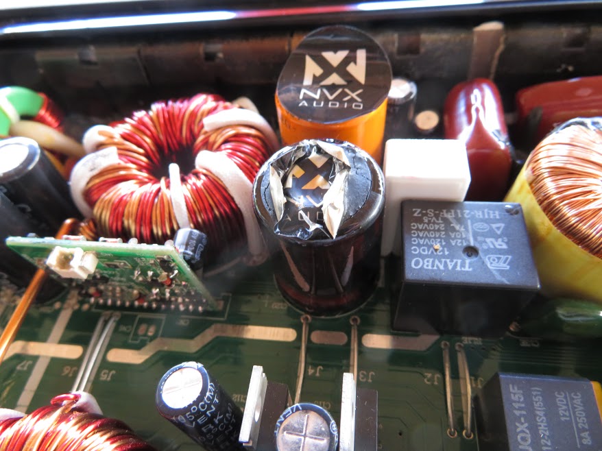

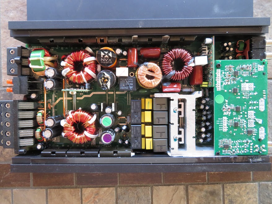

I cracked it open and it didn't take long to find the likely culprit. One of the large capacitors is fried. So bad that I can't read what's printed on it in order to get the correct replacement. Fortunately there's another one next to it that appears to be exactly the same. Hopefully replacing the fried cap will solve the problem. I wonder if the other identical cap is for the subwoofer channel and that is why I never lose that channel. If that's the case, is the other cap possibly a different value? Another question, why would it work intermittently if the cap is that fried.

Rarely is the cause of the issue readily visible with electronics. There will be more to this rabbit hole than the obviously damaged components. Remove or replace the damaged cap and see if the problem persists. Do you have a way to power the amp and diagnose the problems other than just visually?
I disagree. I have repaired several TVs with only visual inspection looking for bulging caps. I have saved hundreds of $ and prolonged the life of some TVs that were headed to the landfill. I believe that this amp will fall under this category of a visually blown cap. It's definitely possible that there's something else wrong, but I'm betting the blown cap is the problem. We shall see.
That resistor next to the relay and capacitor runs very hot. I've seen them melt the relay.
The capacitor doesn't really look damaged. The adhesive from the label looks like it got hot. I expected to see the amp filled with paper fibers from the capacitor exploding.

I do have a way to power the amp outside the vehicle (Jumper Cables and wire) but no way to diagnose otherwise. A friend of mine is an EE and willing to help, but other than that, not much. He works at FLIR where they build infrared and thermal cameras, so someone there might be capable of diagnostics. I'll replace the blown cap and see how it goes from there.

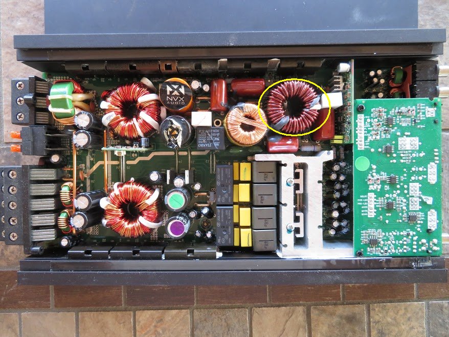

I found some notes that stated that the output filter inductors sometimes intermittently short. Circled in photo. Do you see any chafing where the terminal windings meet the rest of the windings?
The relay in this one is much smaller than in other, similar amps. It could be a weak point.

The capacitor doesn't really look damaged. .

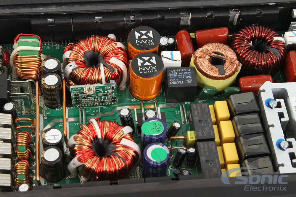

I disagree. The capacitor is completely black whereas the one next to it is bright orange. They are the same cap. The stock photo shows what it should look like. You need to look at the second photo where you can see the side of the cap. Totally black.
I'll look at the winding tho.
That amp looks like it has duel power supplies. They might be be in parallel, or independent and running different channels of the amp. So its possible one set is getting shut down and the other is not. I have some trouble shooting videos that might help, and one series is a 5 channel amp that has duel power supplies (the Arua amp). YouTube
