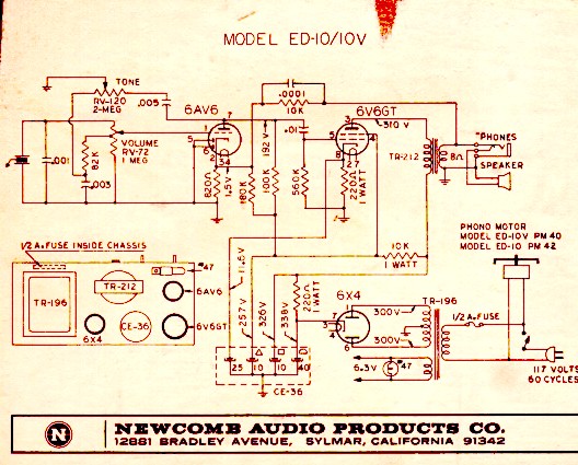

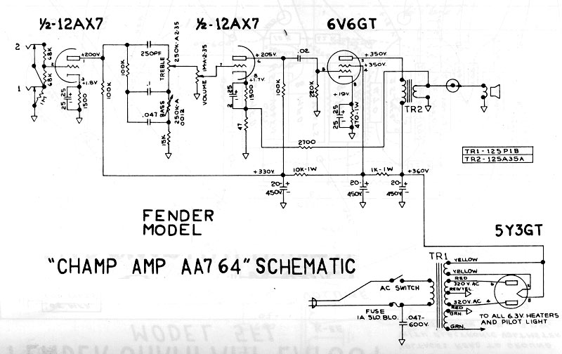

V vlljpior Member Joined 2004 2004-10-28 3:21 pm #1 2004-10-28 3:21 pm #1 Hi, how can i modify this amp to have 2 stage preamp ? can i use 12ax7 insted of 6av6 ? how can i put a tonestack ? Attachments 6av6.jpg 92.3 KB · Views: 162 C Centauri Member Joined 2003 centauriaudio.com.au 2004-10-28 4:09 pm #2 2004-10-28 4:09 pm #2 What will the input source be? Cheers V vlljpior Member Joined 2004 2004-10-28 4:27 pm #3 2004-10-28 4:27 pm #3 that will be a guitar. C Centauri Member Joined 2003 centauriaudio.com.au 2004-10-28 4:34 pm #4 2004-10-28 4:34 pm #4 Here is schematic of old Fender Champ Amp - probably what you need. Cheers Attachments fenderchampamp.jpg 69 KB · Views: 130 Status Not open for further replies. Share: Facebook X (Twitter) LinkedIn Reddit Pinterest Tumblr WhatsApp Email Link
