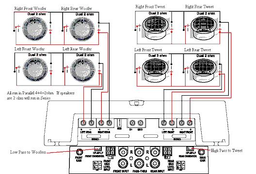

I'm attaching a .bmp of what I picture the install to look like. Questions:
Does it look right, or am I smoking the good stuff.
Are there any concerns associated with running the amp power outside the cab (pass side-through the floor, along the frame and up the firewall)
Lastly, I'll be stuck with the factory HU for about a month and would like to go ahead and install the rest is there a high input (factory speaker wire) to RCA converter so I can run everything.

First off the components you listed are 4ohm's each. I would not recommend running your power wire under the cab of your truck. Either find a hole in the firewall or drill one yourself. The item you are looking for, foryour speaker outs on your head unit is called an loc (line out convertor). It can be purchased @ any sound shop. Hope this helps
I am located in Baton Rouge. Where are you at? Does your components have built in xovers? If so you need to use them. Your wiring diagrahm will give you a 2ohm load. Running it like that will cause your sound quality to go down.
Leesville. No built in xover. I thought about wiring it that way so I can mount the tweets in the a pillar up front (bouncing off the glass) and the top of the door panel in the back doors. Also that diag. allows me to use the amps xover (less pieces/splices, less resistance). Then again I'm no expert, hence the reason I need help.
