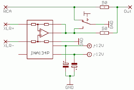

I was wondering how I could do XLR/RCA input switching for my amplifier.
I suppose using a simple switch is possible, but I'd like some sort of circuit that leaves the switch out of the signal chain. I've got no problem with an extra opamp though. Is there any way to do such a thing or not?

Just connect them in parallel and use a shorting jumper or switch to connect IN- to ground. Since only the ground connection goes through the switch, I think this is fine.
This is how Pass Labs does it (jumpers).
Hi,Devil_H@ck said:...... but I just thought about this and wondered if it would work....
In your schematic active input is loaded with only 100ohm what is unnecessary low. Also, inactive input is shortened to ground what also isn't good.

Ah well, I guess I won't use any switch at all. I guess I'll be smart enough not to connect 2 input signals at once to my amp 🙂.
