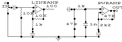

To illustrate the issue I've included a typical block schematic for a typical capacitor coupled scenario. Because there are feedback coupling C's to ground both loops derive their bias from the uotput for their -input while their + inputs source theirs through the input resistors. For DC bias equality these are made roughly equal.
Note as well the 1K and 1nF input filter, setting -3dB at 160KHz. This is common to filter RF pickup and above audio band hash from getting into the power amplifier. It's effect is less than 0.1dB down at 20KHz. However, it's values can be crucial!!!
Once I was consulting to a well known company in the US whose 'chief' engineer had 'designed' his first product - a re-hash of someone else's competent earlier design. It was horrendously hummy - so much so that part of the production and specification final inspection regime was to rotate the two internal toroidal power transformes to obtain some hum cancellation. But it simply wasn't good enough for the Japan agents who used high efficiency speakers and weren't happy. He had no solution despite repeated meetings triggered by the agents repeatedly faxing graphs of the resuduals and they weren't going away! I had a quick look at the schematic and it was glaringly obvious. That input RC filter had been set at 4K7 and 220pF! This raised the input impedance at the first transistor to 4K7 and it was susceptible to hum pickup even when connected to a low output impedance preamp. I had the production engineer change one to 1K, 1nF and test it. Their residual hum immediately dropped by 14 dB!!! He was happy he didn't need to swivel transformers in production, the Japan agents were happy. The 'designer' was gobsmacked.

Hmmm (no pun intended) that aspect had not ocurred to if only because I've always used a much lower (120R-200R) value on the input RC. Athough that wasn't my motive, it keeps it an order or two of magnitude below the the other elements contributing to input impedance.
The whole question arose for me when trying to drive an amp with a PC soundcard. The soundcard was very unhappy until the impedance was ~30k ohm. I didn't feel like slapping a 30K resistor into the nfb just to make a soundcard happy.
Actually I don't feel like modding the amp at all, so the most probable solution will be a unity gain buffer running off a battery.

My amplifiers invariably use JFET front ends so 47K is no trouble and I standardise on it. My soundblaster live drives it fine.
With the RC input filter, you need to be careful that the C is not too large if your source impedance is large or unknown like off a pot! That could really roll off the high frequencies. With 1nF even a 10K pot will be around -1dB at 20KHz at centre.

The output resistance of a 10K pot at the center point is 2k5 Ohms. The 1nF capacitor has ~ 3k3 Ohms of impedance at 50KHz ,so the roll off at 20 KHz , will be much greater than -6 dB. 😉

Yes the centre of a 10K pot =2.5K to ground with one end earthed and the other at the low Zout of a preamp. This 2.5K forms a pole at 63.6KHz (i.e -3dB) with 1nF and the amp input is off the 1nF so it receives MORE at 20KHz (i.e. a low pass filter).
In fact at 20KHz, Vin/V = 20log (Zof1nF/Ztotal)
put simply, at 63.3KHz Zc =Zr =2K5
at 20KHz Zc = 63.3x2K5/20 = 7K9
or just considering the ratio of frequencies 63.3/20 = 3.18
so Vin/V at 20KHz = 20log(3.18/sqrt(1x1 +3.18x3.18))
= 20log(3.18/3.33)
=- 0.4 dB
Even if including the 1K in my illustration, the pole of 1nF and 3K5 is 45KHz and response is -0.775 dB at 20KHz.
Hope that helps. Your calculator may need new batteries.
