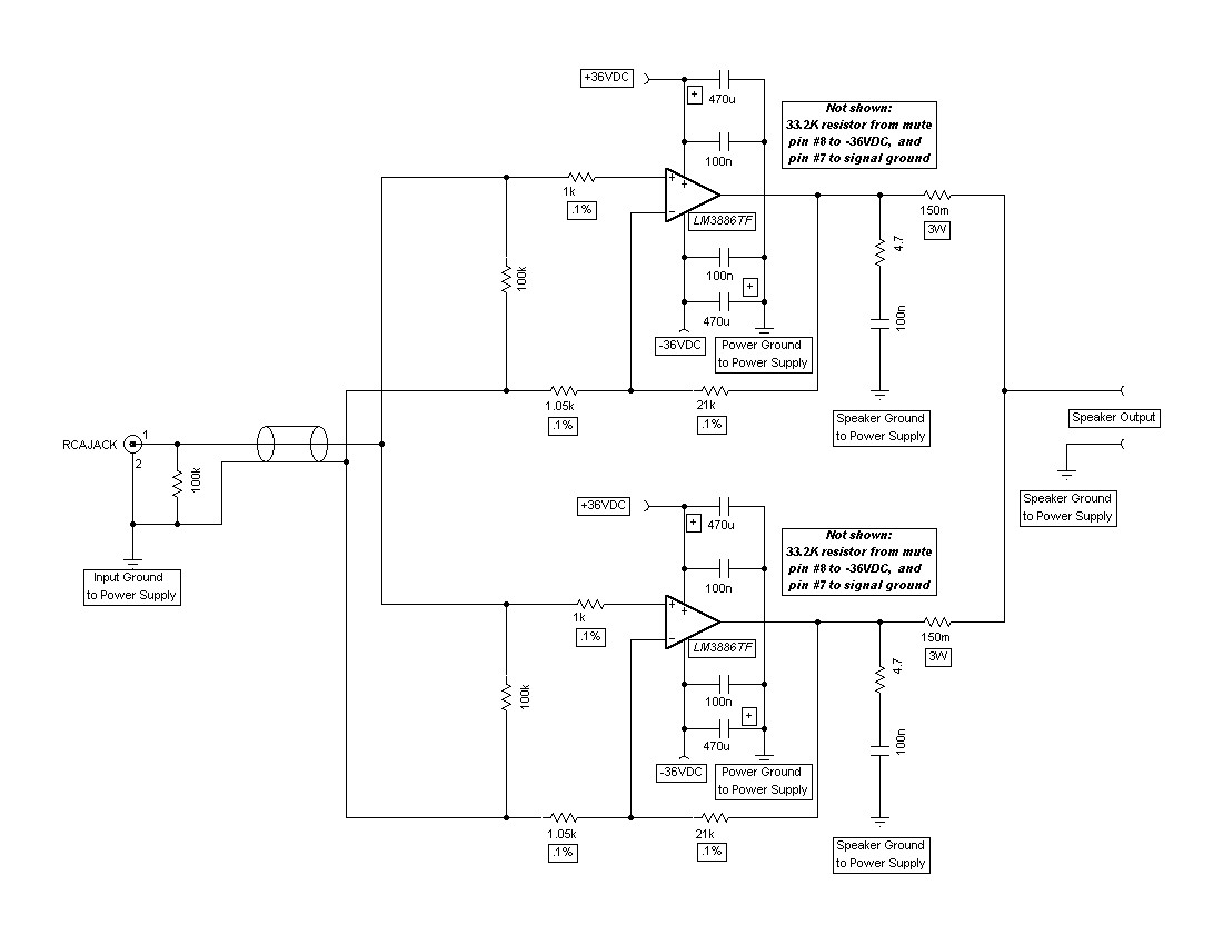

Here's what I use in my system, output balancing resistors to speaker are .15 ohm/3 watt metal oxide. Also note that input and feedback resistors must be matched to at least .1% or better to keep off-set voltages low, I bought 10 of each and measured for best match, absolute value isn't important.

I should also add, because I didn't use DC bloking cap for feed back network, that the relative values for all of the precision resistors is important. So in this design, the resitance seen at inverting and non-inverting inputs of chip equal 1k ohm, but agian, absloute value can be whatever you want (within reason), just keep relative values matched and input resistance equal.

On my schematic the input resistor is the 1k, and the feed back network consists of the 1.05k and the 21k resistors. By Norton's theorem, the feedback resistors are fuctionally in parallel, so are equal to a single 1k resistor. Therefore, both inverting and non-inverting inputs see the same resistance.
Here's how it all works. First, all amplifiers using an OpAmp topology will have a DC offset (or non-zero) voltage at the output which is determined by the chips'(or OpAmp built with discrete components) inherent input bias current and voltage, the resistance difference seen at the inverting and non-inverting inputs, and the amount of gain of the amp circuit. The LM4780 (dual version of the LM3886) has an inherent offset of 10 milivolts maximum, and an input bias current of 1 microamp maximum. If the inputs have different resistances at the inputs, there will be different currents into each input, which causes slightly different voltages at each input that is amplified by the gain of the amp. So to keep offset low, resistance seen at both inputs should be the same, or as close as possible. Generally speaking, it's good to keep output offset under 100 milivolts, many believe it should be less. The DC blocking cap I referred to would be between the 1.05k resistor and ground, and creates a high pass filter function which would cause the amp to have unity gain for frequencies below the corner frequency. So to keep the corner frequency as low as possible, either the feedback network has to have a high resistance or the cap has to be really big, that's why I prefer to leave it out of amps that will be driving woofers. And one more thing, you might not get an accurate resistance measurment if the resistors are in-circuit, it's better to lift one lead before measuring.

No damage to the amplifiers per say, but it's best to keep offset as low as possible or you'll have power loss and additional heating of amp chip, and you get excessive power dissipation in the current balancing resistors on the outputs(the .15 ohm ones). For example, lets assume that there is 100 milivolts of positive offset voltage at both amp outputs. In that case, the offsets are equal and cancel out, there won't be any current flow from one amp output to the other, and power dissipation in output resistors is minimal, almost all of the power is delivered to the speaker, but it will still cause power loss and chip heating as I stated before. But if one amp has 100 milivols positive and the other 100 milivols negative for a difference of 200 milivolts, you'll end up dissapating more power in the resistors and the amp outputs, and deliver less power to the speaker, and agian, more power loss and chip heating. But even worse, and this is why I don't use the DC blocking cap for the feedback network, if the caps aren't very well matched, you'll get another source of offset that is much harder to correct. Remember I mentioned needing a high value cap in the feedback network in my pevious post? well a high value cap will usually mean an electrolytic type, and those are notorious for having loose tolerance and value drifting with use and/or aging. Please understand, that none of this is etched in stone, there is no such thing as a "perfect" amp design that works in all cases. That's why it's necessary to figure out what your design goals are, and what compromises(there are always copromises) will have the least impact on the final results. If you want to try it, I recommend checking the amp outputs for for offset before putting in the current balancing resistors. And once everything seems OK, put in the resistors and test with a dummy load, like a high wattage 8 ohm resistor, or if you don't have or can't get a dummy load, use a speaker you're not afraid to sacrifice if something goes wrong.

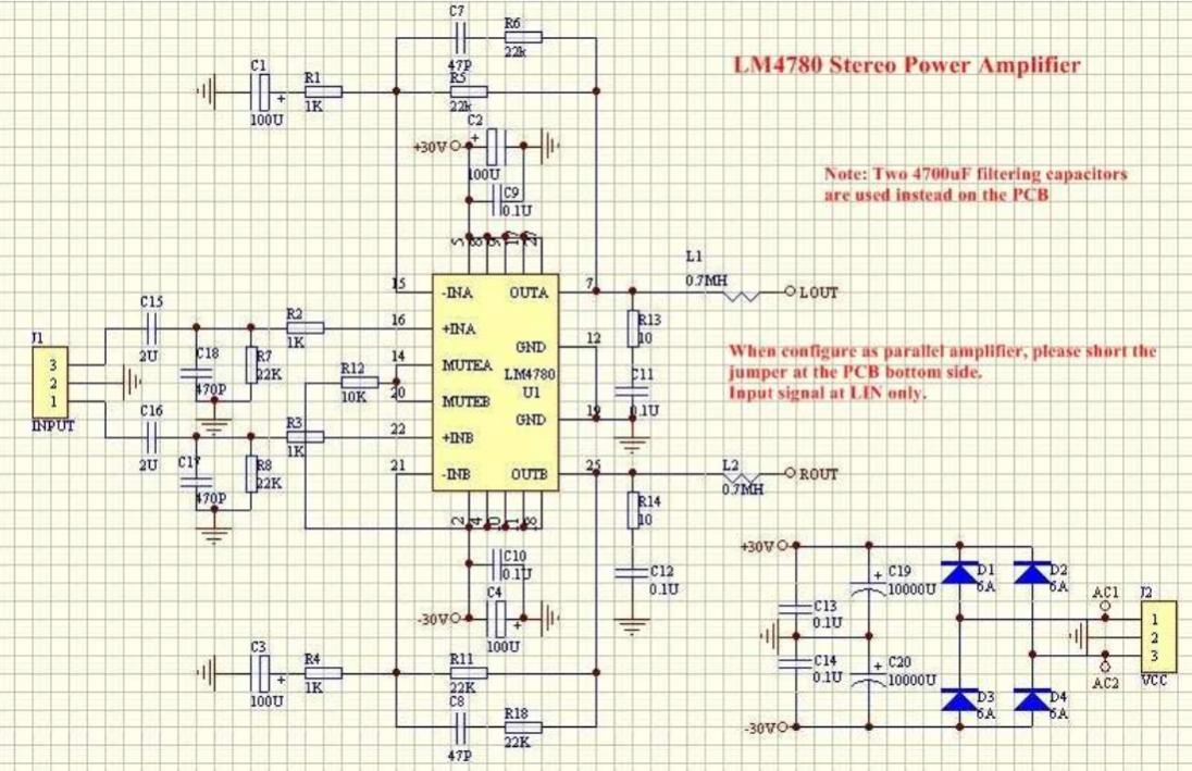

Thanks. Suprisingly, Jim's Audio sent me the schematic. On the schematic, it is written: When configured as a parallel amplifier, the jumper on the bottom side of the PCB should be jumpered. Input should be from Left In only....So perhaps I am supposed to jumper the other two pads by the input?
I soldered the coupling cap to Right In. but I did run a jumper wire connecting the two channels. Does that coupling cap have to be moved to left channel for some reason?

I attached the Jim's Audio schematic...I jumpered the 7uH inductors. I guess I'll have to be removing them.

It dosen't look like it should matter which input you choose, as long as all of the related components for that channel are in place, the jumper connects the two inputs together at the junctions of the 1k and 22k resistors. I definitly wouldn't recommend using .5ohm resistors, it would adversly affect the output damping. Normally .1ohm is recommended, but I used .15ohm because it's what I had on hand, certainly keep them under .2ohms for best results.
