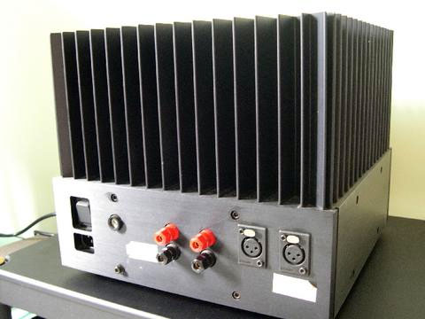

U formed shortie plug , pushed in 1 & 3 holes in XLR
or decent quality XLR jack , with soldered bridge wire between pins 1 & 3
then RCA input will work
for my knowledge , Aleph 0 doesn't have that switch
I made a mistake in previous post , assuming that Aleph is having both RCA and XLR input connectors ; in fact , amp is having just XLRs , so all you need to feed it properly from unbalanced source is to make RCA-XLR interconnect , with XLR pins 1 and 3 joined/shorted
then check the switch : with switch closed , there must be short between XLR pins 1 & 3
open the amp , and check what's written on pcb - REV 1.?
Earlier units came with external RCA adaptors. Later on, switches.
Grounds #3 input just like ZM sez.
