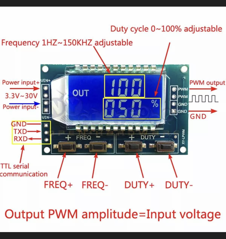

I'm trying to build a standalone tone generator- amp - speaker device.
I'm using the following:
1) PWM Pulse Signal Generator from ebay.
2) TPA3110 XH-A232 30W+30W Class D mini amp.
3) Tectonic HIBM65C20F-8 full range (up to 20khz) 8ohm speaker.
4) Variable DC power supply.
5) various fixed carbon resistors
What I get out of the speaker is clicking sound, along with the pwm frequency sound.
and also when turning the amp on, for first 3 seconds there is am-radio-like distortion.
I'm supplying 14V to both
since the amp can operate in 8V-26V DC range,
and PWM generator in 3.3 - 30V.
I dont have a potentiometer currently, so i tried 10k, and 20k resistor between pwm generator and amp input, in series on the "+" terminal.

correction:
below 13.1khz there is sound of PWM frequency along with am-radio-like distortion that seems like its rising in pitch.
13.1khz and above there is just clicking sound, a click every half-second

Is the variable DC power supply switchmode? What switching frequency?
"PWM Pulse Signal Generator from ebay." - can you identify this please?

This is the pwm generator:
Signal Generator PWM Pulse Frequency Duty Cycle Adjustable Module LCD Display | eBay
